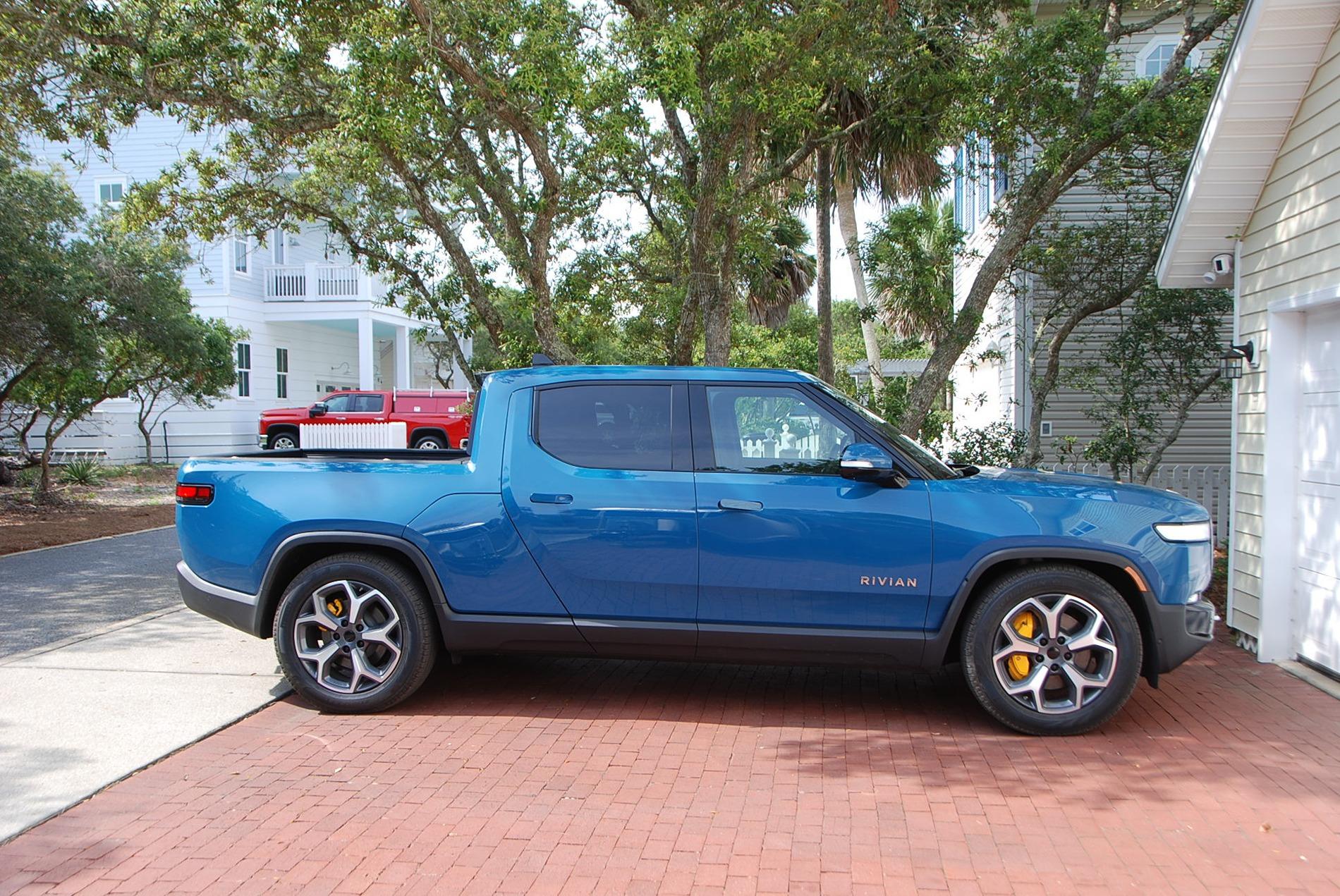

We have had our Dear Opal (our R1T) for a little over a year and a half now. Other than our return trip to Florida from the Rivian Factory, we had always charged Opal to 70%. In August of this year, Opal had her 12 volt battery replaced by Rivian Mobile Service. The mobile technician, who was very experienced (11 years with Tesla), told us that it is a good idea to occasionally charge the vehicle to 100% for the battery's good health. Since his visit, we have been varying Opal's charge level. We drive Opal daily, and usually charge her every five or six days. We have been charging her from 60% to 100%. We DO NOT leave her plugged in to the Rivian Wall Charger when not actually charging.
Opal's charging routine is based upon all of the information that we have gleaned from multiple sources. since we began our journey into EVdom.
