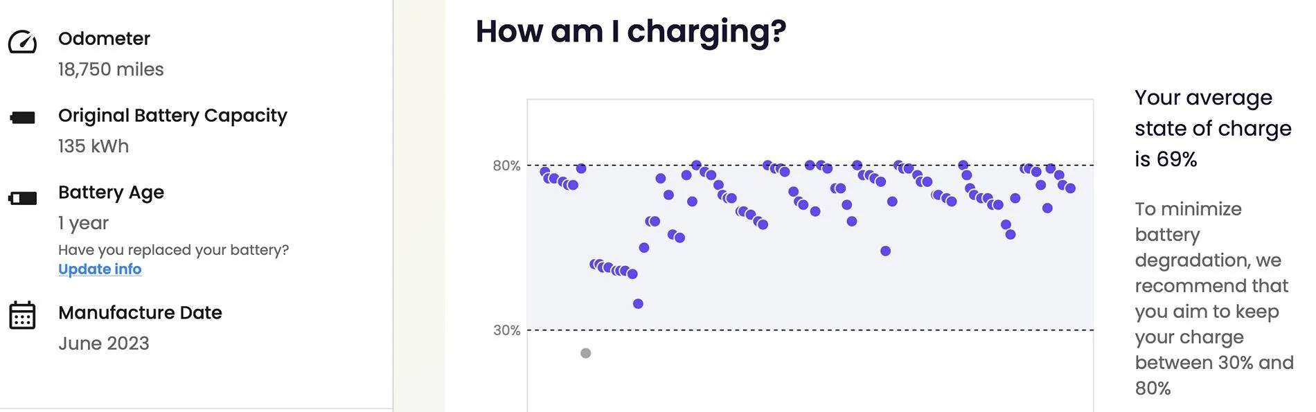

You can sign up to Recurrent,com and get a monthly report of your vehicle, like the image below for our R1S. It shows SOC at various times of the day and drives.
