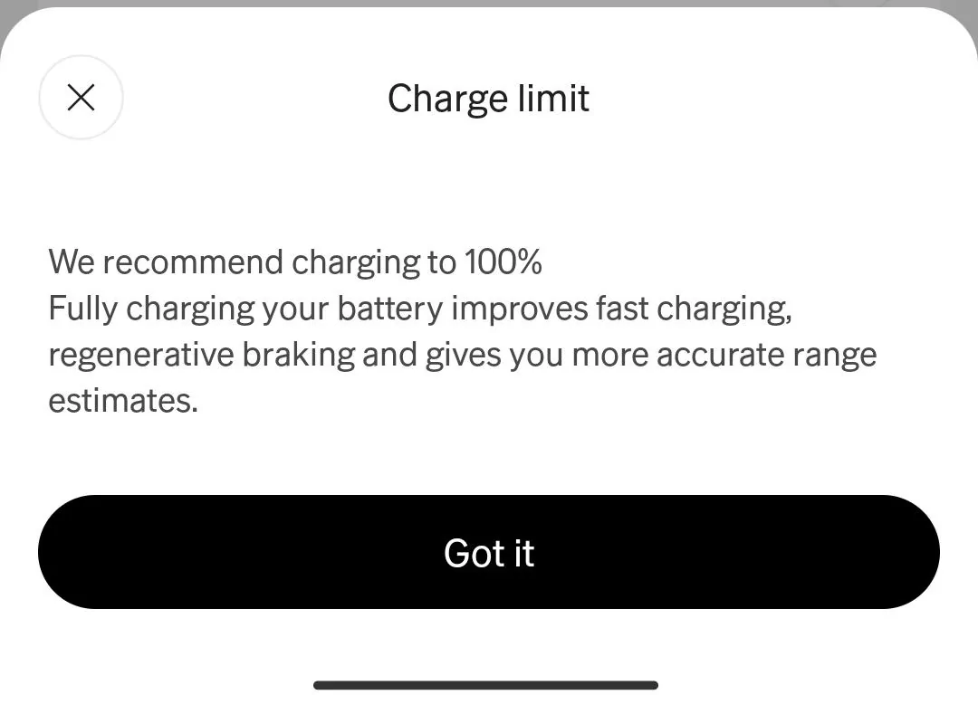

Not directly related to OP's question, but Rivian actually recommends 100% for LFP/Standard. I don't quite understand how that's beneficial for regenerative braking, since from Large pack my experience is that high SOC limits the amount of regeneration. Does anyone know why Rivian recommends this? Also does anyone know whether long term battery life/longevity/health for LFP actually benefits from 100% charging? If not, I'd rather prefer to limit it to something like 70% for daily use.

LFP needs to be charged to 100% occasionally to calibrate software parameters—for accuracy of range estimation. There’s been much oversimplification when reality is more nuanced than good/bad. It’s good/bad pending other factors. And some have already been mentioned. Regen is a form of charging. When the pack is near full, it’s more resistant to accept charge. That is why regen is limited. Also why Rivian added brake blending to assist with slowing/stopping whenever conditions call for limited regen.
If Rivian used the word "occasionally" I'd have been perfectly fine with it. However they don't, and recommend charging to 100% period, and claim that this benefits regenerative braking, which seems odd.

Occasionally charging to 100% on LFP batteries balances the cells better. The voltage curve is flatter on LFP so the BMS has a harder time with cell balancing. If the cells aren’t balanced well, the voltage the BMS sees isn’t the true voltage of each cell which can effect regen and of course the other items listed.

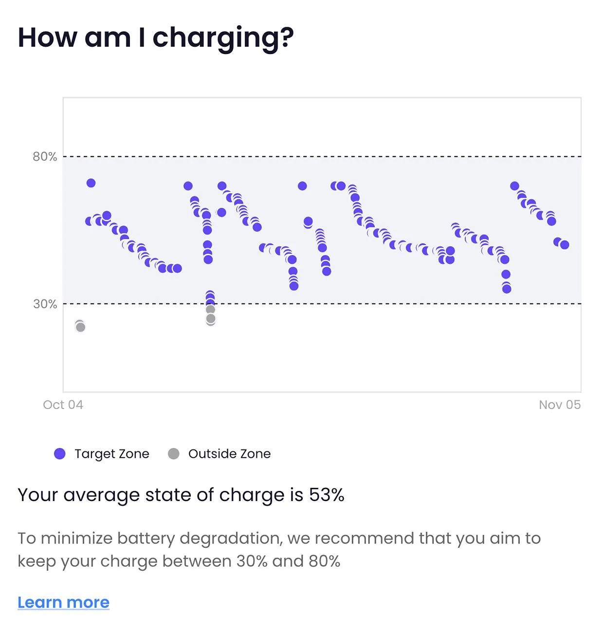

Just keep in mind that 50% is the most "balanced" for a lithium ion battery and the extremes (0% or 100%) are the least balanced, which over time will cause more wear and tear.
For daily driving: charge to 70% then drive down to 30% then recharge again. For the large pack, that's pretty easy to do because it's basically charging to 200 miles range then driving to 100 miles range.
I also use Recurrent, which is free. Here's my charging history.
Last piece of advice: Don't worry about charging to 100 when you need it. When I bought my first EV, I was too worried about keeping balanced charge levels that I made life more complicated than it needed to be. If you need the range, charge up. Your truck has a sophisticated battery management system so you'll be fine!
