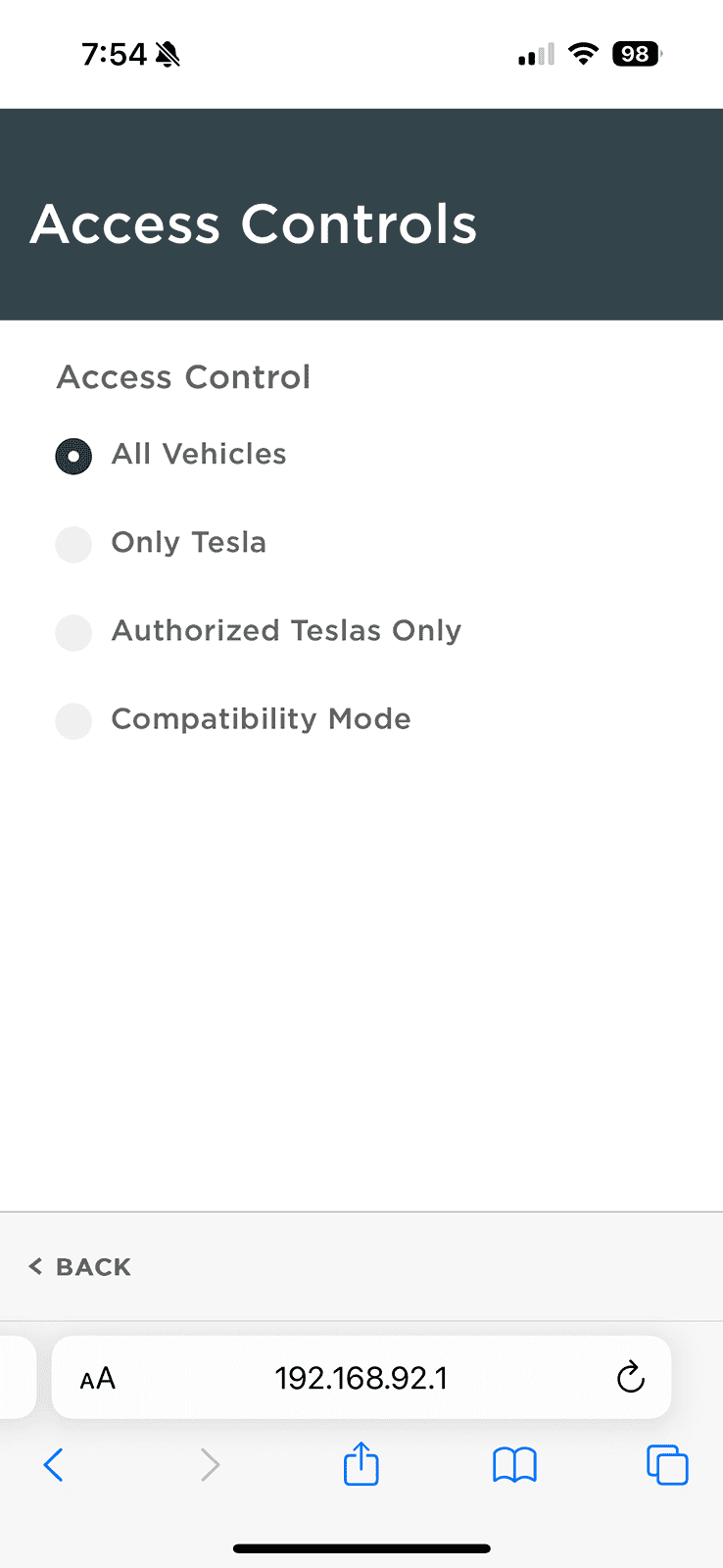

Thank you for this information. I did access the interface and it is set to all vehicles. Software is the latest version but I am having the same issue.

UPDATE: I attempted a charge with a TeslaTap adapter and it failed also. I checked the Tesla Wall Connector interface and it says there is an internal fault, switch off breaker and if it persists, call Tesla. After the issue persisted, I contacted Tesla support; they ran their own signal check and immediately concluded that the Gen 3 Wall Connector will be replaced. I received an email with instructions on how to install it once it arrives.
