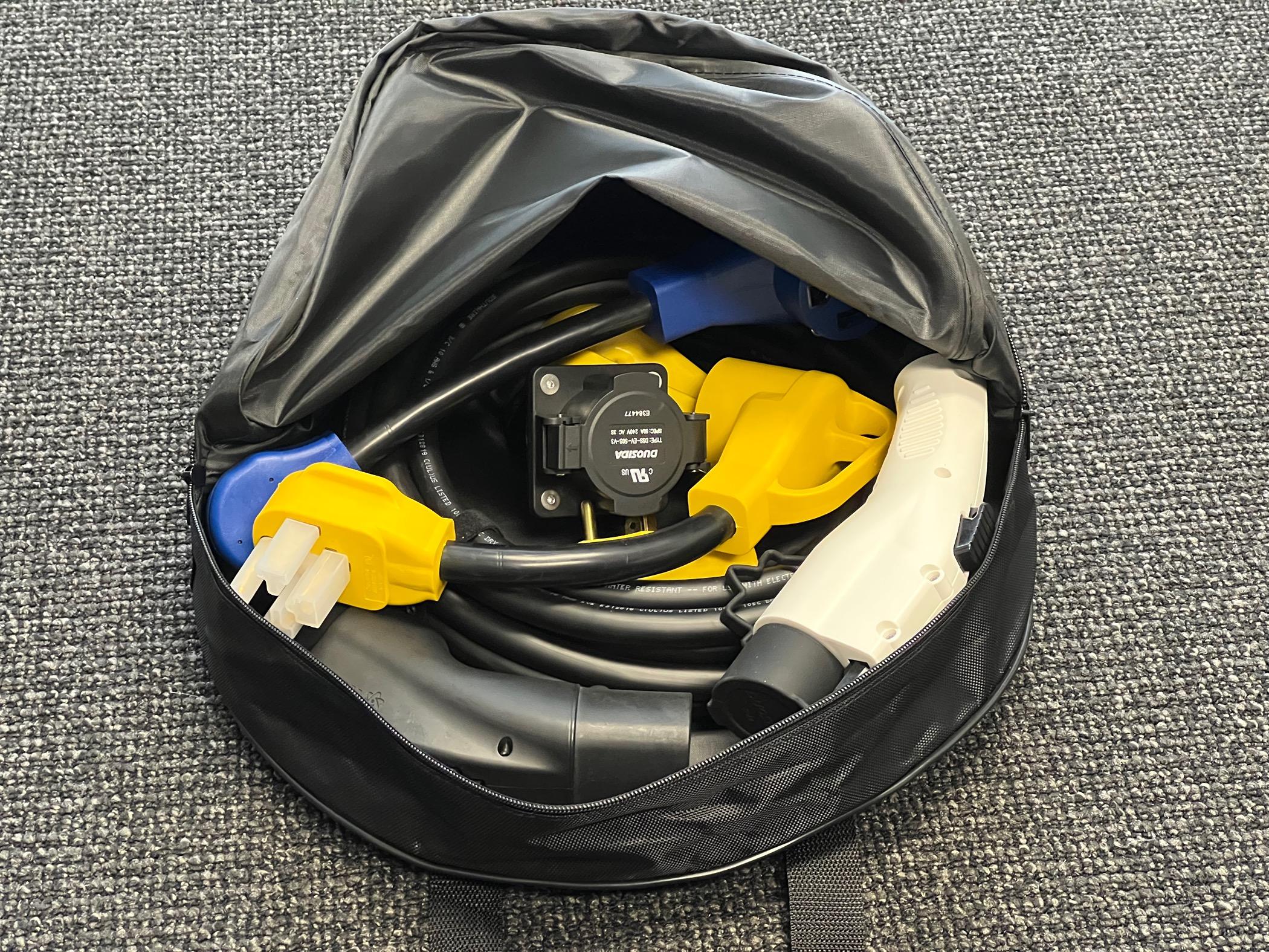

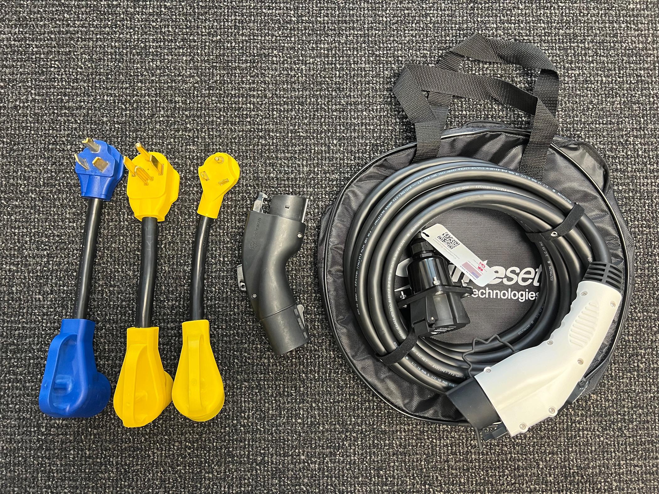

So, here's my kit, slightly different than what the trend is in this feed, but has a few advantages in unique scenarios I've encountered;
- Full Rivian Charging kit, 120v and 240v included plug adaptors of course.
- If I'm REALLY concerned, I already own a 15' NEMA 14-50 extension cord, but usually leave that at home
Pictured are my accessories;
TT-30P to 14-50R 120V 30 Amp adaptor - allows connection to 30a RV outlets and some welder connections.
NEMA 10-30P to NEMA 14-50R Adapter - allows connection to older dryer 3-prong outlets.
NEMA 14-30P to 14-50R EV Charger Adapter - allows connection to modern dryer 3-prong outlets.
- Lectron Tesla to J-1772 adaptor - Had this guy for a few years. It's a lifesaver when the only thing around is a hardwired Tesla home or destination charger. If you have a J-1772 port on your EV, you should own one of these.
- Inteset 30ft 40amp J1772 EV Extension Cord - This is my secret sauce. It's a 30' J-1772 extension cable. This allows me to get nearly any length I need to charge. It also usually allows me to keep the Rivian portable charger out of the elements (hence cleanish). Even better, if I'm on the road and get ICE'd out at L1 or L2 chargers, I can still charge from a different parking spot. It also works with the Lectron adaptor for Tesla destination charges when ICE'd. Also if I need an extension of any L1/L2 charger, I'm covered. It's lightweight, came with a decent-duty bag that easily fits all of the above accessories inside.
So, that's my twist on my AirBNB and roadtrip charging kit. :)

Does 30' extension cable passes through interrupt signal when you press release latch?
Well, the extension cable we are taking about here is just a normal cord that runs between the mobile charger and the wall so it is just as "dumb" as wiring in a wall would be from a Electrical panel, etc. The signal your talking about would be between the Rivian and the mobile charger "box"
I was referring to extension cord that runs between Rivan and another J1772 connector, as shown in pictures( Inteset 30ft 40amp J1772 EV Extension Cord ). From my understanding, pressing the button on plug sends signal to charger to stop charging to prevent sparking when unplugging it.
If it is "dumb", I would be worried accidentally unplugging it while charging and potentially damaging plug and receptacle on Rivian
Oh! Sorry. I didn't notice the quote was to the other kit posted and not the original kit on the thread. haha. It must send that you would think right? I see it doesn't say in the reviews though.
No worries ;)
It doesn't help that we all have Rivian as our profile pic lol
Well it has operated exactly as the normal J-1772 connector would for the last four days at the AirBNB I am currently staying at. I have my adaptors plugged in to a 3-port dryer outlet, into the Rivian charger, out across my 30’ J-1772 extension. Each time I have unplugged during a charge directly from my R1T port (in the rain, yay Oregon coast spring break weather) things have disengaged and shut down exactly as I would expect. Just like my hardwired 60a charger at home, same as any other L1/L2 chargers anywhere.
The extender carries the same communication and charge conductors as the regular J-1772 charge plug… locks the same when the vehicle is locked and behaves the same. While I don’t have an EXACT technical answer to your question, my real world use response would be, YES. ;)

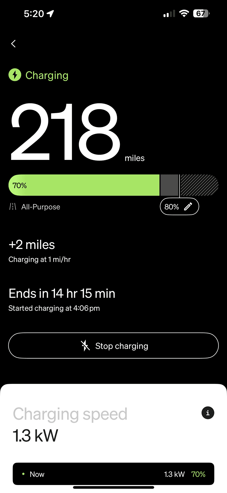

Rivian R1T R1S My Airbnb charging kit IMG_6170
That’s a good idea. I’m leaving Monday and will have enough juice by the time I need to leave. The 1 mile per hour ?makes me laugh.
I'm working on combining your list with the additional items others have mentioned here. I'm walking around with a yardstick (yes, no tape measures to be found) and realizing how short 30 feet is.
