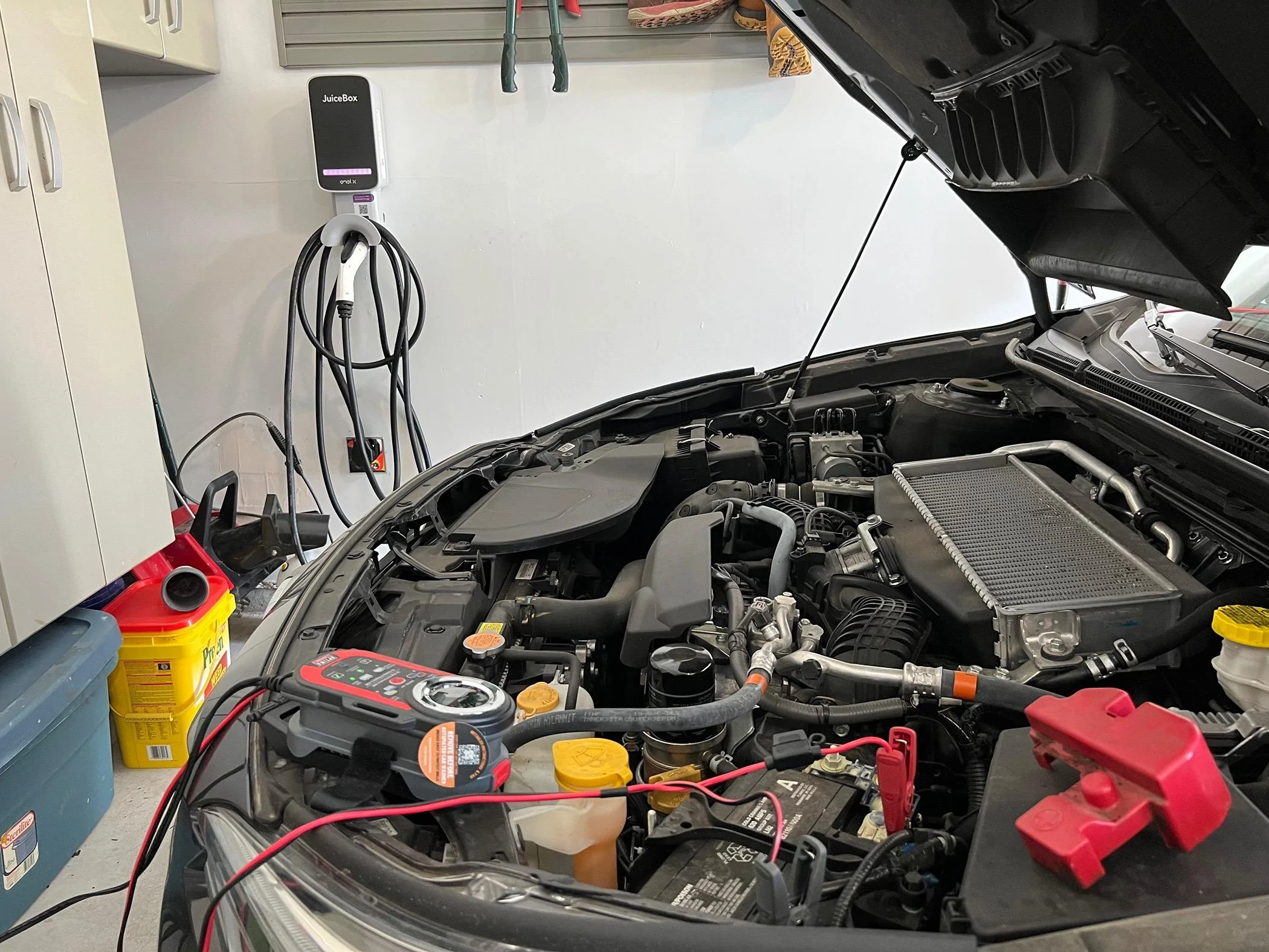

And the two week rule* wins again!
Just when I thought my need for the J1772 extension cable would be rare if at all, ?
My son bought a neighbor’s Outback and parked it in the garage while I was washing my R1. The next morning, it wouldn’t start. Apparently Outbacks have a vampire drain issue related to their Starlink (or on-star or whatever) system.
And guess where my L2 charger is located?
Rivian R1T R1S My Airbnb charging kit IMG_6230
The J1772 cable would have been useful today.
*Two week rule = two weeks after you make a choice based on an assumption, your assumption is proved wrong.
