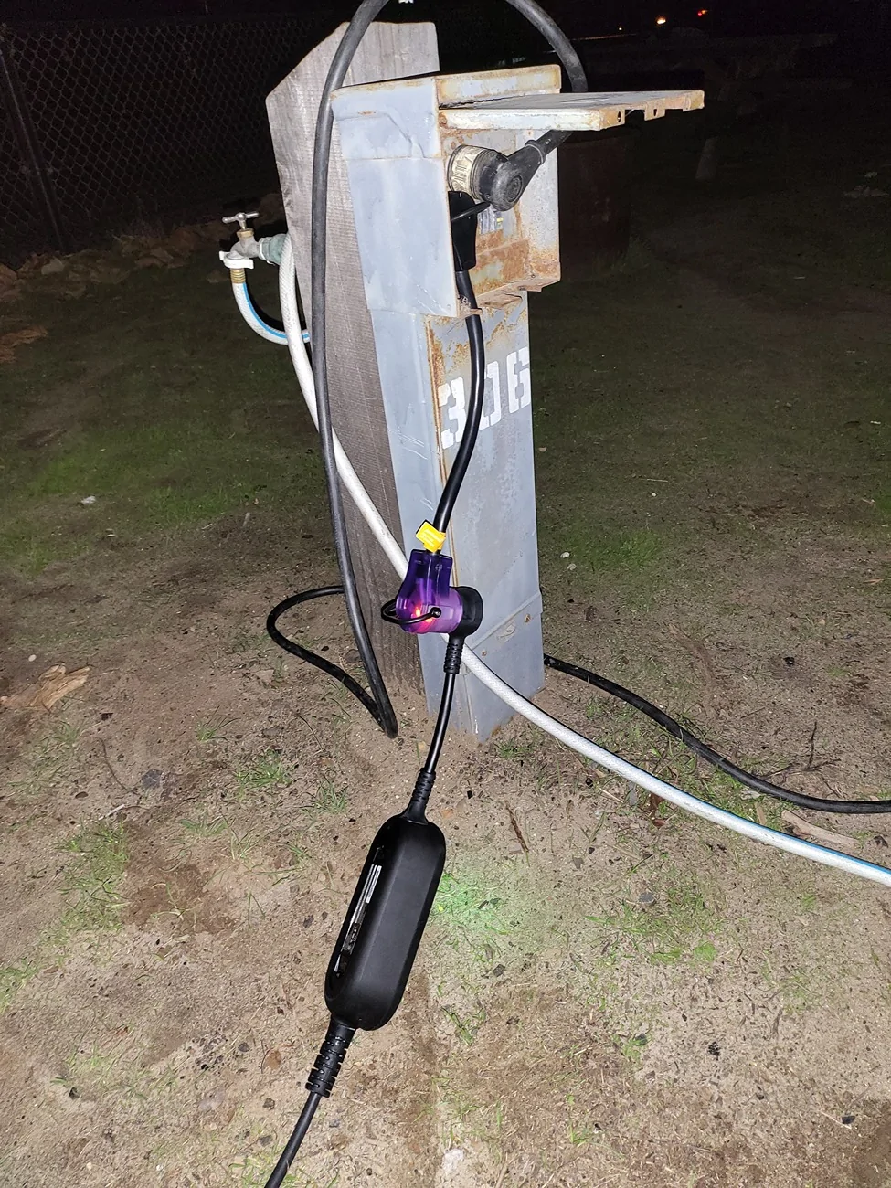

Can you explain the transformer setup? If you bump the voltage from 120V to 240V, how does that help you increase charging speed when the 120V supply is limited to 12 Amps?
You've made some incorrect assumptions here. An EVSE with a 14-50 plug connected to a TT-30 recep with an adapter can charge at 24a, which is 2880w. I've run mine at 26a without an issue from my generator.

Oh, I get it. It is 120V and 30 Amps, not 15. Hence the title of the thread. Doh.

A common confusion point is that an EVSE with a NEMA 15P (common household plug) either permanently attached or with a pigtail, will reduce itself to 12a automatically. You could in theory run across a NEMA 5-50R somewhere and use the full 40a from that, at 120v, with a 14-50 pigtail and an adapter.
