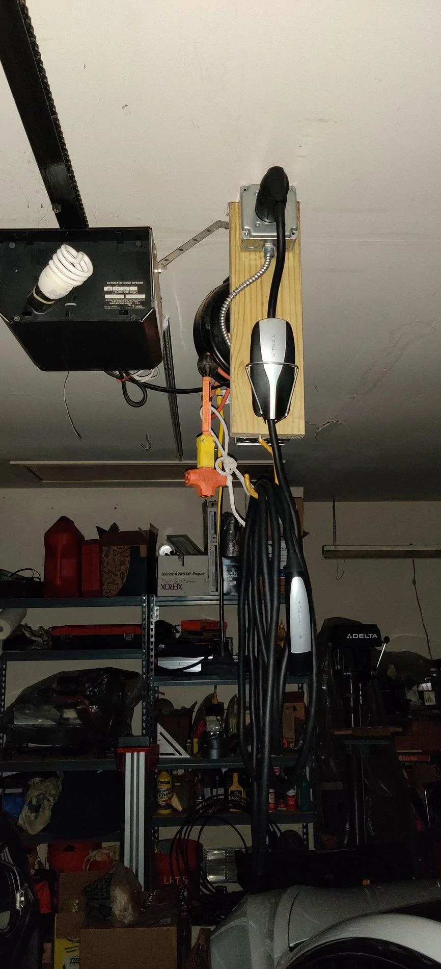

Bringing this thread back from the dead as I can't find anything related to ceiling mounting the charger on the forum. I'm thinking I'll be ceiling mounting so I don't put one more thing on my walls that I'll routinely run into. I can easily run a 220v anywhere in the garage as my panel is right there in the garage as well, but I'm seeing some mentions about the cable lengths on these chargers being fairly long so maybe I could mount in an area that I won't run into it and just loop the cable across the ceiling so it's right above where the charge port will be on the truck. Anyone seen spec's on the charger as to how long the cable is with the Wall Charger that we purchase?
I'd wall mount it then use a pantograph/cable retractor to support it at the ceiling. Pull down, plug in.
