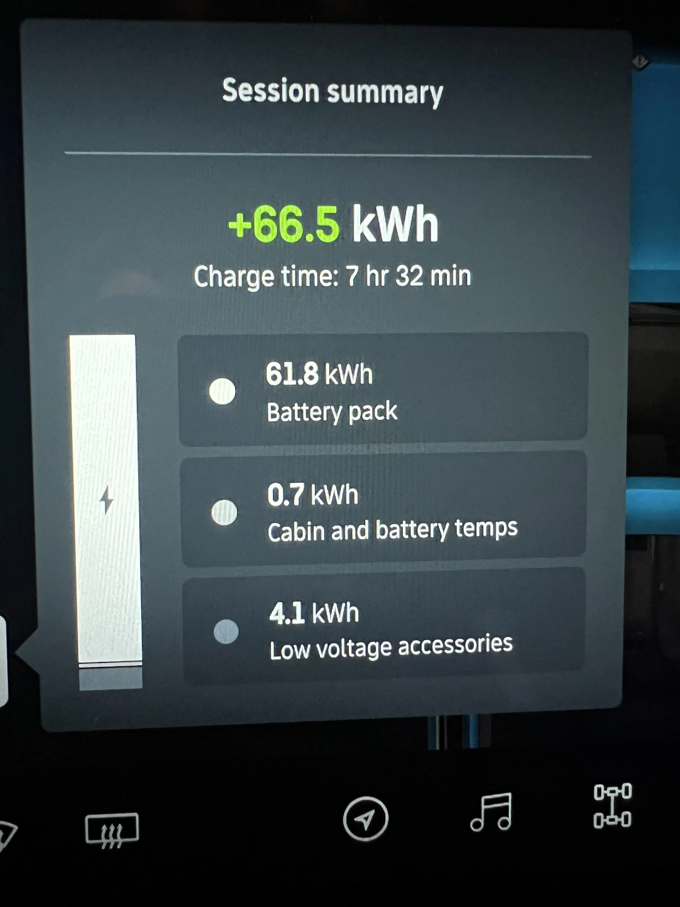

Home EVSE into battery efficiency: I charge at home with a Changepoint Home Flex, which reports Kw/h delivered per charging session. I charge at night in a closed garage, proximity key on, stays unlocked at home., no gear guard. It is hot in Texas even in the evenings.
My EVSE reports steady 11.5 kw output while charging. I'm usually going from ~40% to 70%. I did not include any data where the EVSE reported a second "top off" charging bump.
% loss = ((delivered kw/h as reported by the EVSE) [MINUS] (Kw/h into the battery per R1T))
[DIVIDED BY] (delivered kw/h as reported by the EVSE)
Assuming the EVSE & R1T are reporting accurate data, this should be the total charging loss.
In the last 10 days, I've had six charging sessions:
8/20 13% loss on EVSE delivery of 46.3 kw/h
8/21 12% loss on 32.4 kw/h
8/22 11.4% loss on 32.2 kw/h
8/24 11.8% loss on 43.2 kw/h
8/26 12% loss on 46.8 kw/h
8/28 12% loss on 57.5 kw/h
That is a 12% average loss or
88% of the kw/h I pay for make it into the battery or
I buy 1.136 kw/h to get 1 kw/h into the battery
So when I see my R1T telling me 50 kw/h added during a charging session, I take 50 x 1.136= 56.8 and that is how many Kw/h I paid for to get that charge.
YMMV, just wanted to share my info.
Arnie1
Arnie
Apr 18, 2022
108
38
Wesley Chapel, FL
2023 Rivian R1S Quad
Consulting Engineer
I have proximity key disabled. This is my charge session last night, very typical in my experience.
is it possible to turn off cabin cooling at rest?
Other than battery cooling, gear guard motion detect, and cabin cooling what other vampires are using 10-20%?
