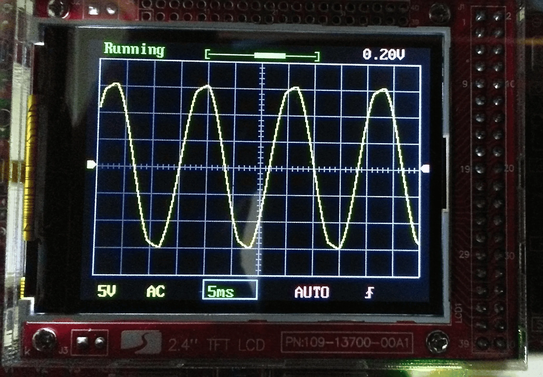

Below is the waveform from my little 2,000 watt inverter generator under full load, it's as clean as what I get from my power utility co.
As mentioned previousy, a basic oscilloscope won't show the harmonics. But wait, there's more. The oscilloscope is showing the voltage waveform. But there's also a current waveform. In a conventional generator, the current waveform can be distorted while the voltage waveform looks fine. And it's th

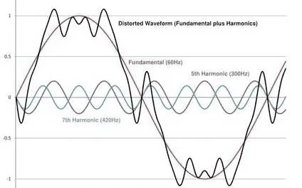

The waveform matters to the rectifier (typically MOSFETs) because a waveform with THD can cause the MOSFET to conduct and/or switch on/off beyond it's intended design limits, which usually causes overheating and destruction of the MOSFET.
In the AC waveform below, it shows 5th and 7th order harmonics contributing to the distortion. In the real world, there can be additional harmonic orders. The harmonics create the resulting complex waveform, potentially causing the rectifier/MOSFET to operate at a greater duty cycle or peak voltage than designed, and overheat. For example, on a normal waveform, the MOSFET switches on/off once per cycle. In the complex waveform, it could on/off times per cycle if designed to switch at 75%.

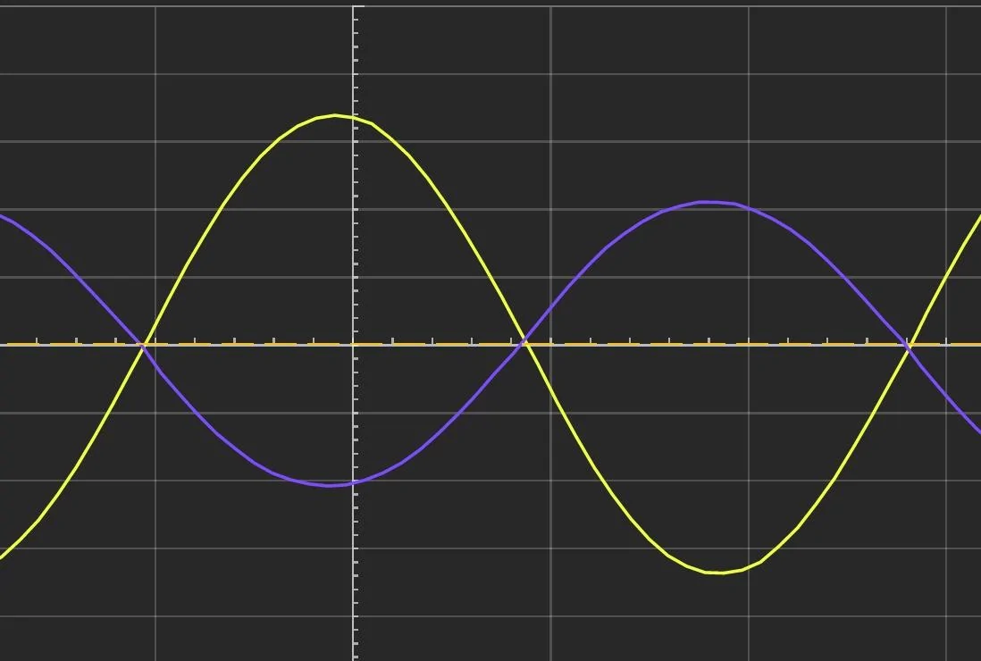

. For a linear load the current follows the voltage. The thing is that most modern power supplies are switchers - not linear. This leads to high harmonic content in the drawn current. I wonder if your concerns have been misplaced from this. High line current harmonics are detrimental to the distribution system (some of the harmonics are negative sequence for example). Equipment to be installed in many facilities is required to meet current harmonic requirements for this reason. The Tesla chargers have filtering in front of the rectifier presumably for this. The following picture shows the voltage and current waveforms for a Tesla charging at 20A. As you can see the current waveform is clean as a whistle:
Was this waveform from a cheap generator as the AC source? Otherwise, it's not relevant to the original discussion - THD from cheap generators vs. inverter generators.
Voltage: 50V.div; Current: 20A/div.
Now please show us one that is not clean?

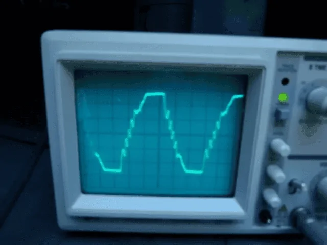

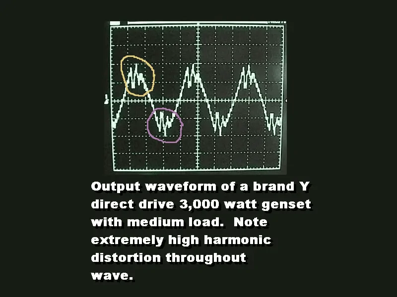

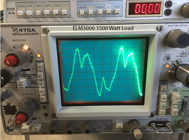

Ot.. but as a PSA.... look at the horrendous voltage waveform output from a standard "non- sine wave" office UPS... You think that's healthy for anything with a microprocessor?
Nowadays, unless you're only planning to run a few incandescent light bulbs or toaster, use an inverter generator and or Sine Wave UPS.

Well I think it may be. First you'll need to know a bit about the architecture of the Tesla charger (as deduced from autopsies posted on YouTube). The input to the charger is passed through a pretty substantial pre-conditioning filter and thence to a bridge rectifier which is thought to be passive but there is debate on this. The DC from the rectifier is then inverted in another bridge the output of which is connected to the primary of an isolation transformer and the secondary of that goes to a second rectifier which feeds the battery. The current to the battery is clearly regulated by changing the PWM duty cycle at the inverter.
The picture was captured with the charging rate throttled back to 20A at which point the PWM waveform duty cycle is clearly relatively low so that the current drawn from the input is very rich in harmonics. But the current drawn from the line is pure as a mountain spring so clearly the input filter has done an excellent job in removing those harmonics (that's what it is there for). My thought is that if it remove harmonics in one direction it will remove them in the other too so that the inut waveform to the rectifier bridge may not be as dirty as you think even with 20% THD sources,
