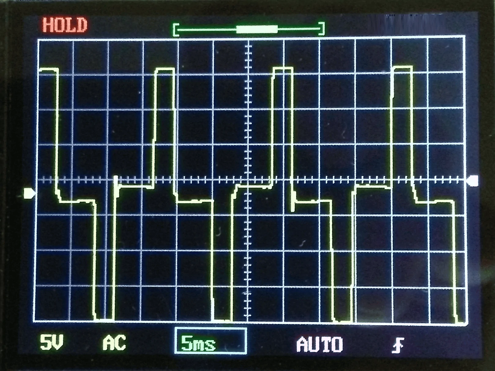

Ot.. but as a PSA.... look at the horrendous voltage waveform output from a standard "non- sine wave" office UPS... You think that's healthy for anything with a microprocessor?
Nowadays, unless you're only planning to run a few incandescent light bulbs or toaster, use an inverter generator and or Sine Wave UPS.

The microprocessor doesn't see this.
Any computer equipment you plug into AC has its own AC->DC power supply that really just cares about charging an input capacitor and firing pulses through a transformer to generate a lower or higher voltage rectified output. You'd be surprised how sloppy of an input wave you'd need before this equipment wouldn't work. Granted some are more tolerant than others, because high efficiency/low cost supplies have naturally less buffer to absorb this mess. The rectifier side of the equipment is pretty simple, diodes are pretty hardy components, though it's hard to tell how well the power factor correction circuitry will work with a non standard wave, likely just leading to lower efficiency.
Your crappy input wave never reaches the output as it's electrically isolated by the transformer (because not doing that eschews that protection and introduces a whole host of other safety problems with an extended ground loop.)

That was true in the old days of simple diode bridges but the argument seems to be that modern power supplies have Power Factor Correction circuits that use active devices and that they won't tolerate harmonics. Now the "modified sine" waveform is an extreme case. I don't see how PFC could work against such a waveform but I am still not sure a PFC equipped power supply would be damaged by one.
Of course it doesn't as that's the most well protected component on the motherboard, but that nasty ass wave will chew up the PSU like nobody's business. That wave was from a 1,000 watt APC brand UPS we were replacing with a Sine Wave UPS. When that old UPS was running modern PC's, you could literally hear the PSU buzzing. It was scary...

If you hear buzzing then there is steel (transformer, inductor) in there. if you listened when on low THD primary power you would hear a hum - not nealy so harsh nor noticeable. Much of the hype re high harmonic content comes from the days when electronics had steel excited at line frequency. Harmonics do not do well in steel (transformers, motors,,,) as they result in heat causing at best losses.
