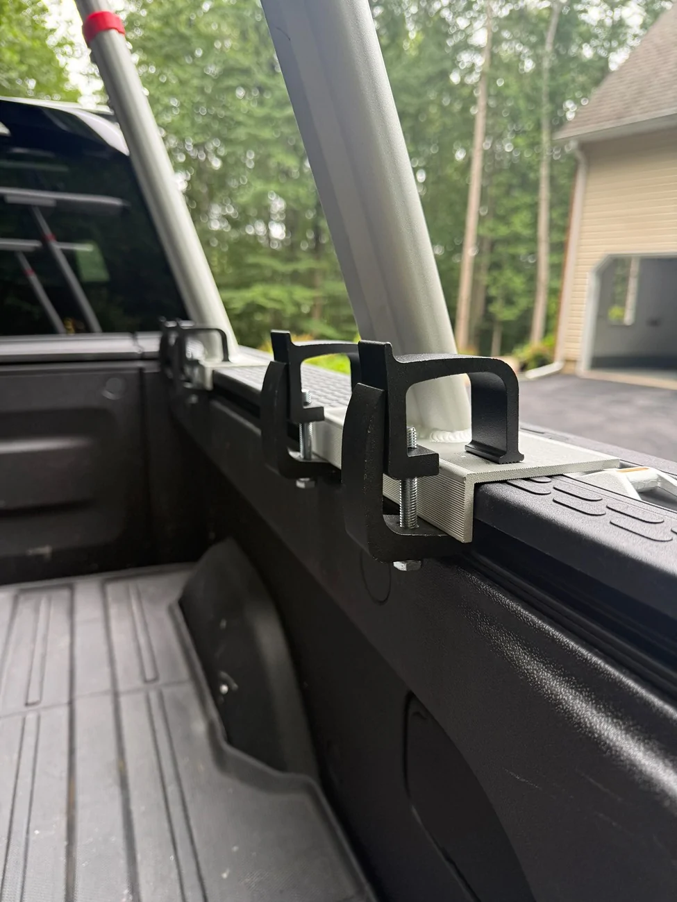

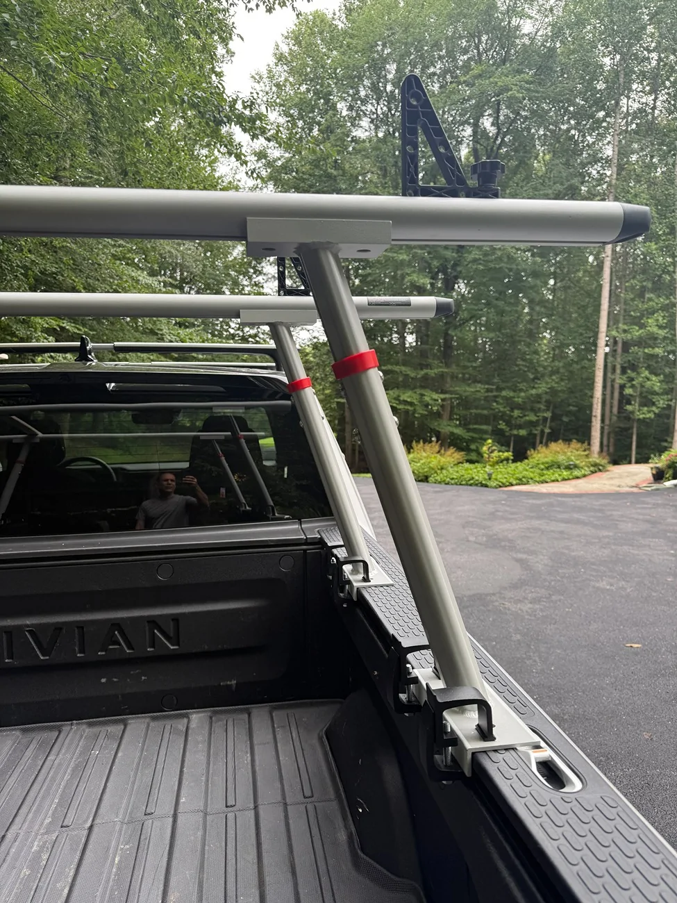

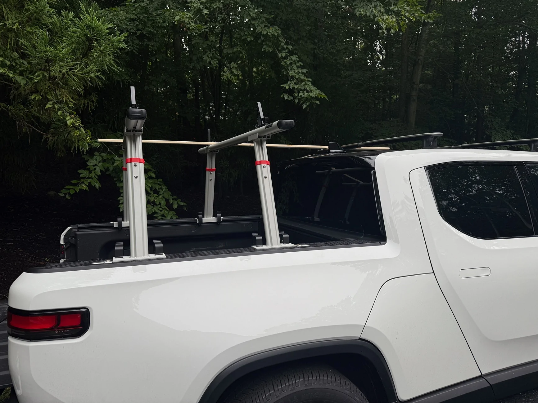

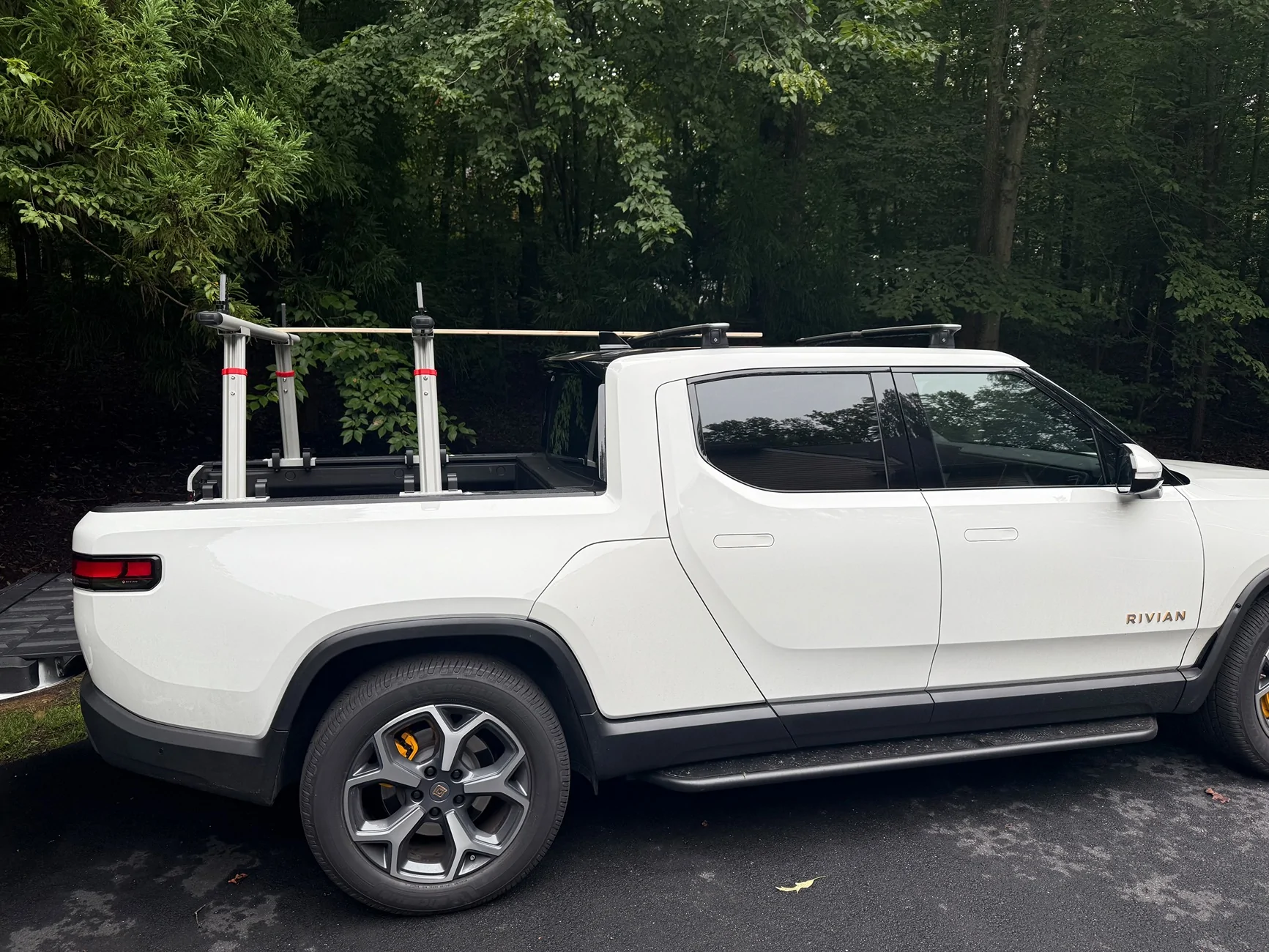

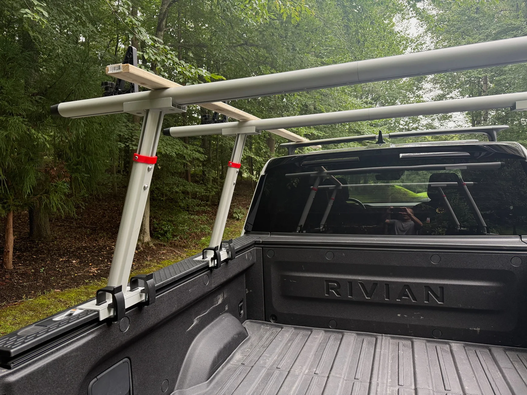

For those of you that use their R1T as a truck and are looking for a cheap rack, here is an option that fits. Not tremendous quality, not the simplest instructions, some tweaks needed to make it fit BUT it will do the job to carry long pieces of lumber and requires no permanent modifications to your truck. I wouldn't trust it with the rated 500-800 pounds but it is sturdy once installed. The key part is to install the C brackets upside down. You will not be able to use your retractable cover and/or use the channels for the cover however, the rack is easily removable once setup and easy to re-install.
Can't beat it for $200!
Bought at Home Depot: Skyhalo Truck Rack 800 lbs capacity 19-34" adjustable height. (I think is made by Vevor)
Internet # 331830930
Model # PKHJLXJB71INCO9JWV0-0718
