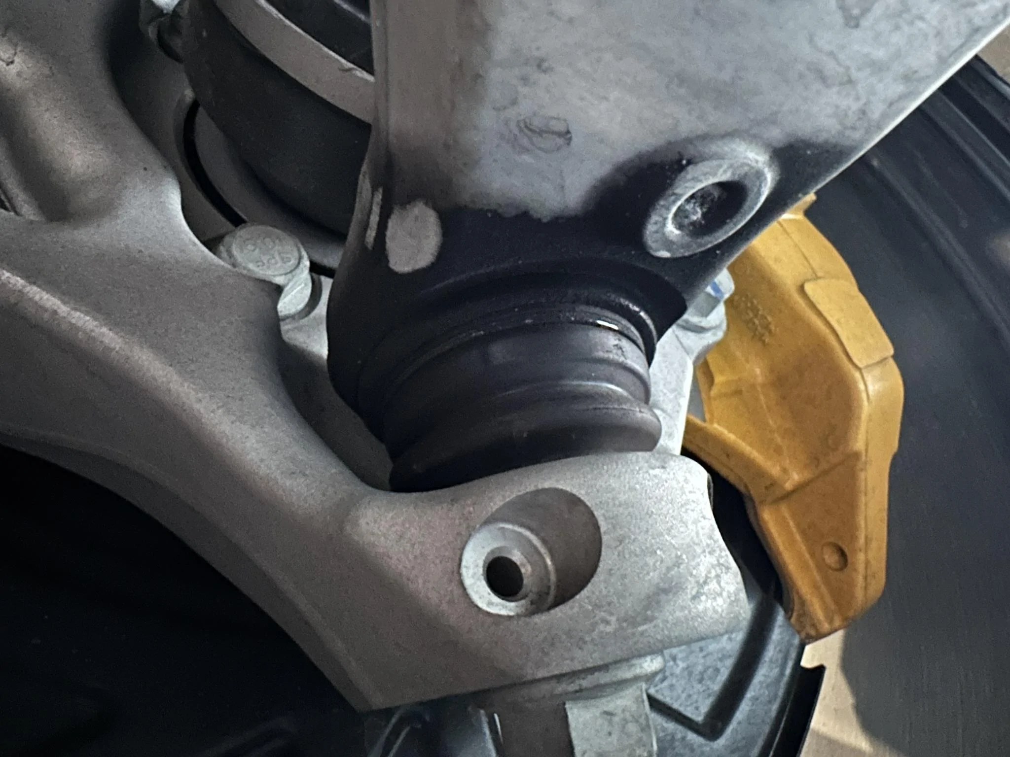

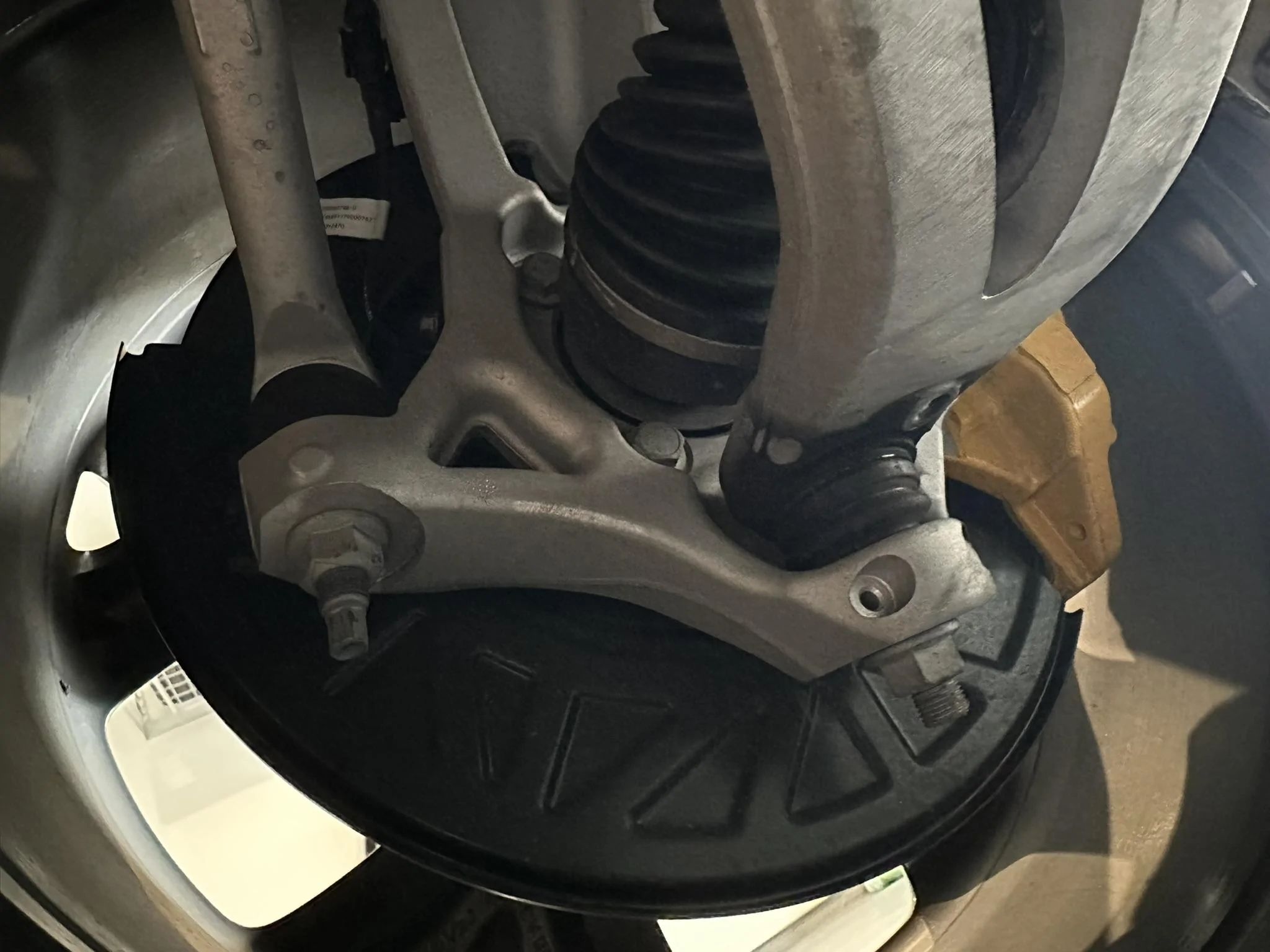

Question for the group, and I will preface all this with the statement that I am not a mechanic or mechanically inclined, just a measly software developer trying to figure out the 'clunk' on my truck...
I jacked up the front end up and checked for play in the half shaft which I could not find any. I did see however what looks like grease leaking from what I am guessing is a bushing on the lower control arm???? (pic below).
All other bushings, and suspension connections are dry as a bone but these on both side are leaking (see the smudge mark). Thoughts? excessive on 3,000 mile truck? could these be bad and the source of the clunk?
Possibly a bad ball joint there. Submit a service request and include the picture. ball joints these days don't have zerk fittings anymore. If the lube is blown out water and corrosion are getting in. Only a matter of time. With a lift and careful application of a large pry bar one can check for play.

I confirmed today, in terms of the clunking sound I have the same problem.
I assume you can view those ball joints without lifting the vehicle?

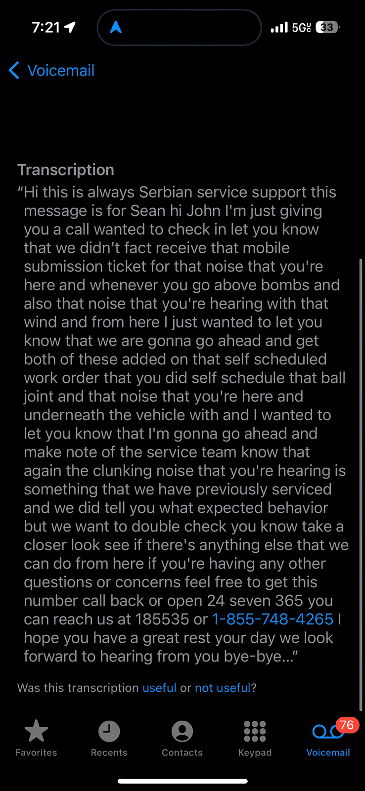

Did you ever take into service? Is it Normal? I just got a call back on the ticket I submitted, does not sound promising;
