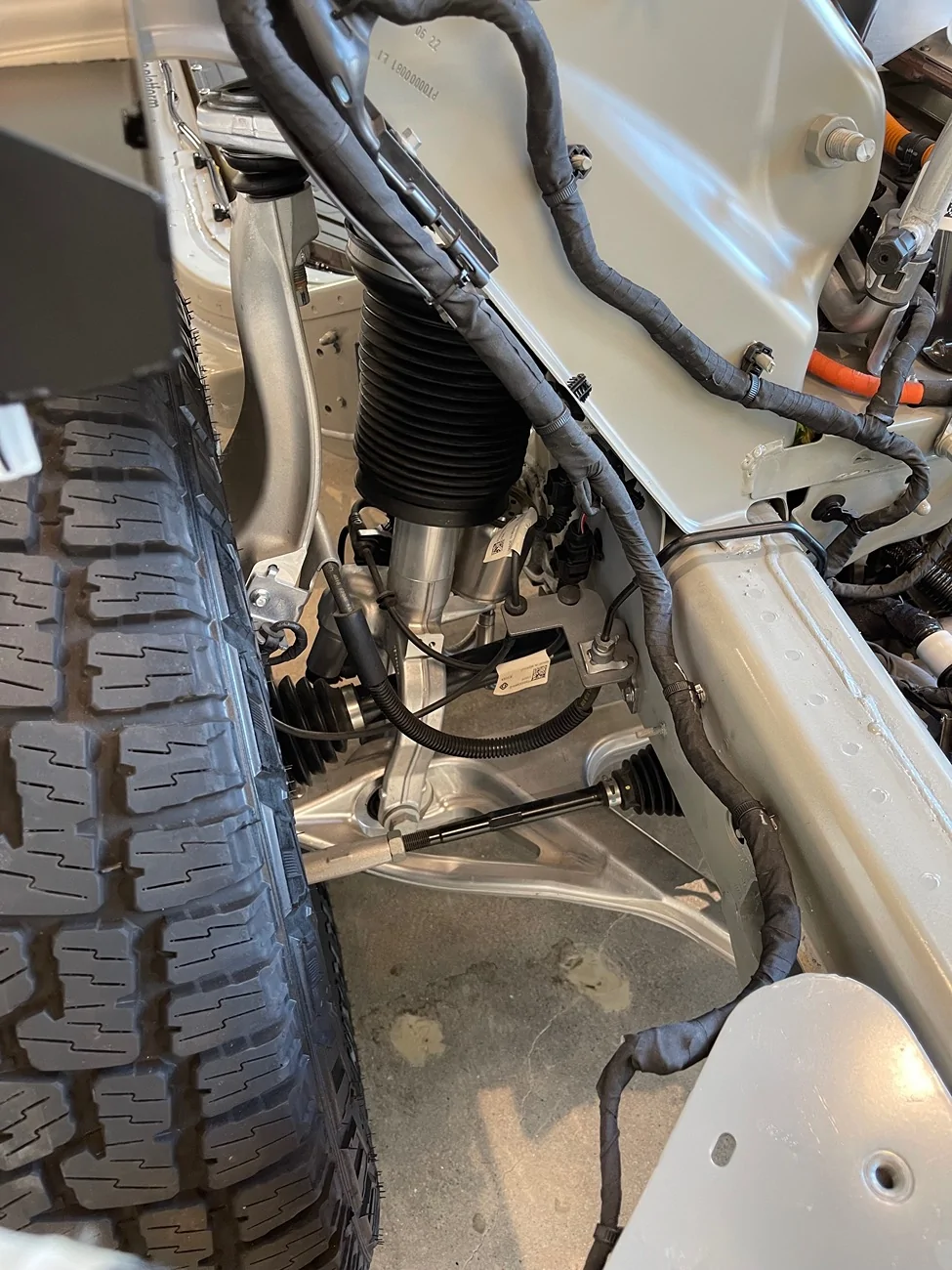

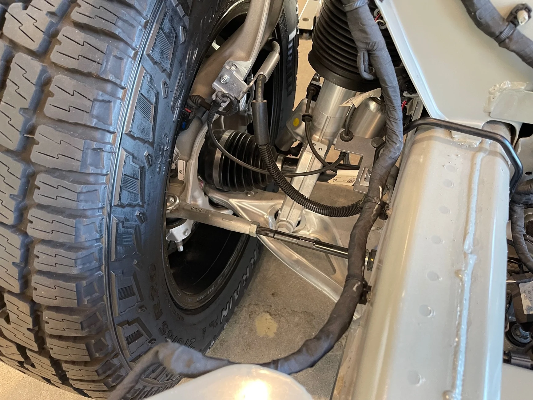

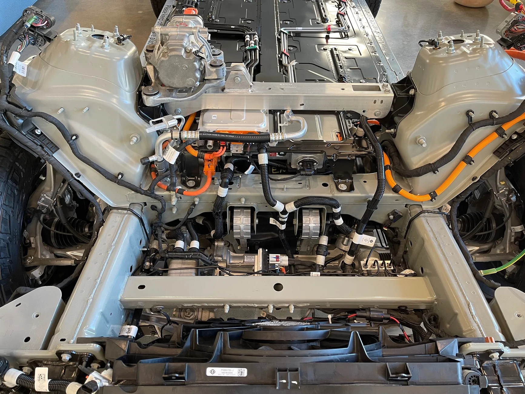

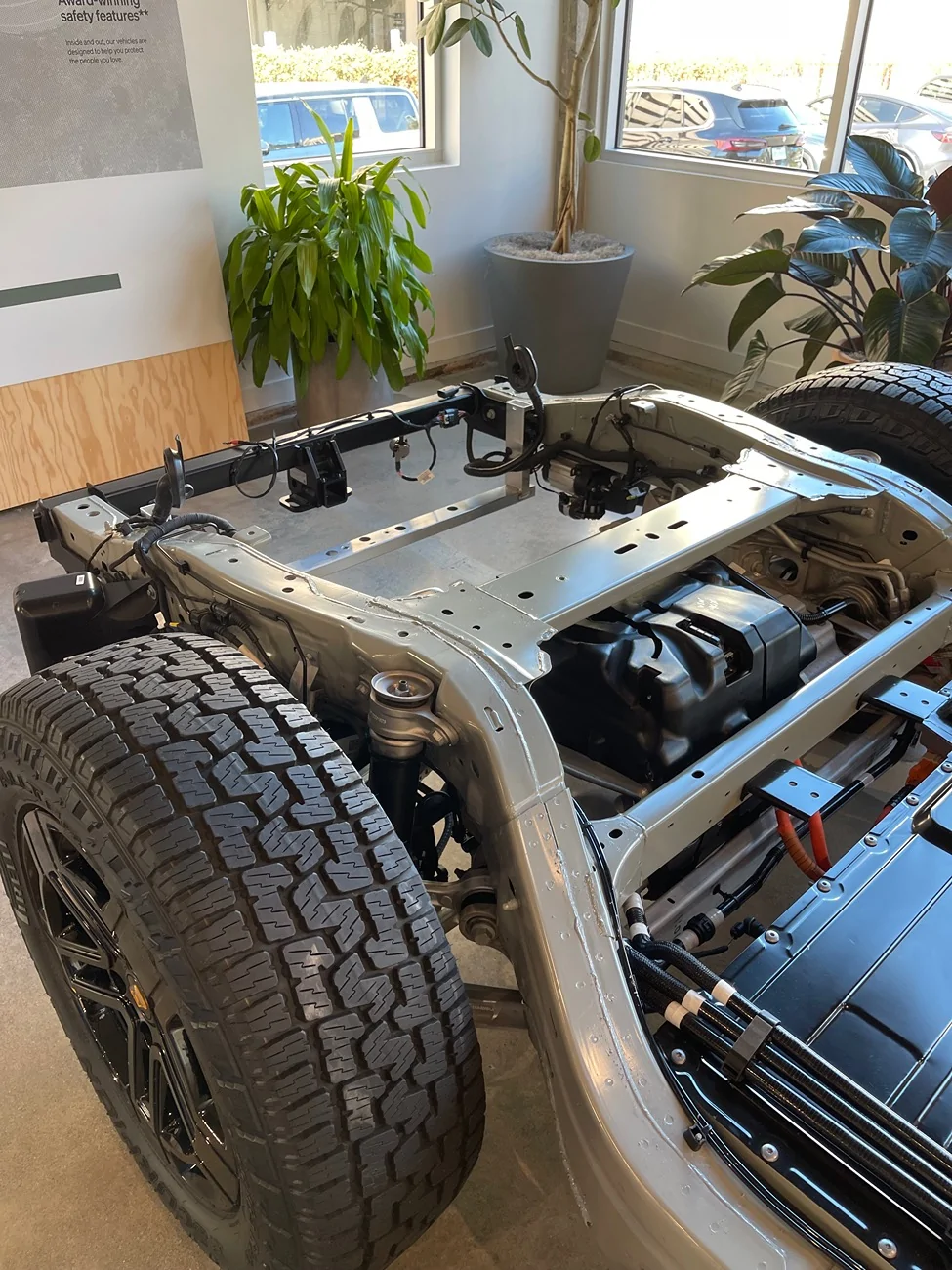

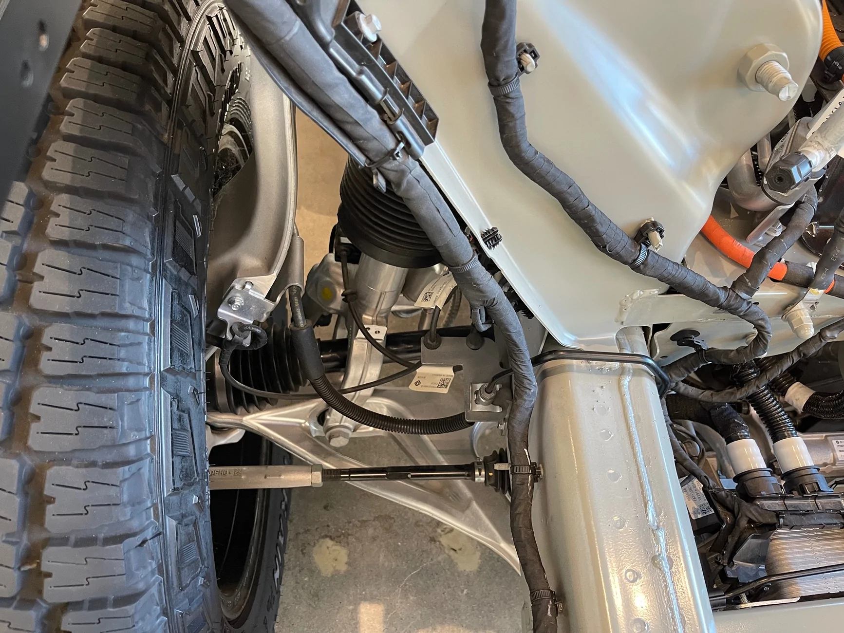

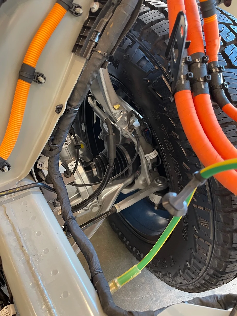

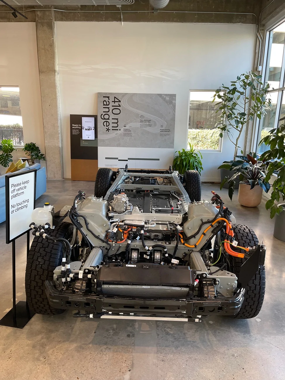

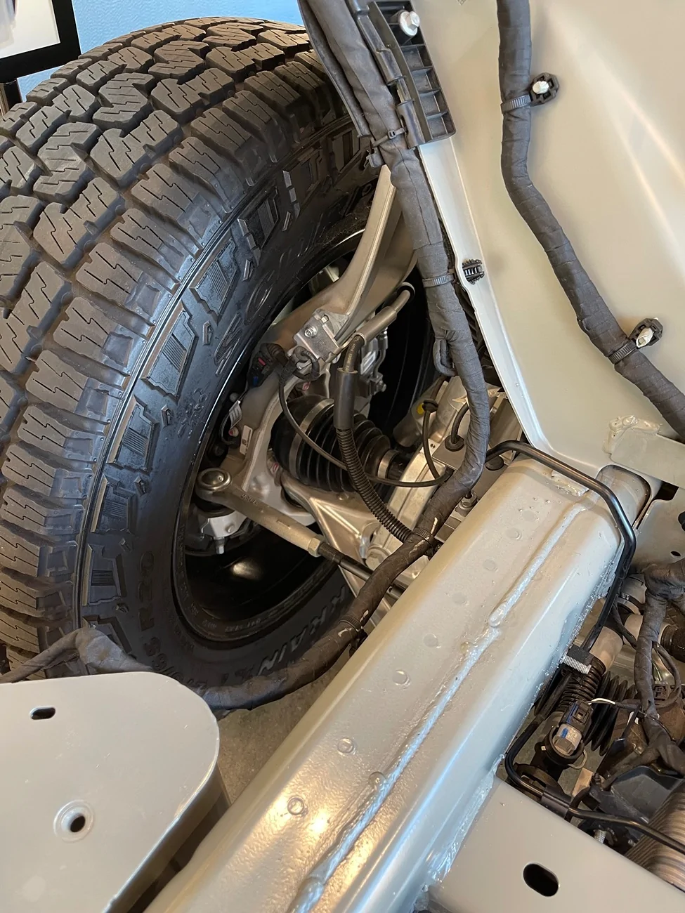

Powertrain and dampeners
Rivian R1T R1S Clunking sound from front end. IMG_9615
Rivian R1T R1S Clunking sound from front end. IMG_9616
Rivian R1T R1S Clunking sound from front end. IMG_9614
Rivian R1T R1S Clunking sound from front end. IMG_9613
Rivian R1T R1S Clunking sound from front end. IMG_9612
Rivian R1T R1S Clunking sound from front end. IMG_9611
Rivian R1T R1S Clunking sound from front end. IMG_9609
Rivian R1T R1S Clunking sound from front end. IMG_9610
