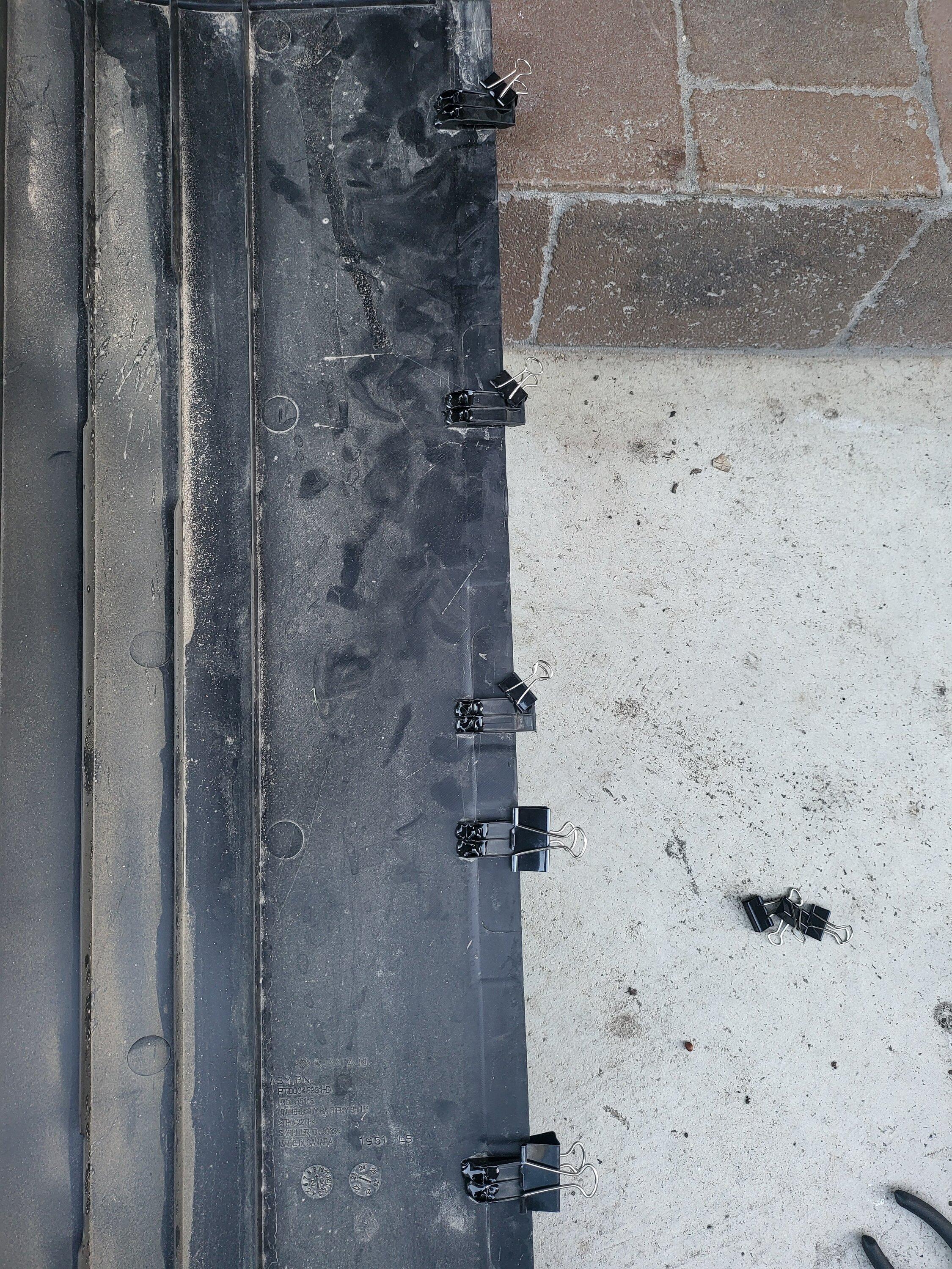

Thanks for all the feedback everyone. My concern was something loose unique to my vehicle. Sounds like, pun intended, there's something in the design such as a floating piston in the strut making the noise. Hard to say then.
The under body panel is definitely a clip issue. Somebody took mine apart before delivery and the clips got bent. They are pretty flimsy. I simply put glue on the clips to reinforce and put it back. I probably voided any warranty claim by doing that but then there's constructively no warranty as waiting months and it being more costly to go to a service center back and forth multiple times than just fix it myself.
Rivian R1T R1S Clunking sound from front end. 20240213_171503
I wouldn't mind fabricating some metal panels for this position.

Are those the under panels by the rocker? If so mine are off and sounds still remain. Took them off for running board install and did not want to cut them

Yes they would be where running boards would attach. I should have explained that the sound from those is at regular freeway speeds, not over bumps. The sound from the wind is a duga duga duga. I've heard this on other cars with loose plastic. Only my driver side had been molested before I got the car. It was easy to locate.
