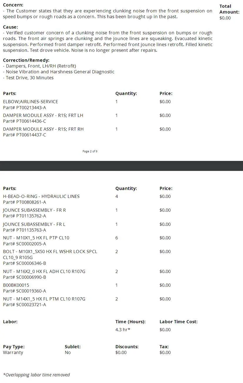

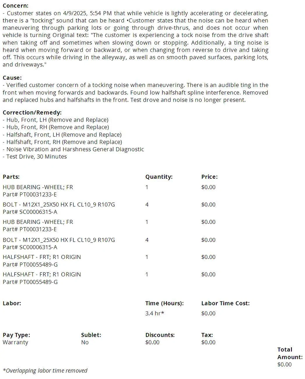

I just got new dampener for both sides / retrofit, new jounce lines / retrofit, halfshafts and hubs
The suspension does sounds better with no clunks based on the 65 or so miles I have driven over the last 17 hours.
I am currently at ~ 28,000 miles on my Quad Motor June 2023 build R1S.
I appreciate Rivian and my local service center taking care of this concern.

My Gen 1 R1T (VIN -
It does sounds based on the 35 or so miles I have driven over the last 14 hours.
My Gen 1 R1T (VIN = 3,XXX) with 25,000 miles is in getting almost the exact same service. They text every other day to tell me they are replacing something else on the front suspension. I had dropped the vehicle off for its 22,500 service and to find out why my second set of front tires is already bald while the rears still look brand new... guess I have an answer.

Did this resolve the clunking? I have the same problem.
This did help really quiet down the front end especially on potholes, manhole covers and rough roads.
I will test later today on speed bumps and report back and even take speed bump unevenly to see if that improved as well.
My Gen 1 R1T (VIN -
I'm glad they're getting you squared away. The 2022 - 2023 R1T definitely felt like a noisier suspension when compared to R1S but overall R1T has better handling and driving dynamics when compared to R1S which tends to have porpoising / very easy to toss around.
The new dampener / jounce lines will help make a huge difference for clunking noise especially on R1T and also to a certain extent the halfshafts and hubs from a noise perspective when driving slow or making low speed maneuvers. I think you'll be happy with the service they will do for you.
I do hope this last more than 28,000 miles.
I went over 5 speed bumps and took 2 of them evenly and three of them where only one side hit the speed bump and the other side was flat on the road.
I noticed a big difference from before and no longer hear any clunk, tock / ting from the front end.
I also noticed when getting out of the alleyway into the main street when there is a dip, I previously use to get a clunk. Now that noise is gone and the sound is just silent. Pure bliss.
I hope this lasts for a while.
