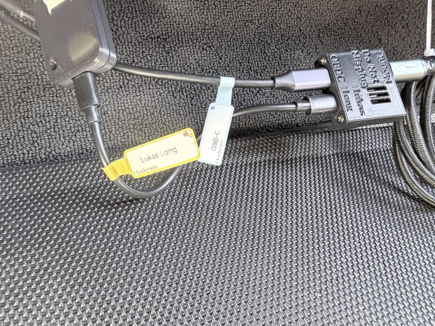

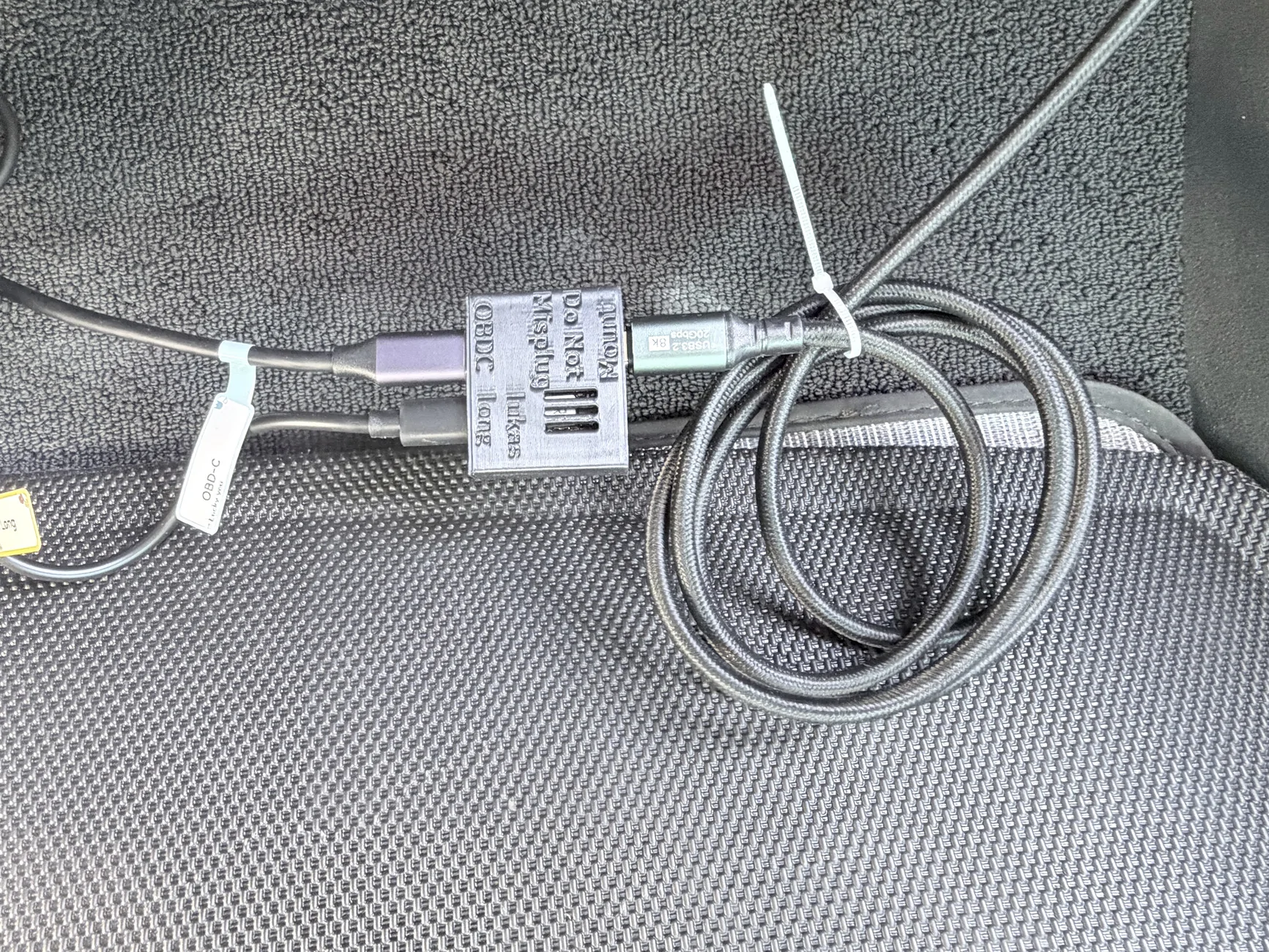

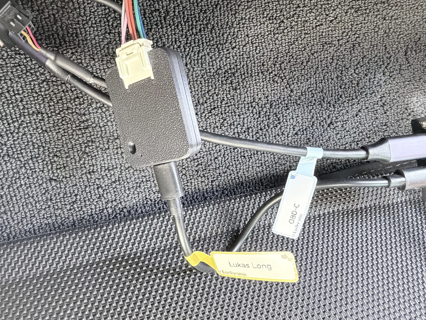

There were multiple things wrong:
1. I plugged in the Lukas long harness to my computer via USB-C and confirmed the LEDs light up. The long harness receives power from the USB-C port. This confirmed there was nothing wrong with the harness.
2. When connecting the Lukas long harness directly to the Comma 4's aux port, I specifically needed to use the long USB-C cable provided by Lukas to connect the two together. I was testing with the long USB-C cable provided by Comma (thicker), which doesn't work for some reason.
3. The Janquick Quick Release Mount box is defective. While it passes through the USB-C from the Comma Harness, it doesn't pass through the USB-C from the Lukas long harness. Even when using Lukas's long USB-C cable between the long harness and the Janquick box (which I confirmed worked in #2 above).
Something about the Janquick box blocks USB-C power from going from the Comma harness into the long harness when routing through the Janquick box. I removed the Janquick box and permanently routed 2 separate long USB-C cables going up to the Comma 4. All is well now.
