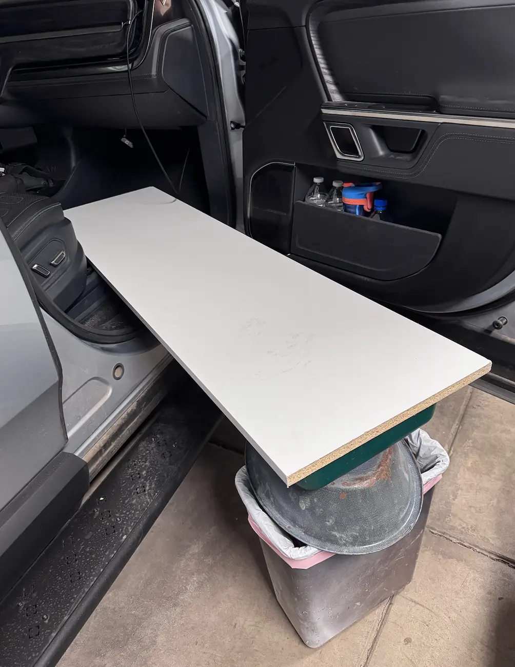

Stationmaster
Doug
Mar 23, 2023
60
69
Wagon Wheel Gap
2022 R1T, 1951 MG TD MKII
retired educator
Here is what I used.... and lived to write about it.
I spent more time in that footwell than desired, but am very happy that it all works.
Next time I will also. use a pillow and a mattress pad..... maybe add an electric blanket?
That looks like one of those “this is why women live longer than men” memes. I like the ingenuity, I’ve done something similar on faucet repairs crawling under the sink.
