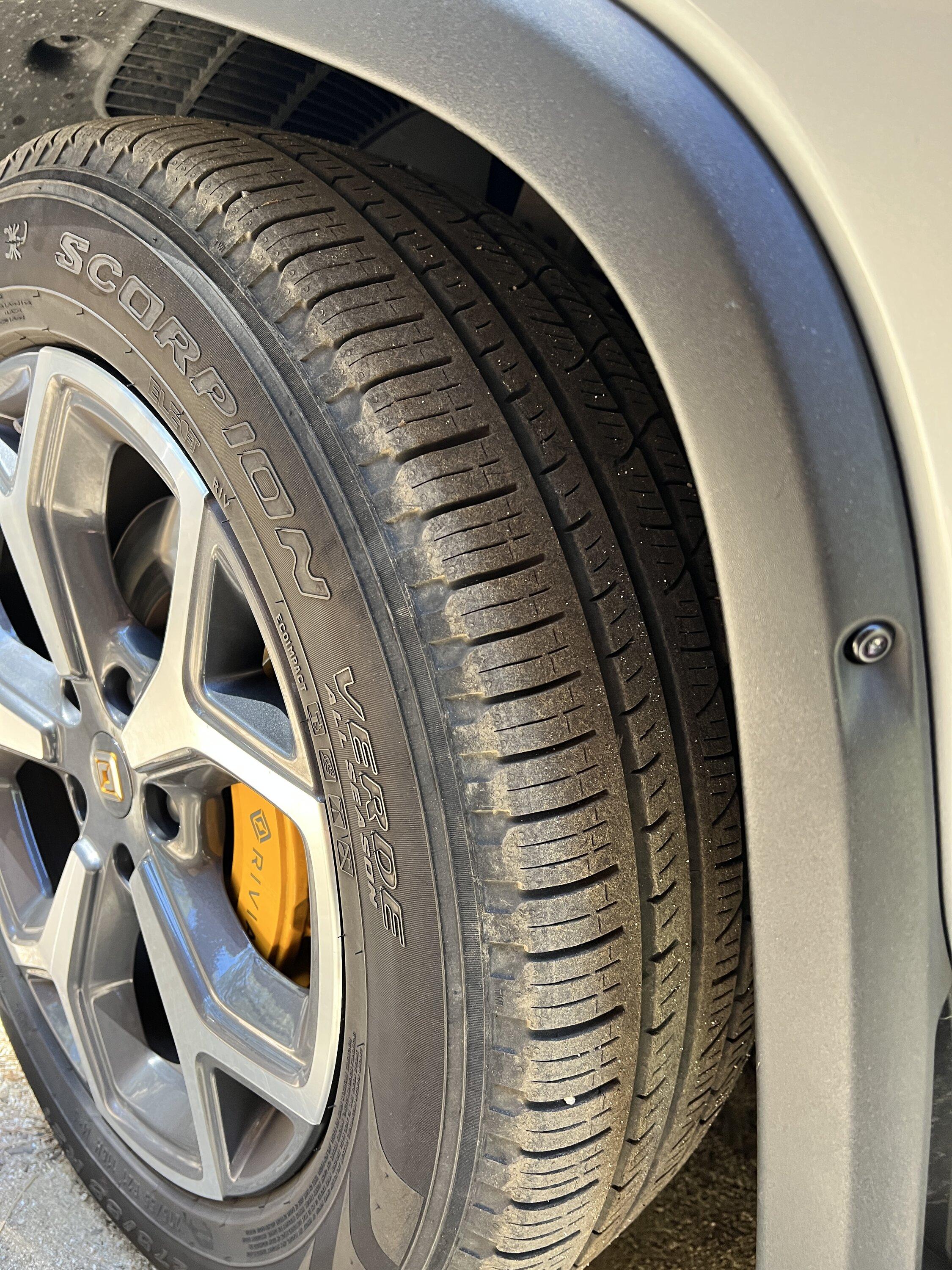

I have the 21” Pirelli Scorpions, with 22k on them. They look to to have close to 30% wear left, I am hoping to get 50k out of them. I drive 99% in conserve mode with no abnormal wear showing. I did rotate at 15k which is very important if you want the max wear out of any tire. If you are seeing any abnormal wear rotate sooner.
Rivian R1T R1S Conserve mode: Need new tires! IMG_8496
