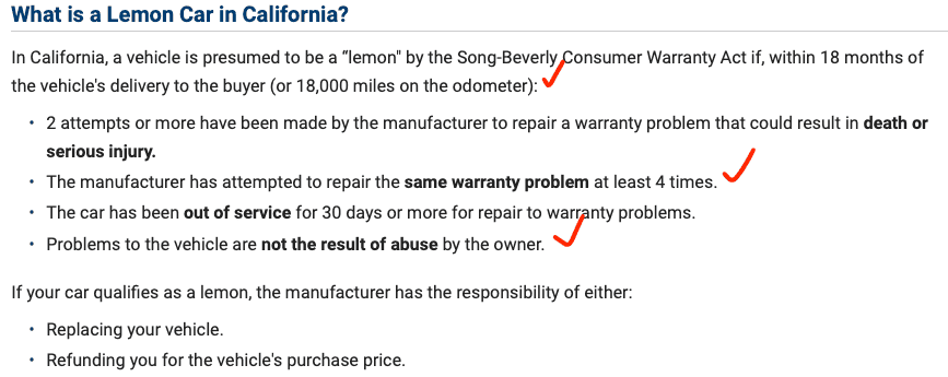

I'm a few hundred miles from the odometer being 18,000 miles so I might want to consider going nuclear and bringing up the lemon law option to the service center when I'm there next week
I'd prefer not to do this, but I am getting pretty annoyed taking in the truck for constant repairs. I knew what I signed up for when buying an EV from a new company, but doesn't mean I shouldn't hold Rivian to these consumer protection laws.
What is everyone's opinion on this?
