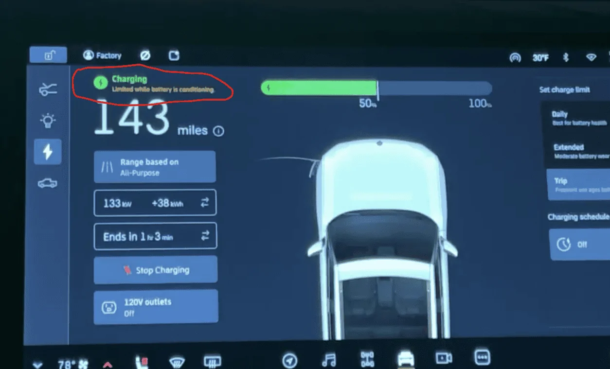

If ya'll haven't noticed, the wonky ass charging curve has been bothering me since @timesinks posted his first curve. Thankfully Kyle Connor livestreamed his trip back to Colorado from Phoenix. I went through and logged the curves from the latter half of the day, and it was very clear that battery conditioning was the cause of a couple of throttling events. Kyle was pretty convinced that it was because the battery wasn't warm enough, and was eventually coldgating. YMMV, but keep an eye out for the "battery conditioning" warning that is on the screenshot below. It shows up when it starts conditioning the battery mid-charge. It doesn't warn you ahead of time or anything, and it doesn't actually do much based on how little it recovered while charging. Until Rivian implements either manual or automated battery preconditioning, it looks like we may need to be doing some yo-yo driving to try and heat the battery up.
So, here are the curves. The dashed one are the ones that had conditioning occur during the session, and it happend right when the charging speed dropped off. For context, Kyle had been driving at highway speeds all day. The coldgate events were when the outdoor temperatures were in the 30s to low 40s as I understand it. One session that didn't coldgate he yo-yo'd beforehand (and actually got limited regen). The other instances were closer to phoenix and earlier in the day, so I assume warmer.
He unplugged the yellow curve too early to see it come back off peak, but the blue and orange curves seem to be a fairly reasonable ramp down in speed to 80%.
All of the curves were limited by the 350Amp issue with EA, so the max speed seen was about 155kw. He tried to charge at a station that apparently should have put out 500 amps per Ryan Huber, but that was one of the coldgate curves.
Hope this helps, and hopefully Rivian issues some more proactive battery temperature management to reduce the number of poor charging sessions like these. Even if it's just manual.
