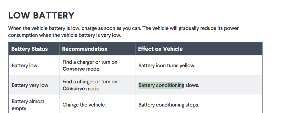

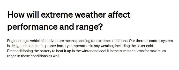

Currently the car isn't verbose enough for the average consumer to understand *why* their $80k truck is charging so slowly. Which I view as a problem.
The screenshot below is actually all that the owner manual says about it. Is battery conditioning not functioning properly? Kyle plugged in once at 3% and had battery conditioning occur mid-charge, so "battery conditioning stopped" very well could have been the issue there. But that doesn't explain plugging in at 19% and having it happen.
Rivian R1T R1S DC Throttling "battery conditioning" 1648084211719
There's no info in the manual about what it is doing when it says it's conditioning the battery during a charge. There's no way for owner Bob to know why it's doing that. Is it too cold? Too hot? Is it broken? Is that going to happen most times?
Point being, even as a total Rivian nerd, I don't know if they're going to fix it (I suspect they will), and I don't know what's causing the slow charging curves other than hunches after living vicariously through a guy driving the equivalent of across the Country for a day.
