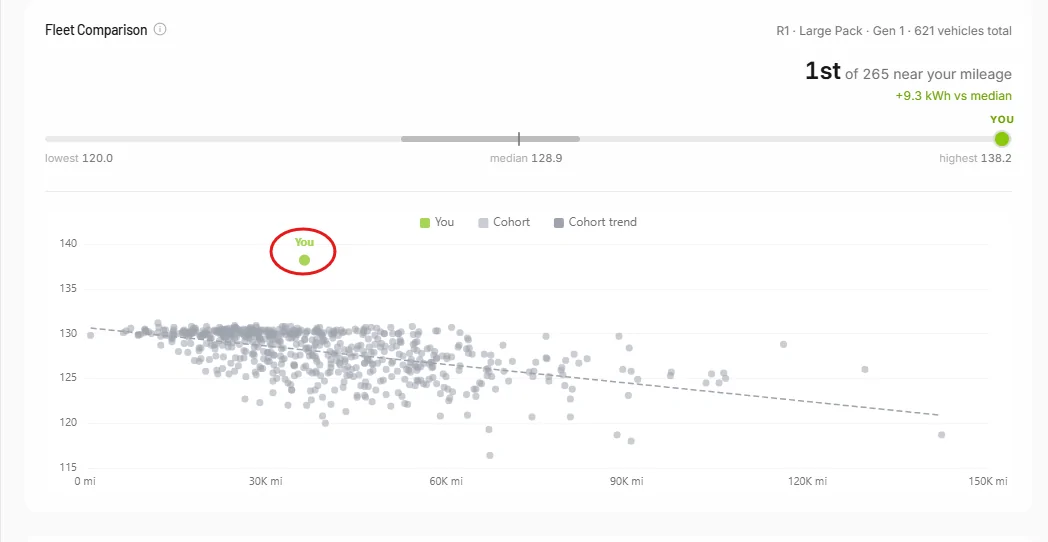

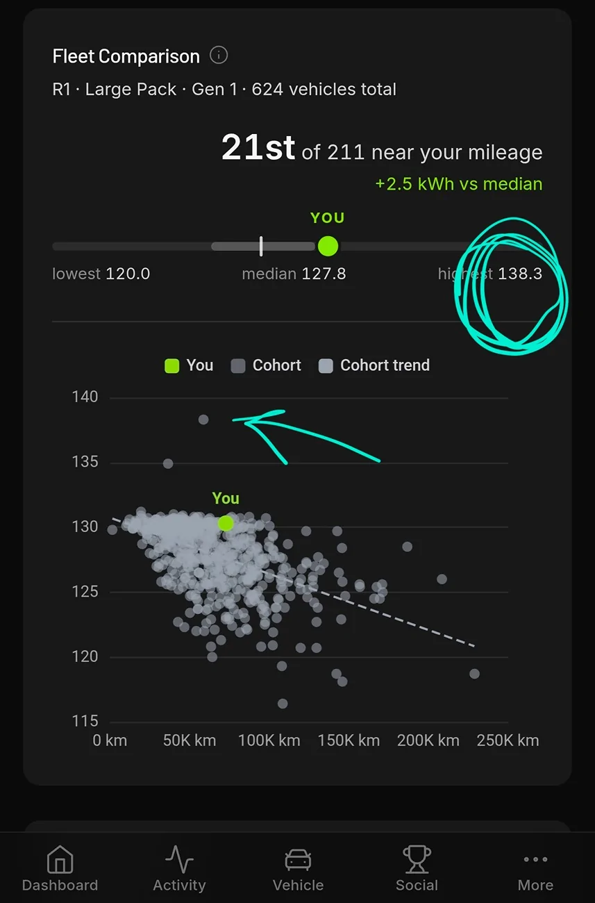

So after learning that the Gen 1 Large pack is 131 kWh I always wondered why my battery always showed up around 138 kWh. Using Rivian Roamer or ABRP you can see the battery size in kWh, which is also helpful in measuring degradation.
Whenever I charge to 100%, I have to drive about 20+ miles or so before that 100% drops to 99%. Just drove 280 miles to Chicago and arrived with 75 miles of range left. 75 MPH the whole way.
I synced up Rivian Roamer last night and this is what I found --
Rivian R1T R1S High Capacity Battery (Lucky me?) 159937-63e9aa0de25456f978b28b83b7eefc6
Rivian R1T R1S High Capacity Battery (Lucky me?) 159947-f69171006104e0f491591e6da2437f6
36,000 miles
105.5% original spec capacity.

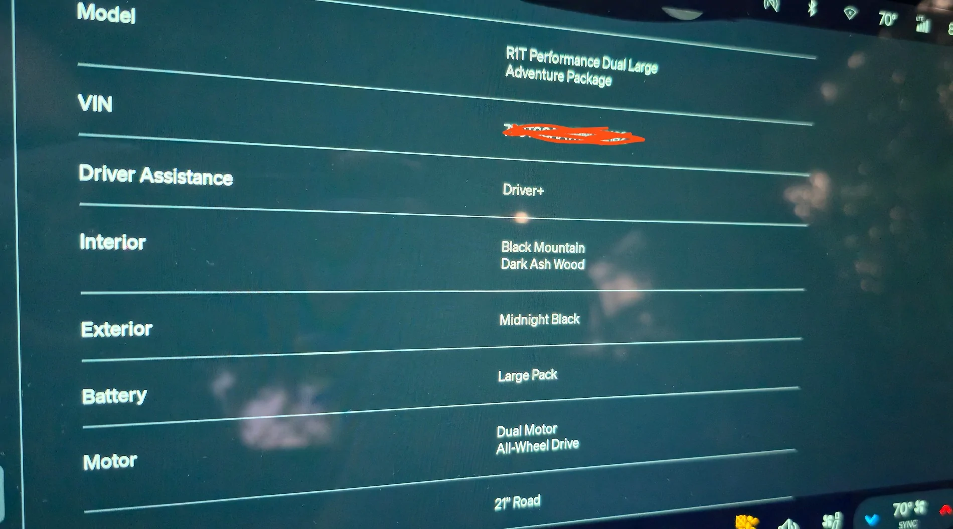

So you have a max pack Dual motor. Just not software locked. Somebody else once posted the same thing. Lucky dude

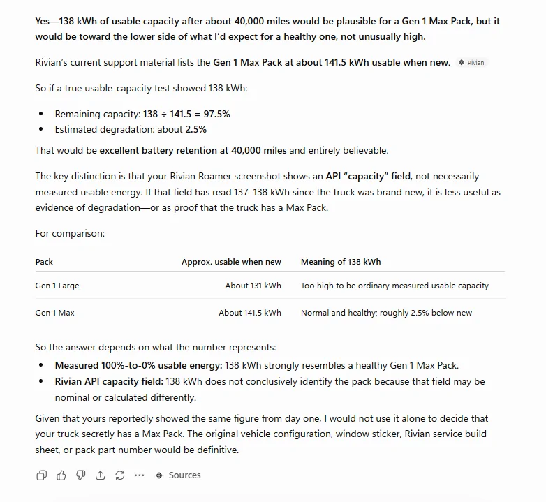

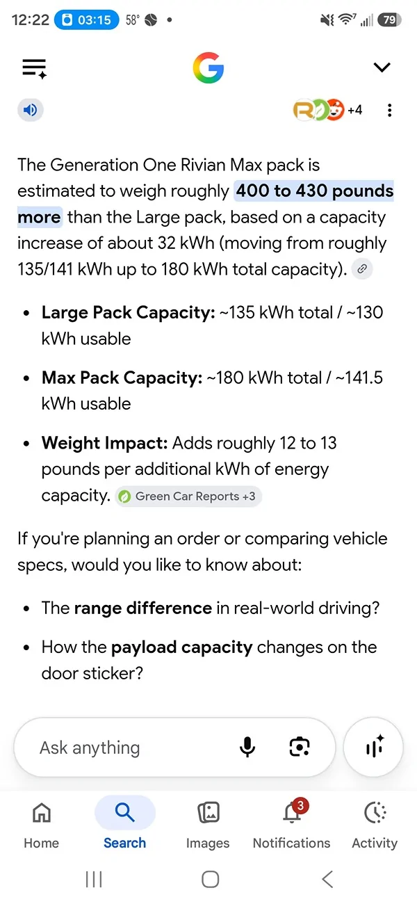

This is AI making shit up.
I don't know what the weight difference is between (original) Large and Max, but they use the exact same number and size of cells in the same modules and overall enclosure.
The real weight difference is probably +/- 20lbs.
Edit: cells are about 1g heavier each, meaning the whole pack is 7.8kg heavier or ~18lbs.
