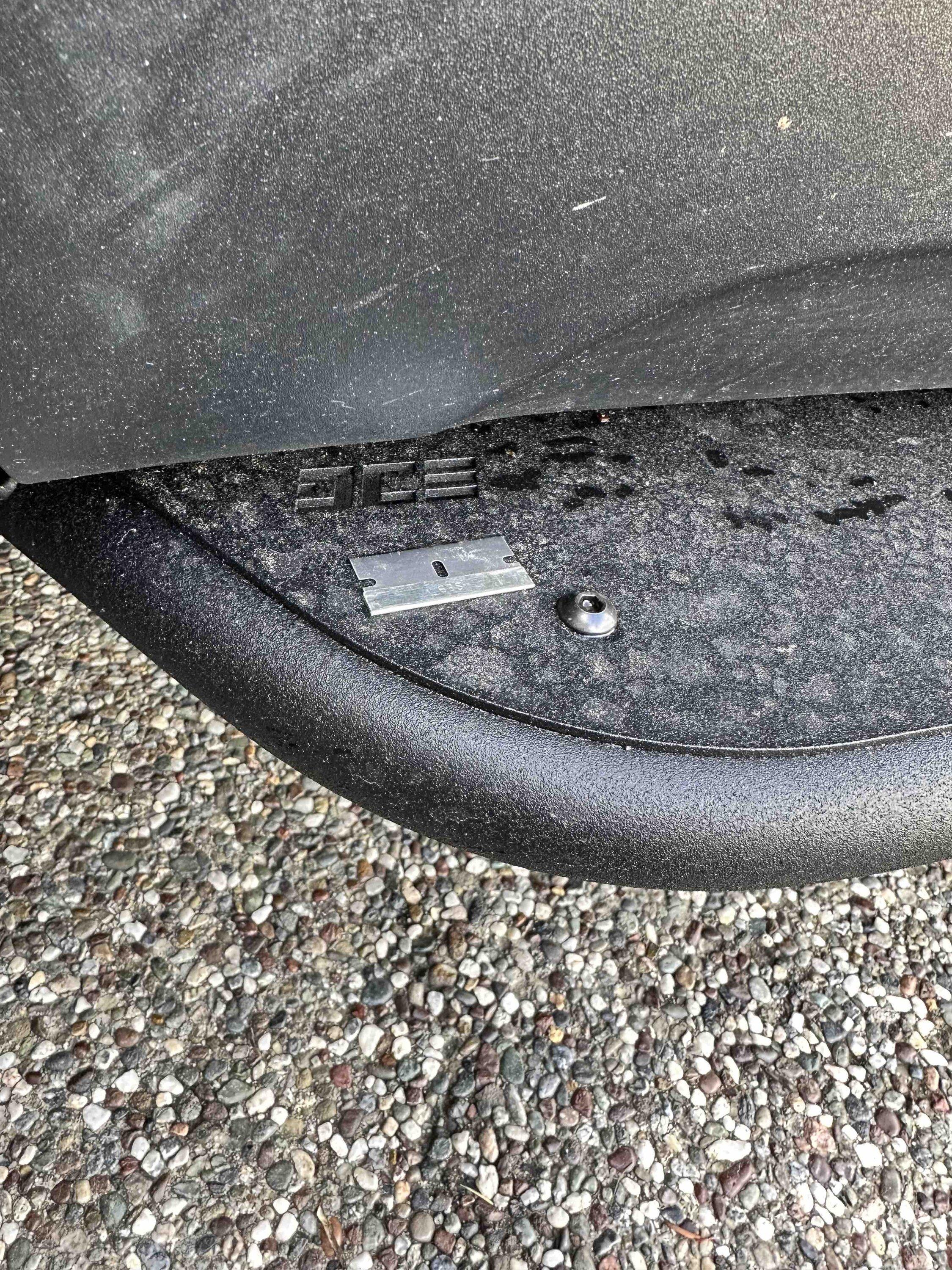

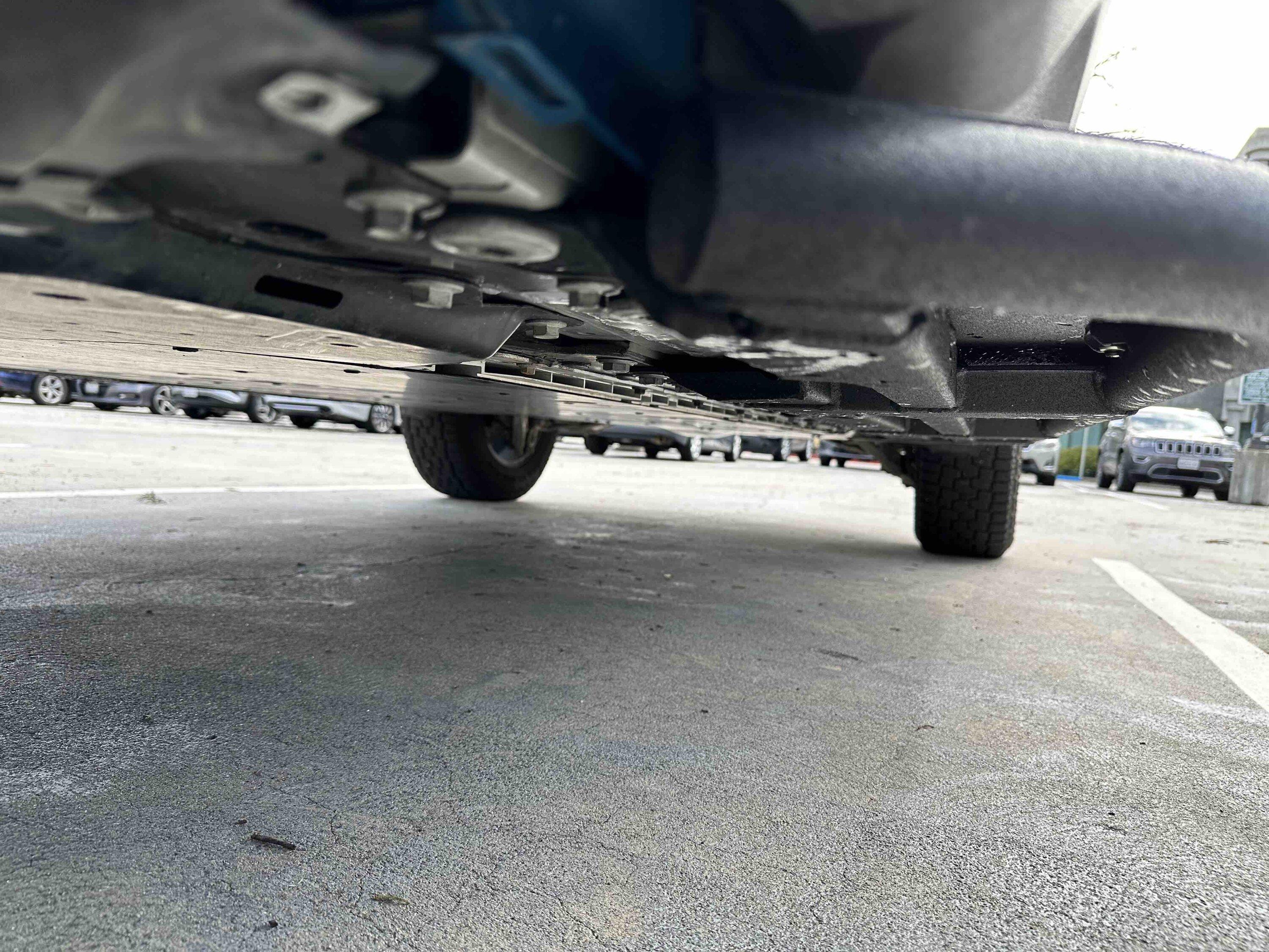

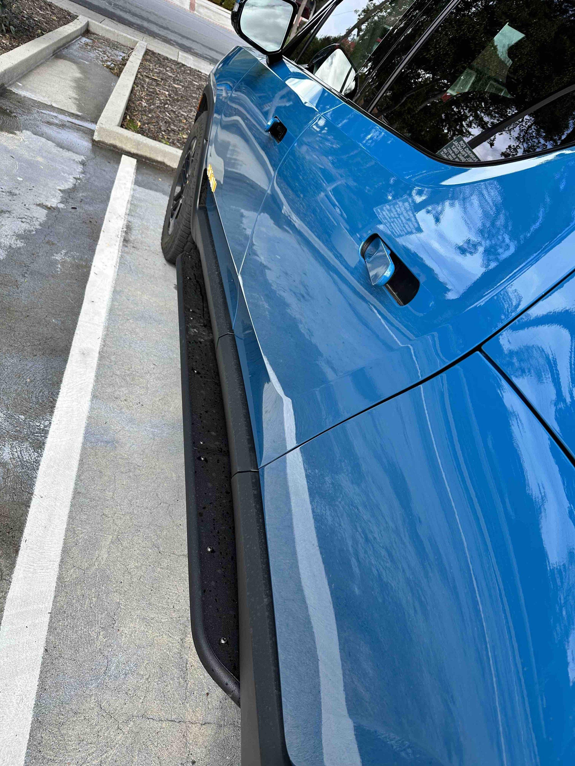

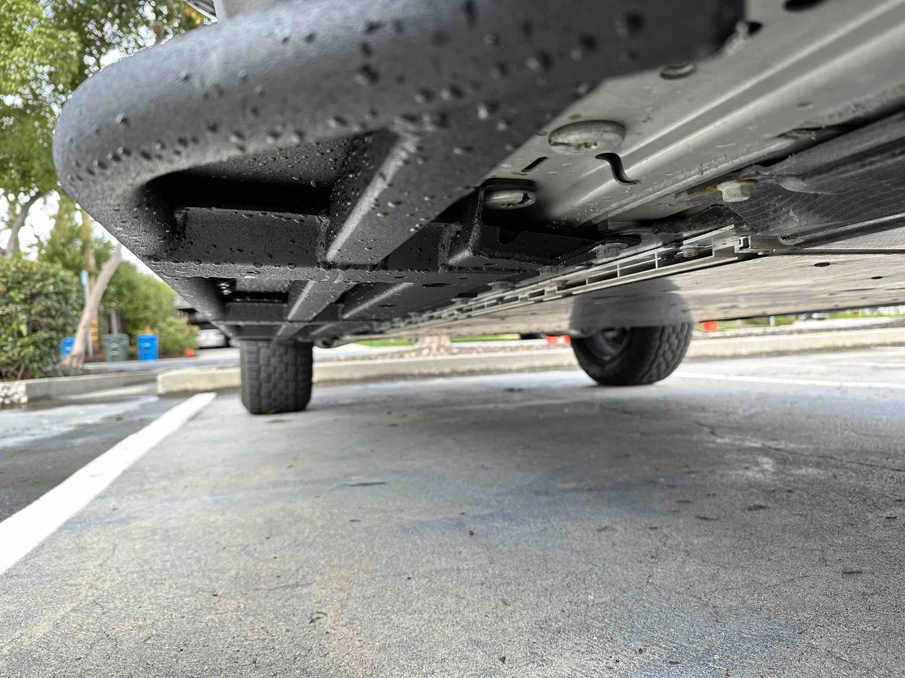

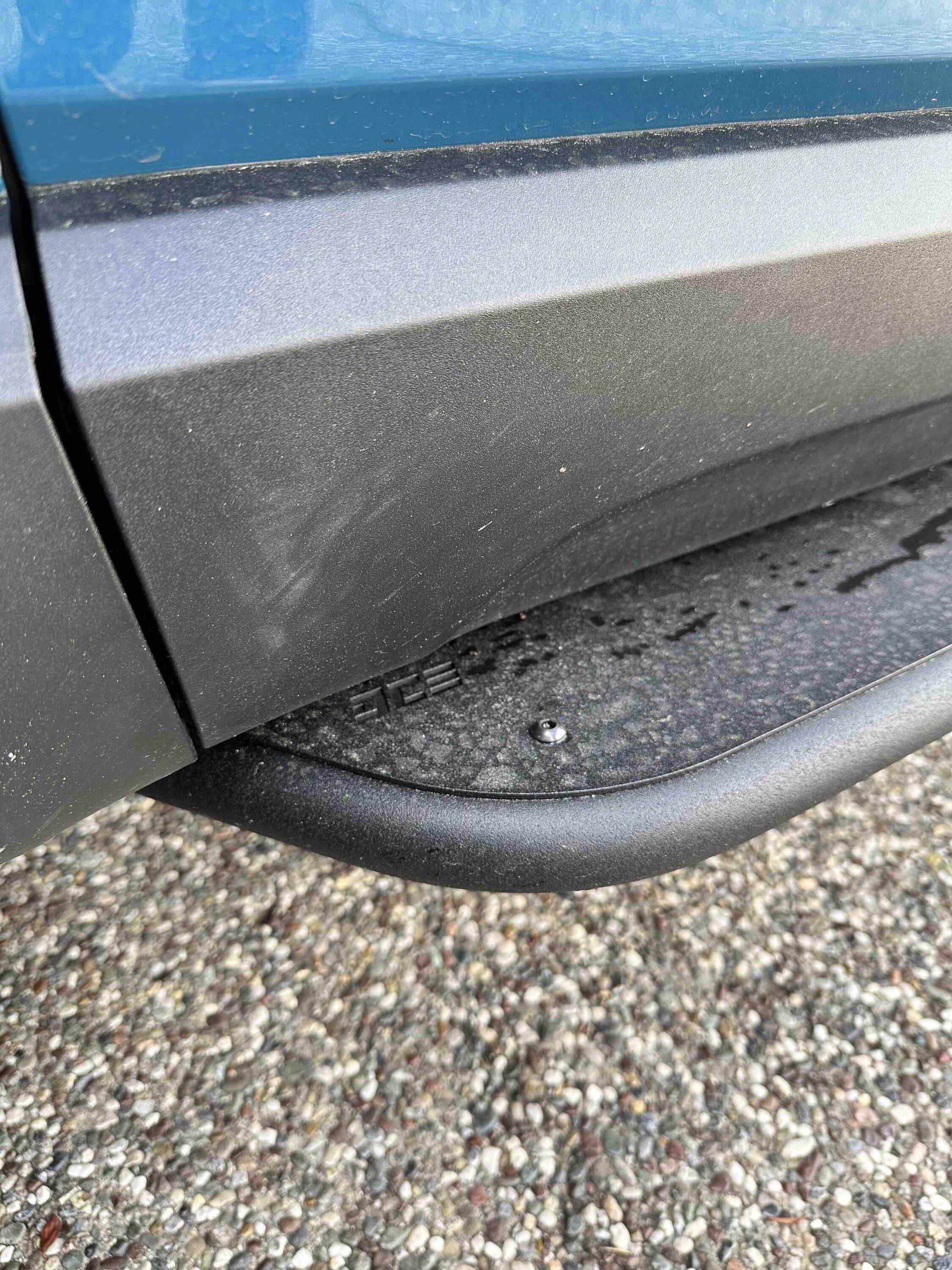

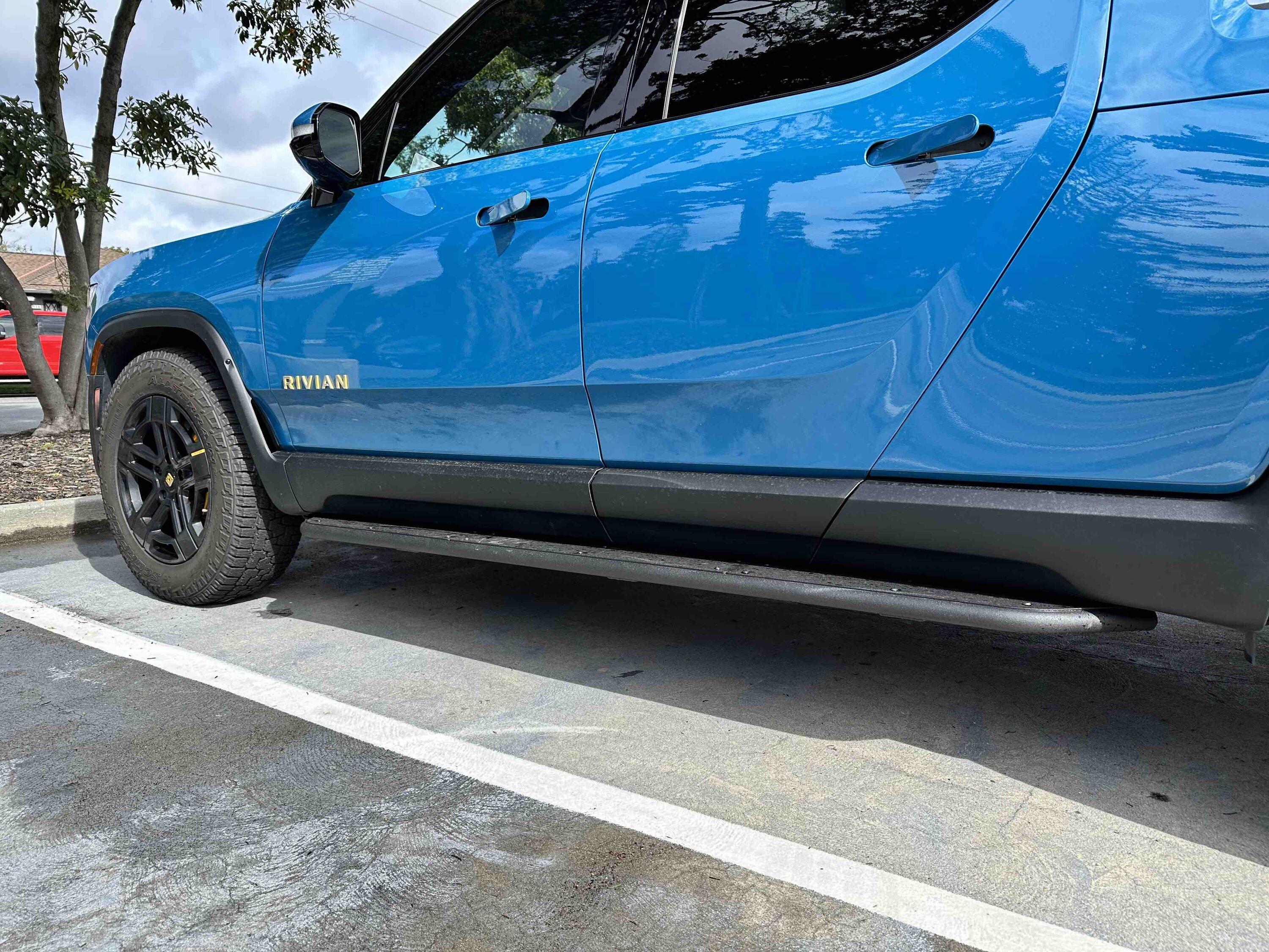

Wanted to add my experience to this thread. I differ from @obfuscurity in having the reinforced underbody shield and having the "stealth" top plate revision.
I managed to install these last night in a few hours by myself
  1. Easy to pull off the panels and clips per instructions using a long flathead and a pick. No clips broken!
  2. No issues with impact wrench removal of TP55 or 17mm screws.
  3. Was able to mount the sliders by myself (note, make sure all of the TP55s are only out that 1/2" before sliding it in, except for the 2 at the front that are removed completely. I didn't do that at first and realized I had to slide the slider off again to put it on. Also the last 2 in the rear don't need removal).
  4. Used revised torque specs 95 and 55ft-lb without any problems.
Thoughts
  1. Appear incredibly well built. Solid, heavy, very nice powder coat and texture is really grippy. Very well packaged.
  2. The revised "stealth" top plate is an awesome revision. You have to look hard for the DCE stamping.
  3. I have the reinforced underbody shield. The removal of the plastic panels reveals a the open cell sides of the shield. This is the same as the Megawatt slider proto that was shown. While I know the plastic wasn't waterproof, and functionally nothing would change if water/mud got in there (its not open to anything else) I'd prefer not to leave an open space for crud to get into. Am considering if there is some way to cut the original panels and install to cover it up, just use some RV underbelly tape to close it up, or something else. All ideas/suggestions welcome!
  4. Doesn't make any noise driving and I'm not noting any range change (its only been a day).
All in all, it seems an awesome product, and the only rock slider thats actually shipping, which ended up being a major factor for me having something for the kids to have easier ingress/egress with intention of doing some trailwork this Spring. It looks like the Megawatt may be beefier at the cost of some clearance loss, but as I'm not planning on going hard core, I think (hope) the DCE meets my needs well.
Here are some pics. Sorry they are dirty, it was raining last night.

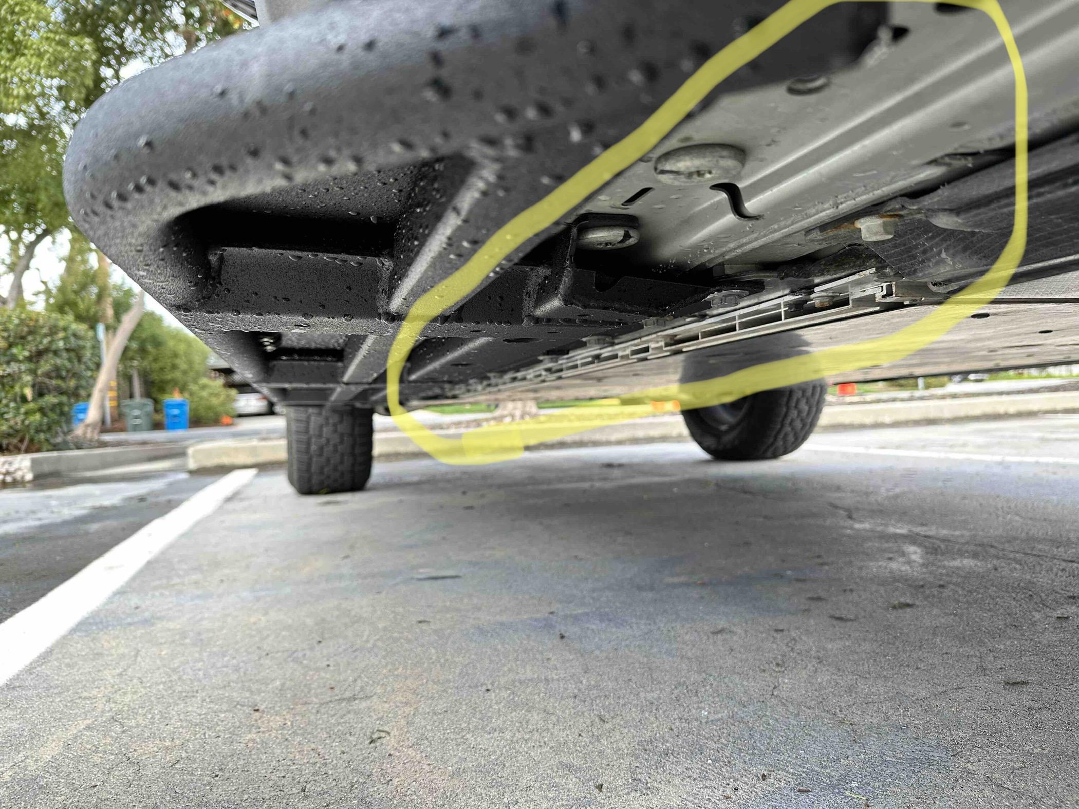

So, these areas are now exposed? Are there any concerns with this for dust and debris getting into places they shouldn’t?
Rivian R1T R1S DCE Rock Slider Product Overview & Install video for Rivian R1T / R1S C0E3754C-9735-4A01-8F14-87B2D811865D
skunn
May 5, 2022
117
134
SF Bay Area
Rivian Blue R1T, Tesla Model 3
That is the question. It is clear that the plastic that is removed was not preventing water or dirt from getting in that space. I have to believe this is all manufactured expecting these surfaces have elemental exposures. For me its less avoidance of exposure and more avoidance of collection.
But, it is certainly more exposed now. All of the available options have this. The 1EV running boards have their open slot/round cut if the pieces are even put back on, the megawatt proto shown has this, etc.
