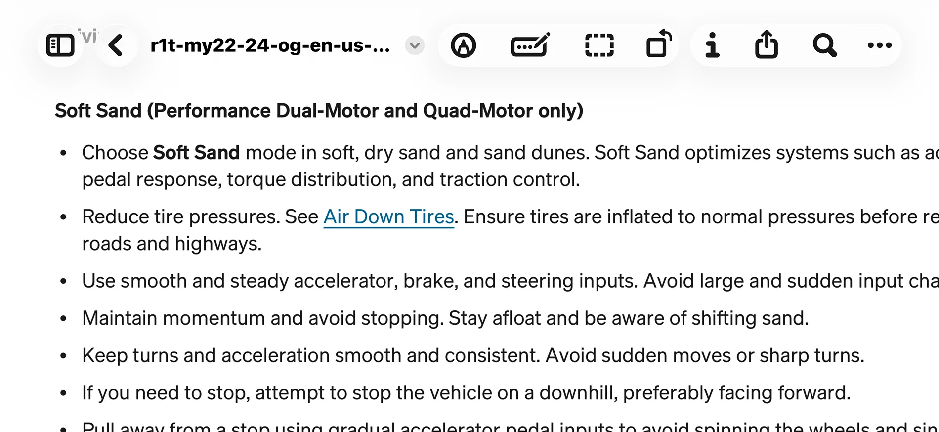

Uhhhh? Where does Riv state not to air down?
This is from the owners guide.
Thank you for this. I called support and they said the vehicle was designed to not need air pressure reduced for soft sand -- that is why it has that mode. I'm glad this is in the manual and will do this now. Funny note -- using KickTurn digs you in further... not sure how to use it in soft sand, but will try with air pressure reduced. It works on a large dirt area, but we don't have many of those -- we have tons of beach to explore, as long as we can do it safely.

You probably should look into taking some sort of off roading course to get a basic understanding of physics before you break things or worse.
Kick turn relies on wheels spinning in place to make it turn. Spinning wheels in place in sand, snow or mud will make you sink.
Above it clearly says no sharp turns and keep your momentum. A 4WD course will explain same.
This advice would specifically exclude kick turn by definition.
