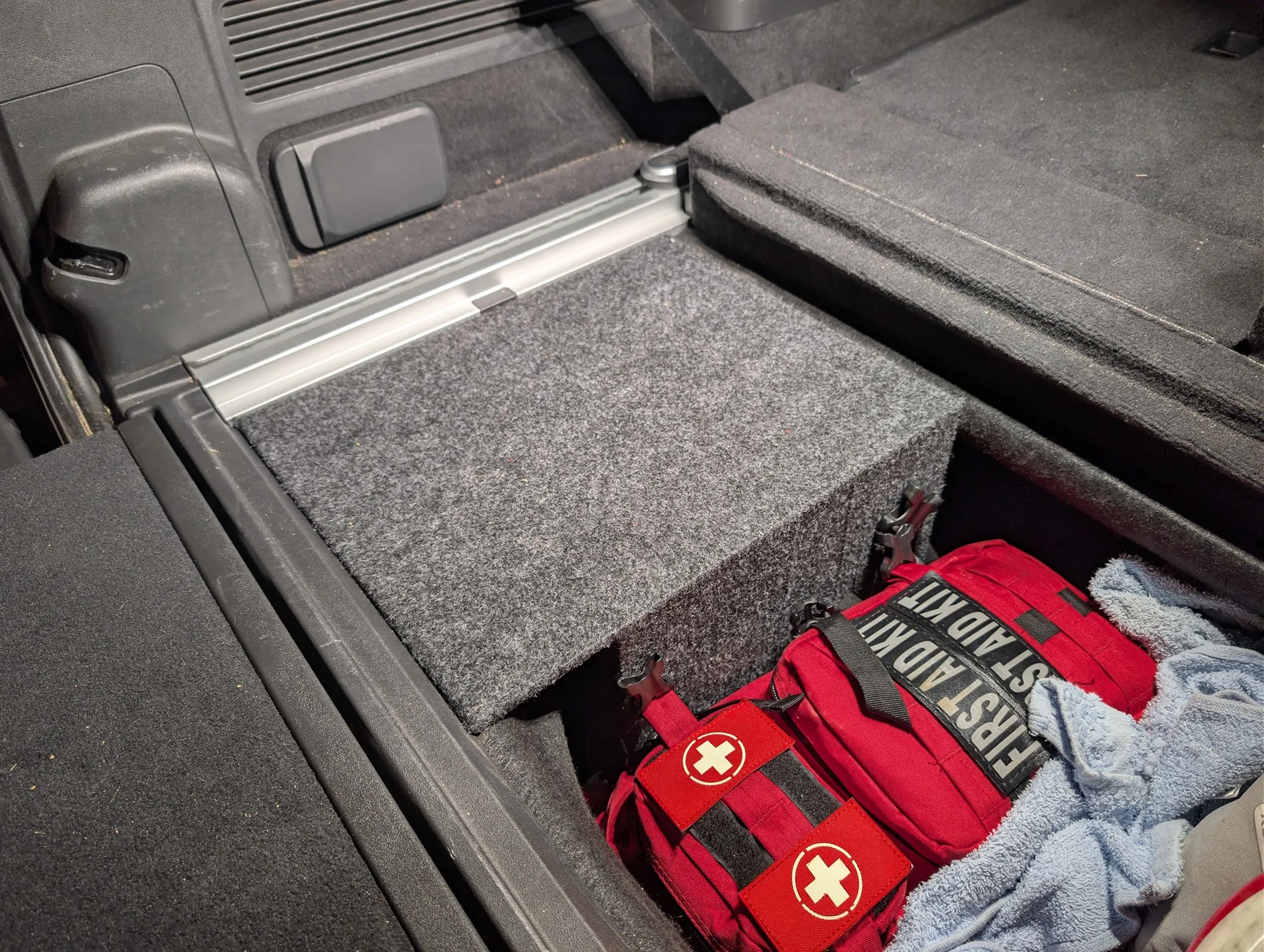

Time for another update. In an attempt to make the bass more uniform across volume level and music genre, I'm going to install a NVX XLCA2X which is similar in function to a LC2i (original bass roll-off line output converter). An added benefit of the XLCA2X is that it will do remote amp turn on based on voltage detection from the speaker outputs. Not strictly necessary, but it will save that extra few milliamps when camping/forgetting the doors are open.
But while I was preparing for that, I went over the existing setup and realized I had wired the dual voice coil subwoofer in series rather than parallel, thus presenting the speaker load to the amp as 8 ohms instead of 2. Credit to the NVX amplifier that it didn't let out the magic smoke on me. But all that to say after it was wired properly, even with no gain adjustment and 2 volt input for the sensitivity, way too much bass if that's even possible. Definitely going to leverage the remote bass knob and output levels on the XLCA2X to address this.
The lessons learned here are that 200 Watts is plenty for a 10-in subwoofer in a properly sized sealed enclosure. Curious what the factory subwoofer wattage is.

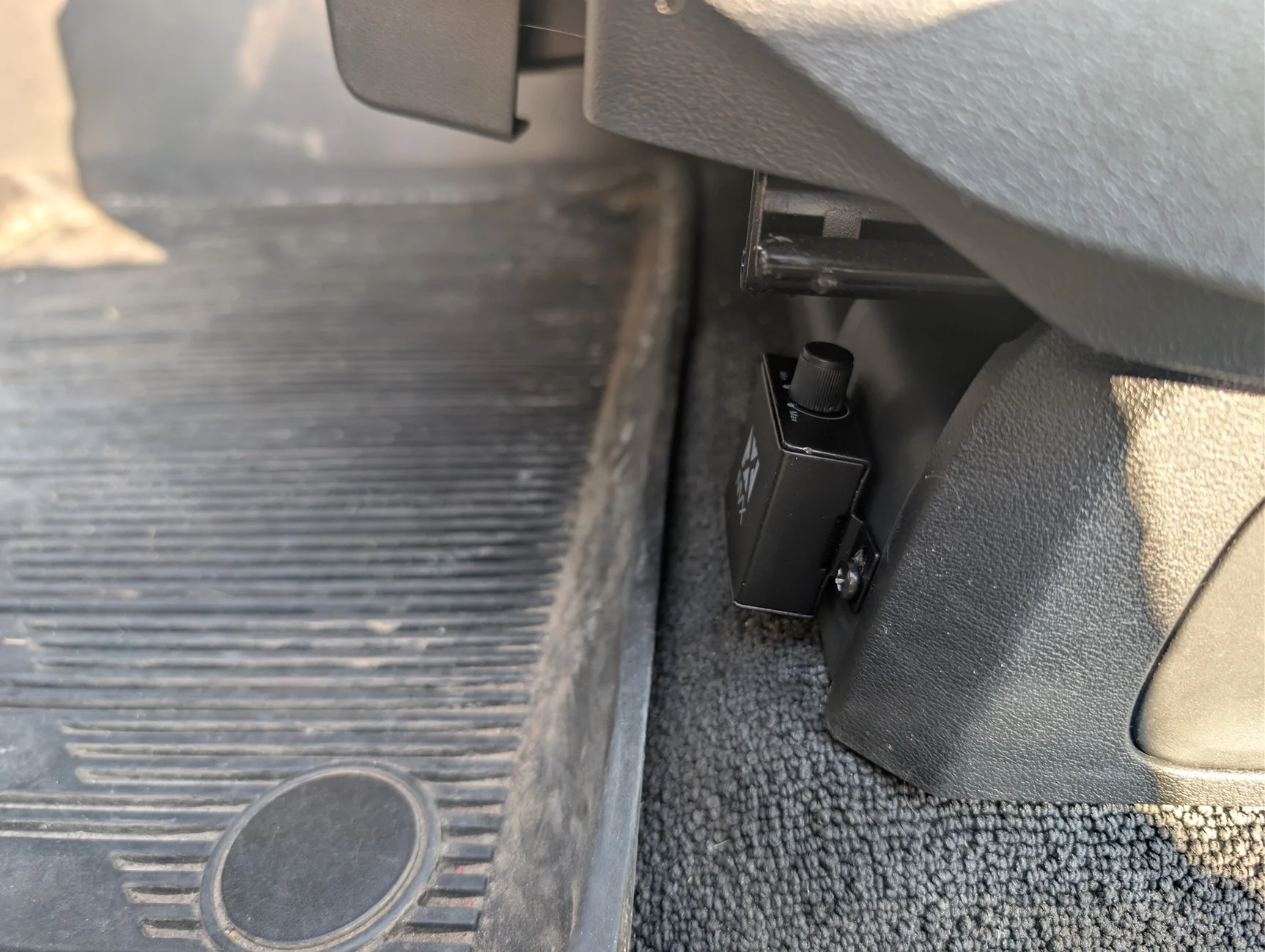

Very much louder. In fact, I decided to finally use the remote bass knob that I orignally didnt think was necesary. It was another tight fit to get the wire snugged up under the trim, but yet another testament to a good build quality from Rivian that everything was designed to fit togther well.
Per a support request to NVX, they menioned that only one remote bass knob is necesary when using the XLA2CX and the VADM1 (they each have one).

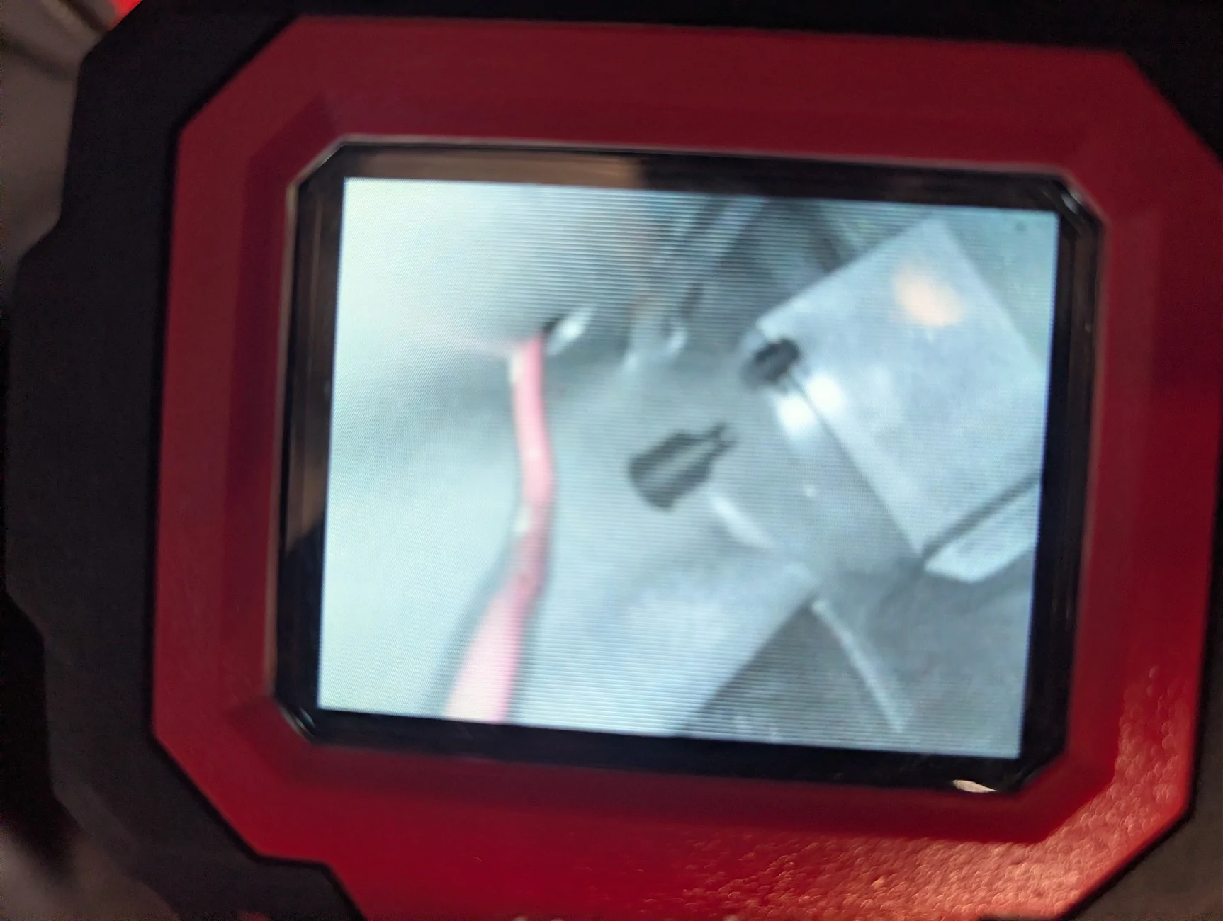

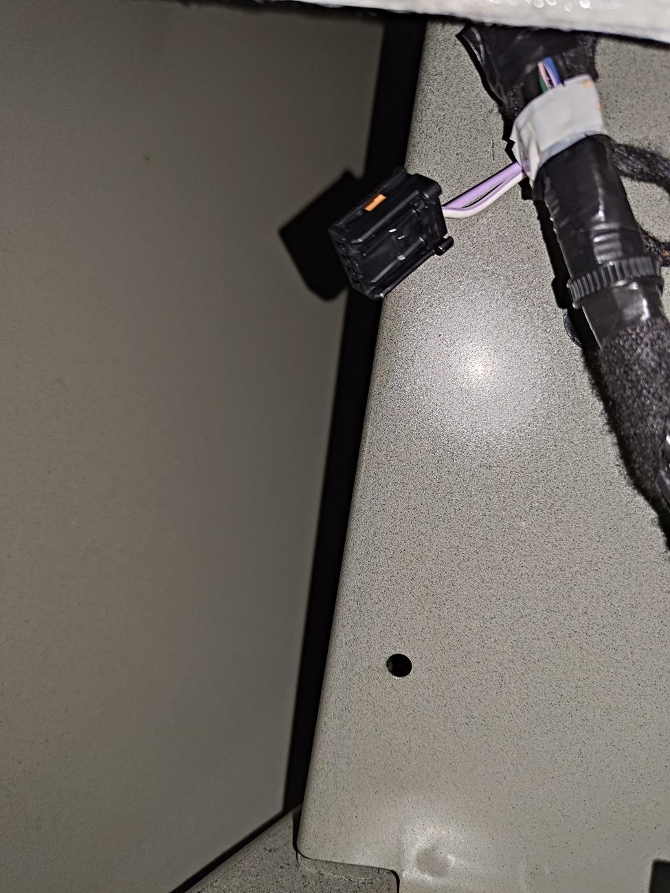

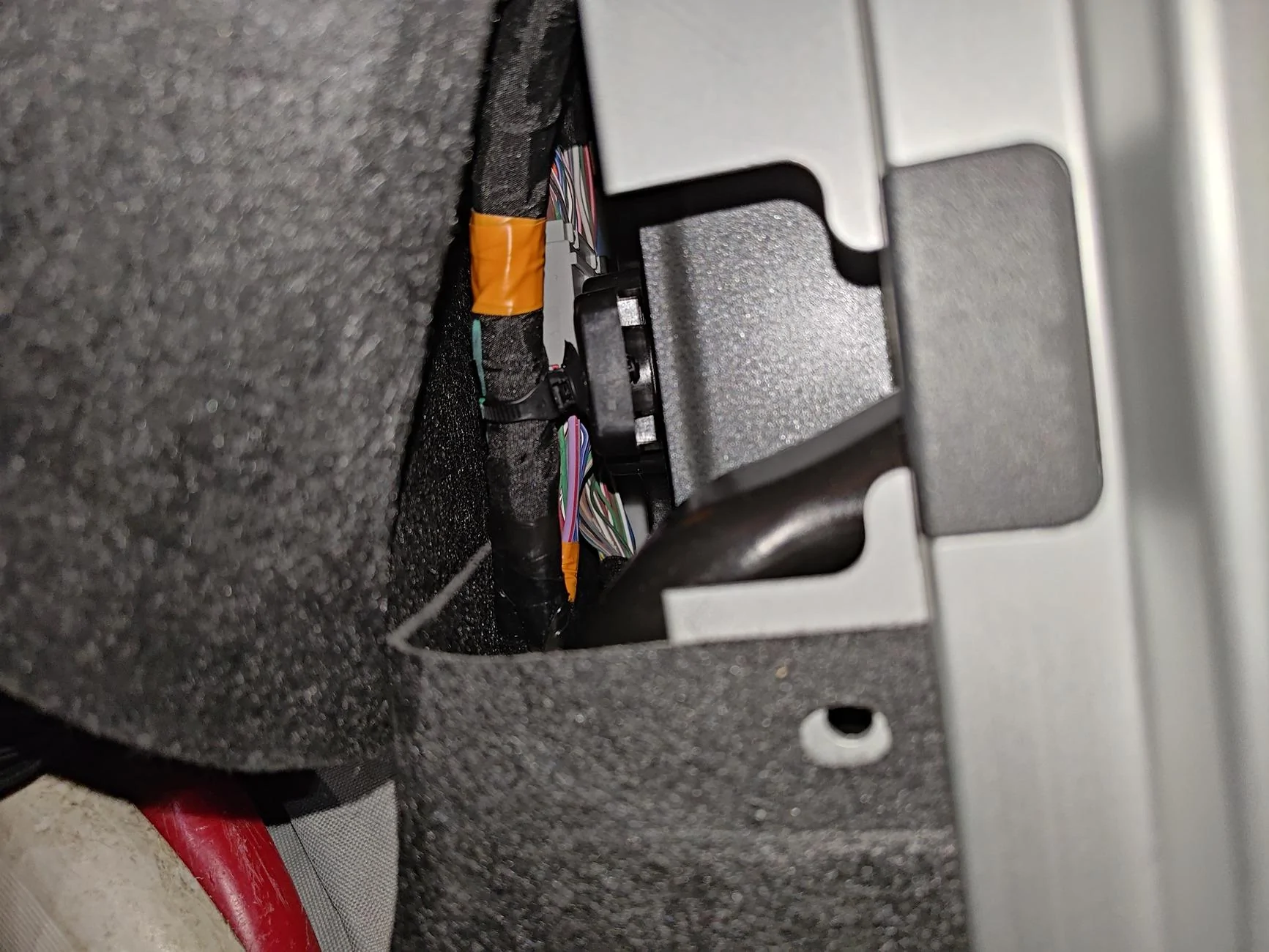

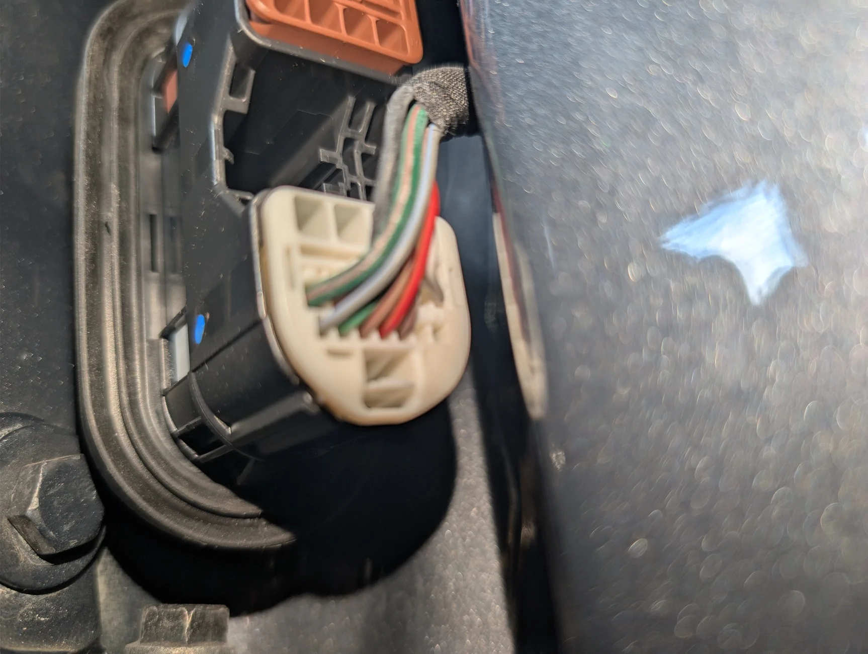

I tapped it inside the B-pillar on the driver's side using a military splice. I popped the grommet away from the body where the door harness enters the car. There was just enough slack to let me pull the connector out enough to work with it. I then used my scope to fish a speaker wire up to the tap location through a pre-drilled hole in the b-pillar. From there, ran the cable under the door sill trim, up behind the interior carpet trim under the 3rd row armrest and down into the storage well.
I should add that by tapping inside the ingress point, you ensure you don't compromise any of the designs Rivian has of keeping water out, you don't need to disassemble the door, and you don't need to mess with the amp harness (color coding is a hot mess, it's much farther away, there's an airbag around it).
