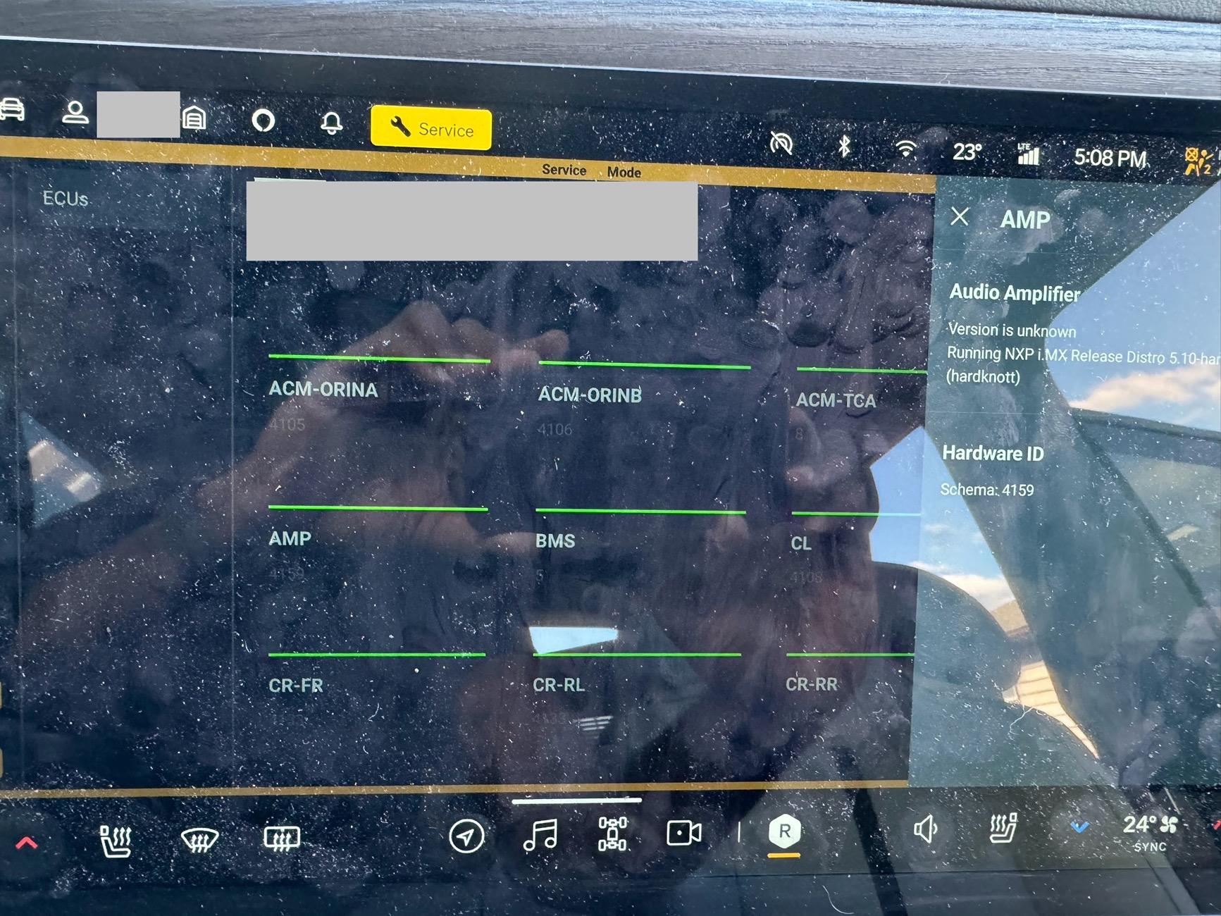

Is it a passive sub? And is it dual voice coil? If it’s dual voice coil then you should be able to wire it like this by connecting in parallel like this:
https://images.app.goo.gl/oevEmNfUAe2fwki79
Not sure as I didn’t break open the enclosure to inspect. Interesting that they might’ve gone from a dual voice coil to a single in Gen2. The dream would’ve been to get a Gen2 subassembly to plug in.
I’ll bust out a breadboard tomorrow to try connecting in parallel without destroying the connectors. It’s a long shot because even with the one coil connected we should still hear something, but the cone never moved at all.

Wondering... Have you looked into the RiDE menu to see if you can enable the sub connection there?
Just thought of this.
solaris
Sep 5, 2024
NY
yep, tried looking the other day. Nothing in any of the menus would help. It just displays health checks for each system.
