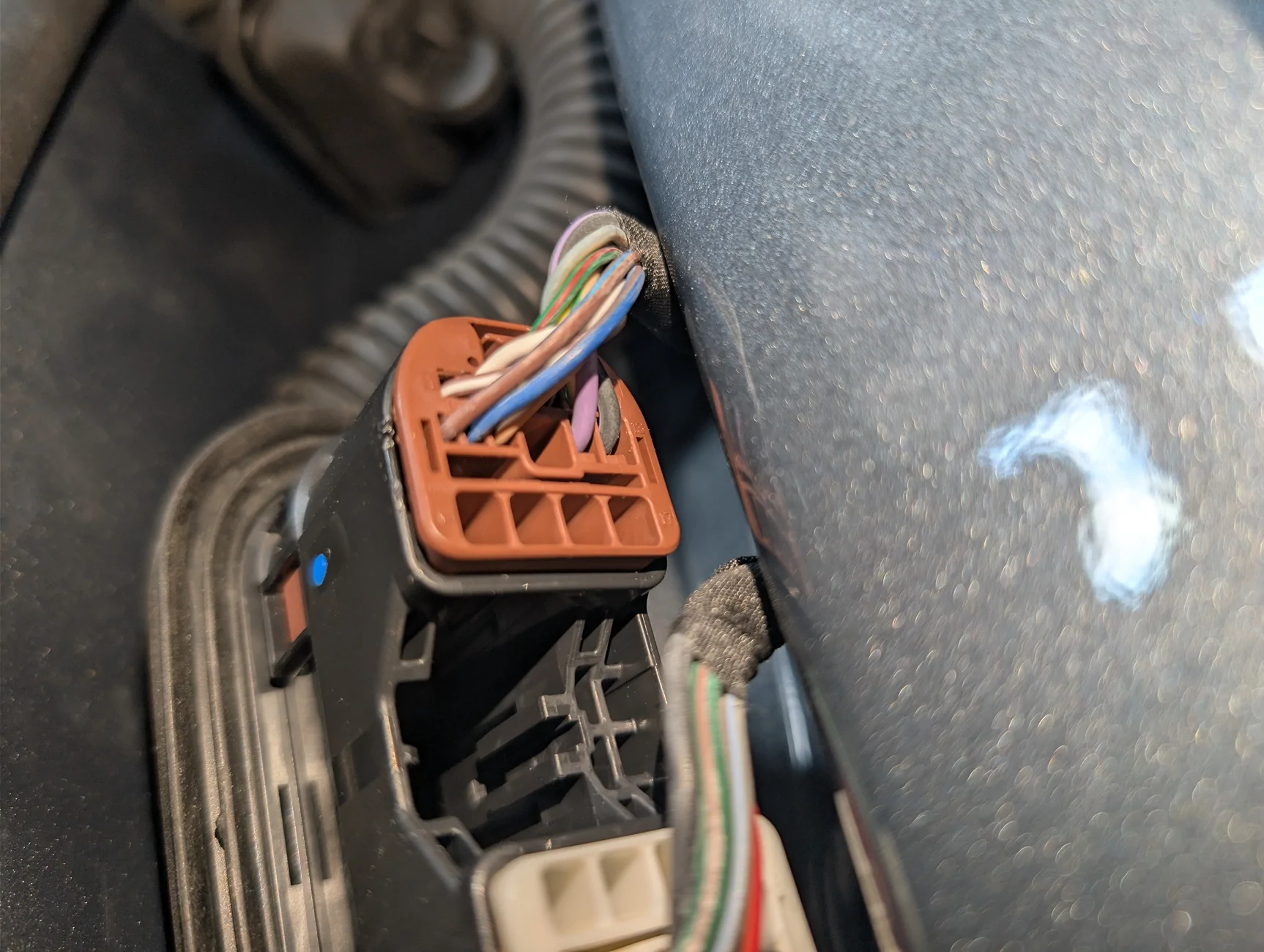

This is up under the passenger side dash. Orientation is connectors going up into the amplifier. Someone who isn't colorblind, can you find the two wires from the picture in the original post, in this picture?
Not sure what this means, but maybe the amps are the same between premium audio/standard, and it's just software/processing plus extra physical speakers that make up the difference?
I would be hesitant to physically cut the sub wires here since that's permanent. But this would also be an excellent place to tap an output to a wire than already runs back to *exactly* where you need it.

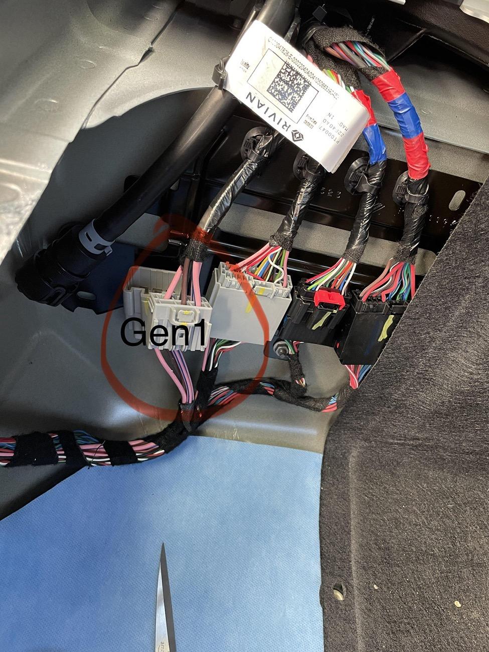

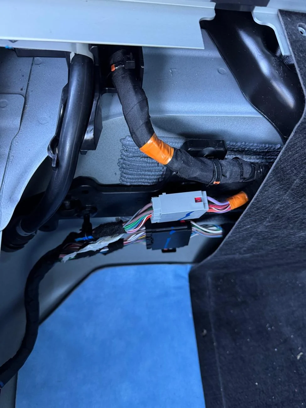

It also looks like the driver side wiring harness changed in Gen2. I’m not seeing the pink 12v trailer wire.
Rivian R1T R1S Diving Into Gen2 Standard Audio to Add a Subwoofer IMG_2601
In fact that whole molex looks like it was deleted. Gen1 picture below:
Rivian R1T R1S Diving Into Gen2 Standard Audio to Add a Subwoofer IMG_2604
I’m really trying to avoid going all the way to the front to get 12v for the amp, any ideas?

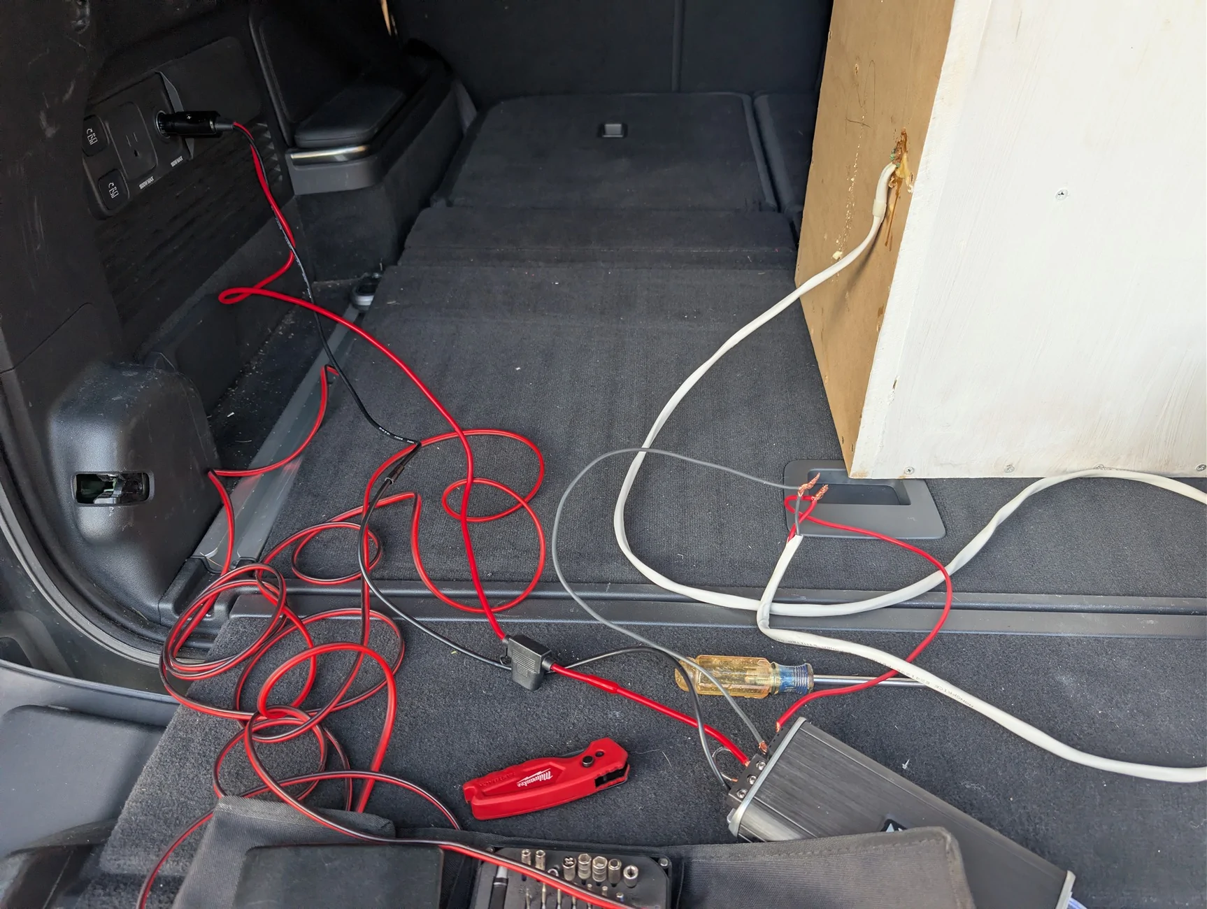

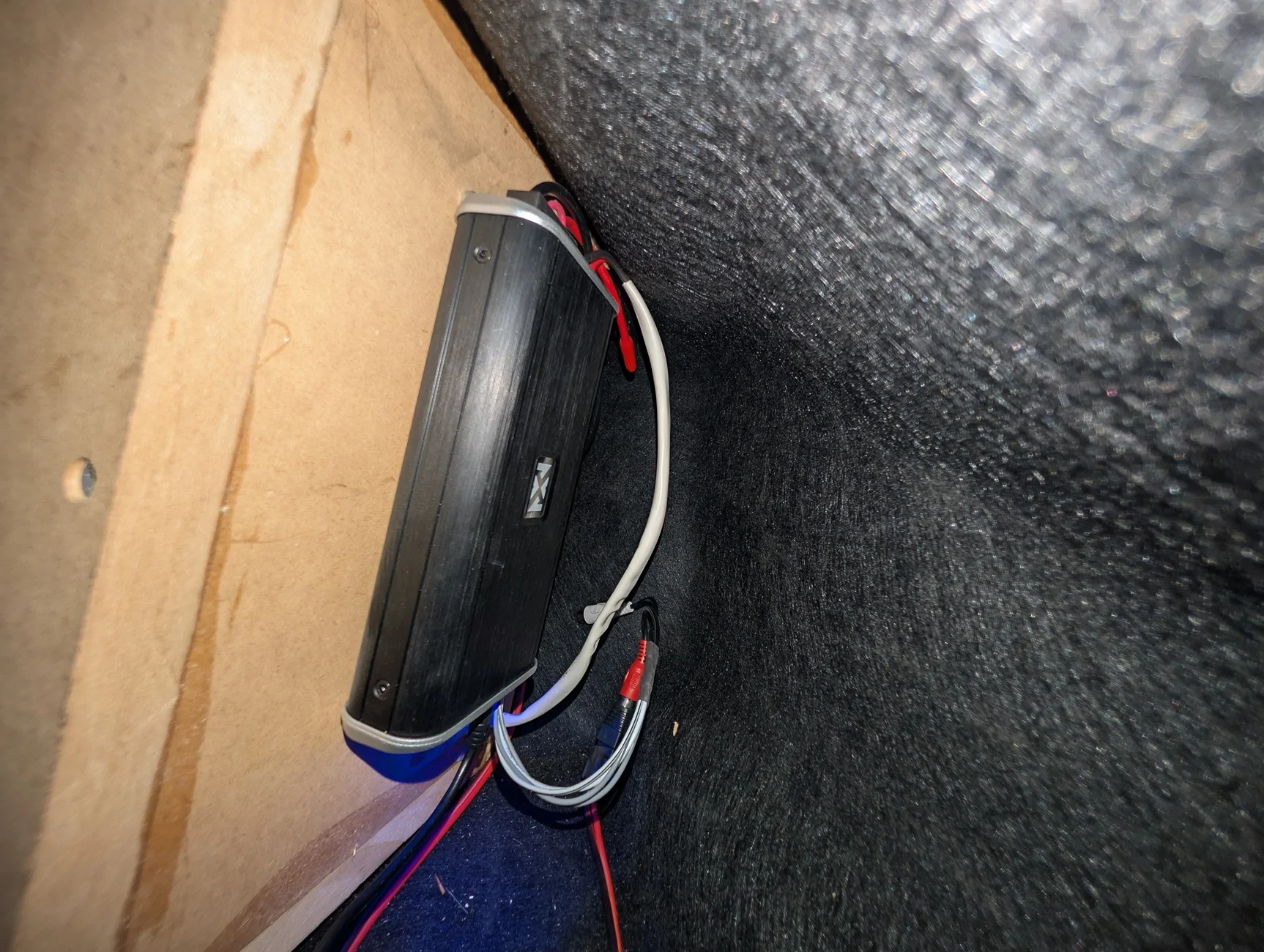

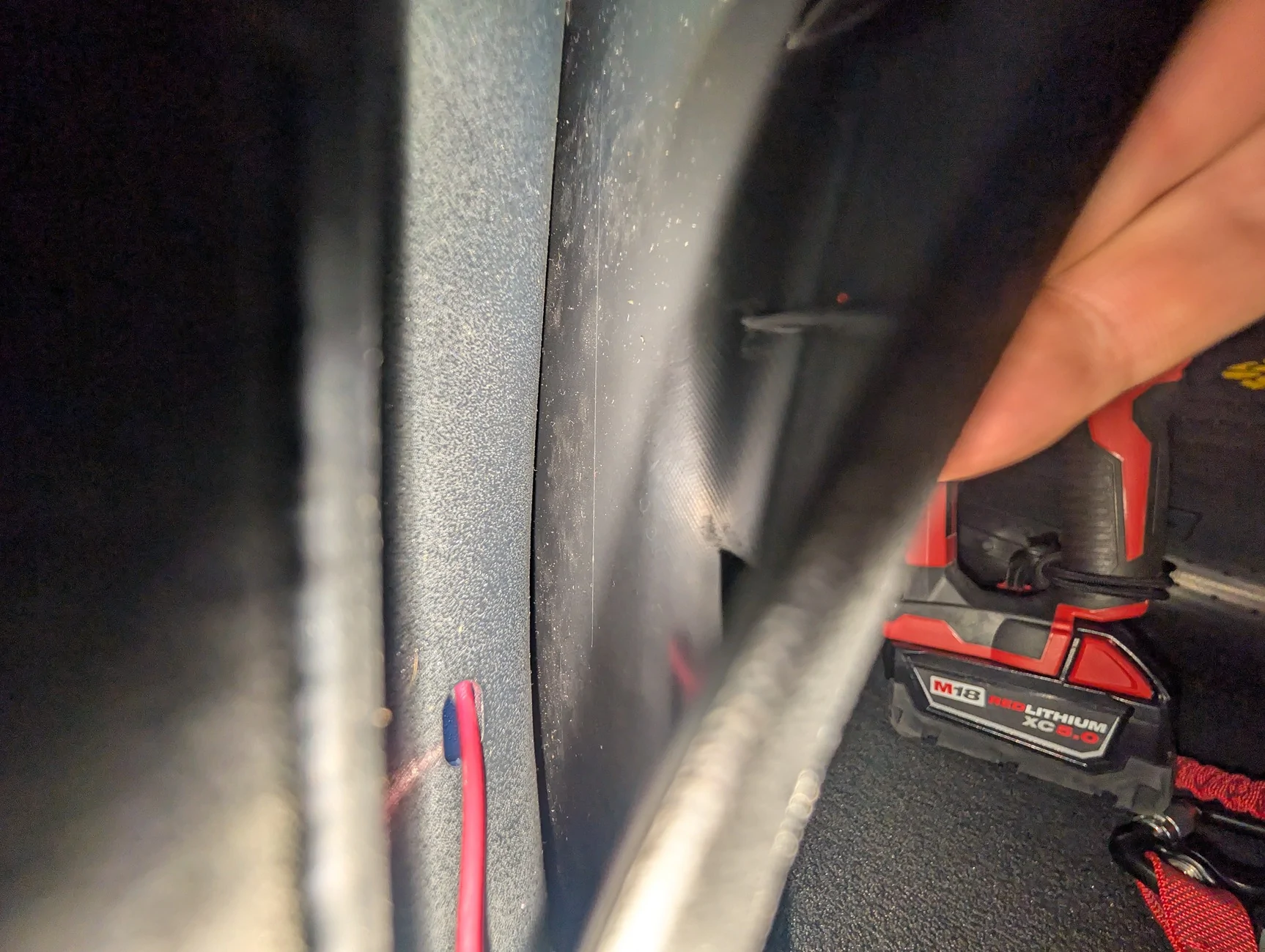

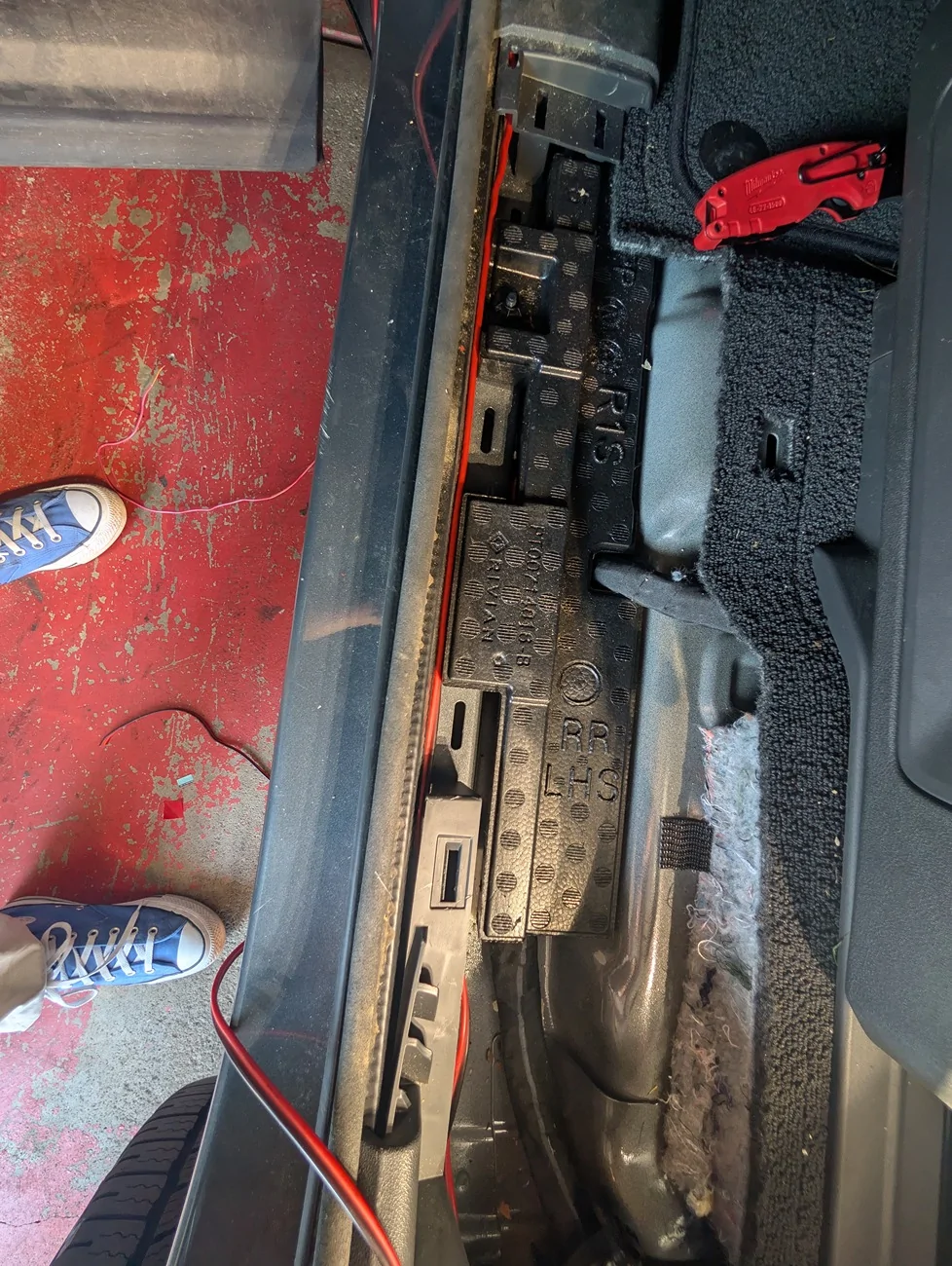

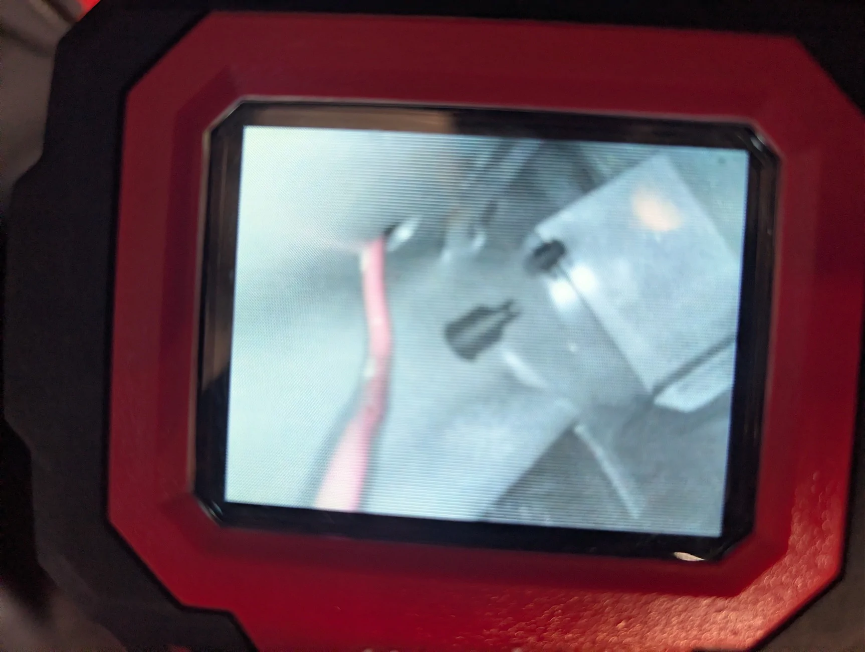

Update Time!
TLDR; tapped driver's side rear door for signal, 12v cig outlet is good enough for power, going to throw everything into a sealed custom box with the subwoofer manuals recommend size of .75 cubic feet. (19x12x7 roughly, but I'm going to contour it to the storage well)
Aight kids, very sorry for my lack of updates for basically the last year. Had some stuff happen and this wasn't a priority. But now it is.
Here is what you are seeing with the attached photos. Speaker level tap of the rear driver door speaker which according to a frequency analyzer is as full range as it gets with the basic audio package.
I ran a 16awg, pure copper wire from the *inside* of the door wiring harness. That way, once the splice is shoved back in, the grommet seals the hole as normal and there aren't any extra holes anywhere. The magic wires you want are purple/black and black/purple; or the bottom right two wires if you are looking at the back of the plug. The new subwoofer input runs down into the B pillar and through an already made hole (thanks borescope!), to then continue it's way under the kick panel, behind the carpet trim, under the rear carpet, and into the trunk storage well.
Now, here's where I'm taking some creative license. Car audio amplifiers are 12v, and there happens to already be an e-fused 12v supply in the trunk that is ripe for the taking. I was originally going to use the trailer harness which is good for 35 amps, however, I read/heard somewhere that completing that circuit could cause the car to think there was a trailer attached. So in big bold print, the cigarette lighter says 180 watts max. For the mathletes out there, that's 15amps @ 12v. Perhaps a bit light for a subwoofer, but A: we aren't going to any competitions, and B: peak RMS is hard to get to in the real world and almost always transient in nature (ie. not a constant draw). Certainly worth it for me to at least try this first. I will also note that the Rivian was putting out 13.4v in these tests so that's 200+ watts.
What you really want to read is.... everything sounded so much better with the subwoofer. Like, everything. Like, really better. In fact, when I was breaking everything down to clean up, I unplugged the subwoofer first and couldn't believe how the stock stereo sounded so naked in it's default state.
Equipment:
NVX VADM1 500 watt RMS (500@1ohm,350@2ohm,180@4ohm)
NVX SMW10D4 dual voice coil 350 watt RMS (2x4ohm posts, 2ohm when wired in series)
L2Ci, still on the fence if I need it, so TBD
Next steps:
Finalize connections
Build the actual speaker box
Enjoy

Update Time!
Equipment:
Next steps:
Enjoy

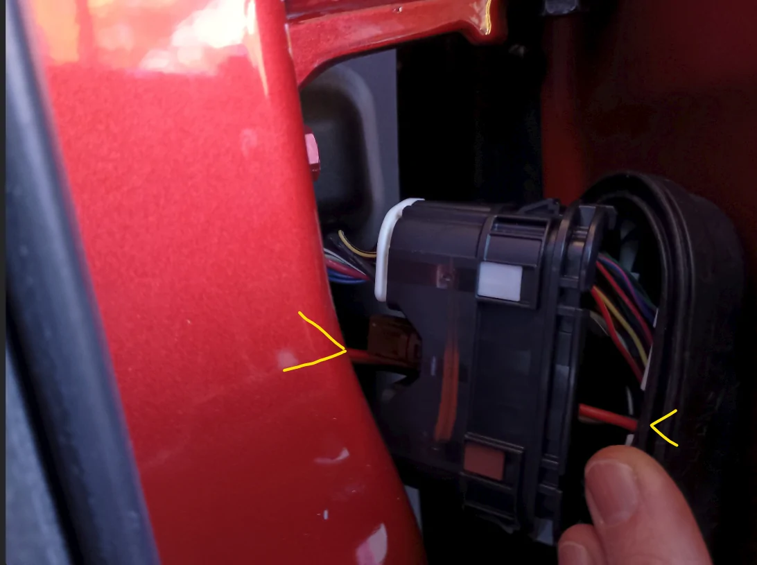

That's interesting. So there was no vacant space in the middle? The front door connector (looks the same) has vacant space in the middle. It also has a third connector there, that has the two coax cables for the cameras. I guess it's different. I pushed wires thru the front door.
I'm tapping the rear door, you may be referring to the front door harness. In my ear dyno, the rear seemed slightly louder. Being physically closer to the rear was nice as well so less wire to run.

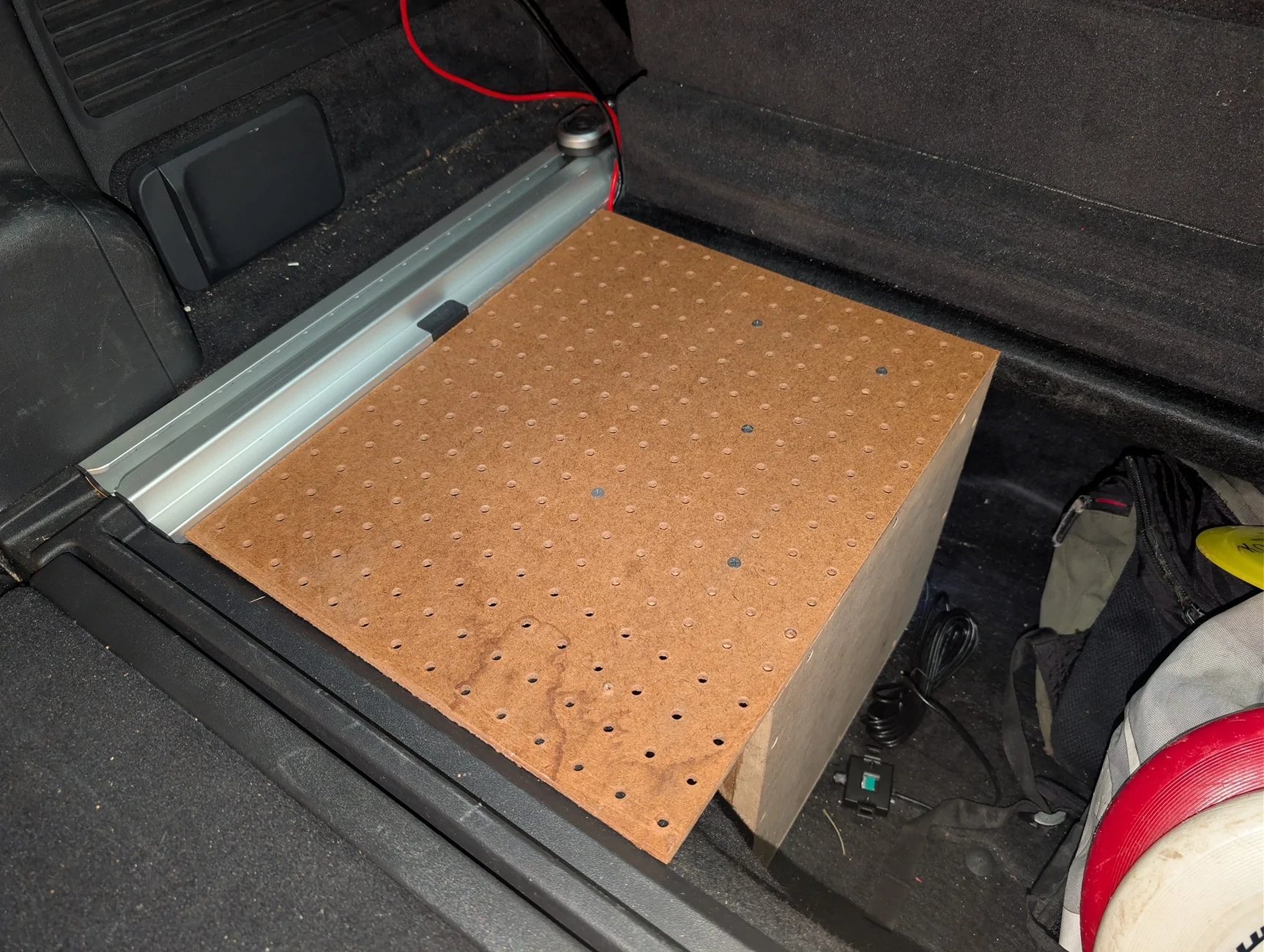

Getting close to final product. I'm going to add an additional cig lighter that goes under the storage deck but ties into the existing 12v socket. Going to fuse it at 15amps just to be cautious (again, 200+watts @ 13.5v). Confirmed that the 12v shuts off after 5-10 min of leaving the car locked so a 12v remote turn-on lead is unnecessary.
Solidifying the rear door speaker taps went well. Car doesn't seem to mind a little extra signal getting diverted.
The sound.... oh the sound..... on everything, is just night and day better.
Initial settings: Amp is set to roughly 2v on the input sensitivity, sub-bass crossover at roughly 30hz, LPF sitting at roughly 90-100hz. No gain, no bass boost. Also doesn't seem to be any bass roll-off to be concerned about. Besides, every frequency is unlistenable above volume 25. So for those thinking they needed a LC2i, I would hold off for now.
Sealed box turned out well at exactly .75 cubic feet as per the manual of the subwoofer. Going to use some marine carpet to clean it up a bit. The sacrifice of space is worth it, and the empty subwoofer cubby on non-premium audio makes up for it in about the same space, but with the added benefit of immediate access. Definitely not complaining about the extra resonance of the empty space in the storage well; icing on the cake.
To my knowledge, this is the first aftermarket subwoofer on a gen2 without premium audio. Hopefully this is helpful to others.
