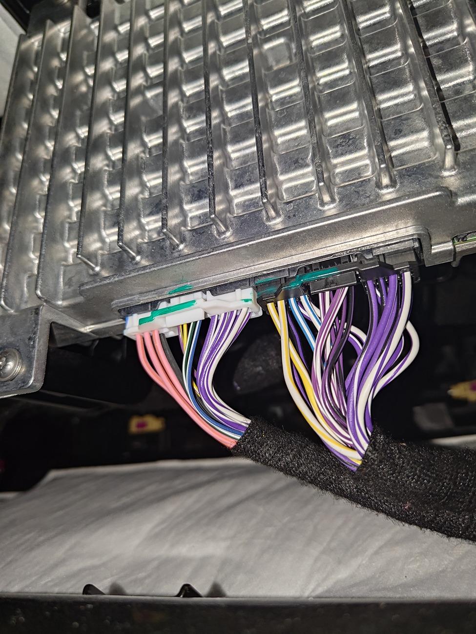

Seriously, it’s a lot of purple/white wires. In a static photo, where I can’t see both sides of the wire, I couldn’t tell which match well enough that I would cut anything.
Ok, I was afraid of that. It seemed like they all looked the same to me as well. So I guess next steps are to try and see if the 3rd row speaker is full range or not.

Looks like the 3rd row speakers are not full range. Best I can tell with a free app and an old ear, they might start kicking on at 80hz. So that's a lot of missing tones since the door speakers start making noise at 35hz.
I'm going to try and tone out the orphaned subwoofer connector and see if it ends up up under the dash at the amp.

Hey buddy..... Whatcha doing hiding up here?
This is up under the passenger side dash. Orientation is connectors going up into the amplifier. Someone who isn't colorblind, can you find the two wires from the picture in the original post, in this picture?
Not sure what this means, but maybe the amps are the same between premium audio/standard, and it's just software/processing plus extra physical speakers that make up the difference?
I would be hesitant to physically cut the sub wires here since that's permanent. But this would also be an excellent place to tap an output to a wire than already runs back to *exactly* where you need it.
Last question to throw out there, are we thinking the crossover is done through software or hardware? If software, then a full range tap would need to be on a door speaker. But if hardware at the speaker, it could be done at any speaker.

I'm told that's it's pretty heavily software configured. Like, for example, it might even be shared between base and premium audio. So while the subwoofer wire is terminated there, the software has it turned off. IMO, tons cheaper to have a single wiring harness with all the connectors you'd need for every option than to have half a dozen based on spec combinations.
