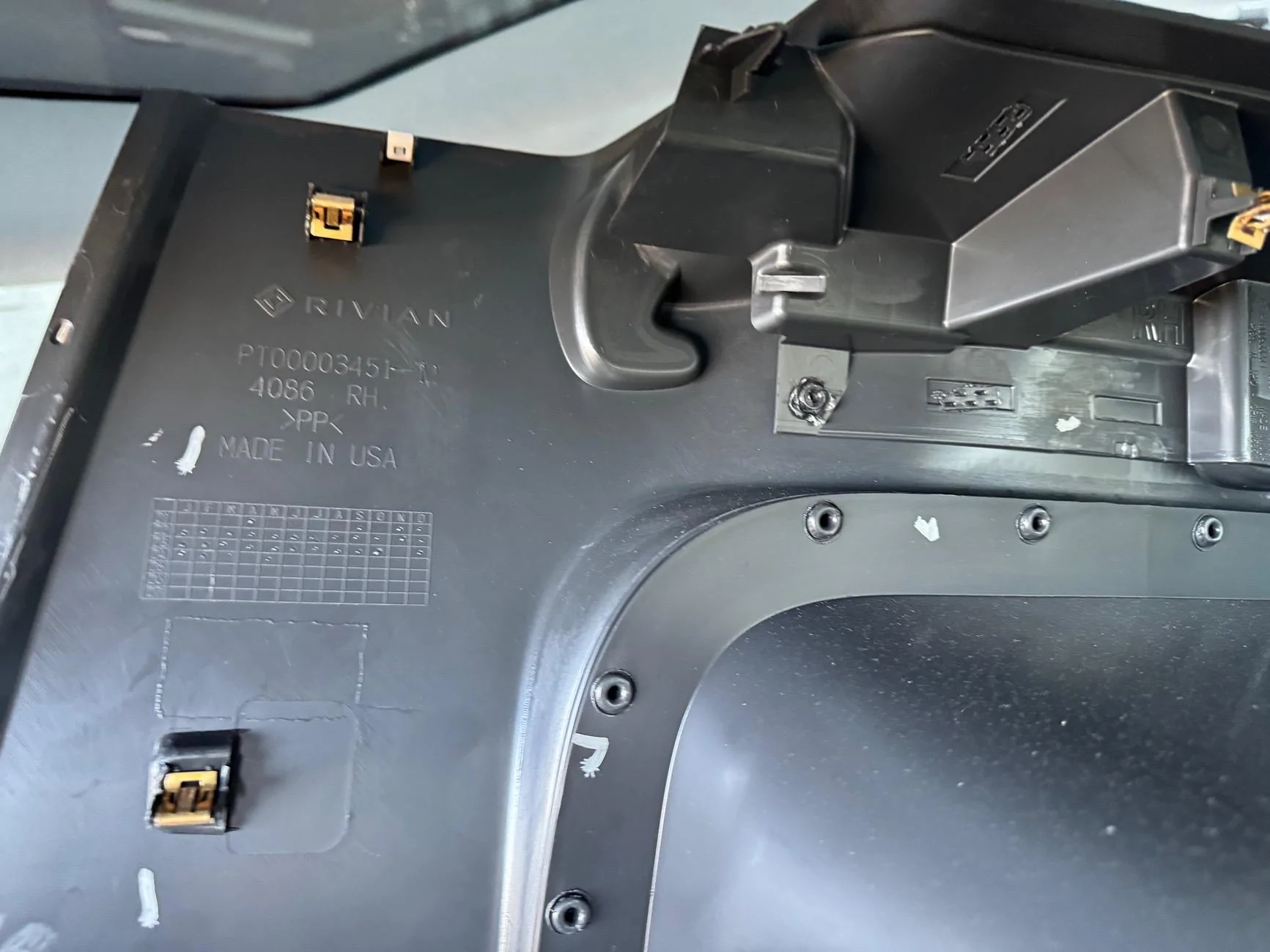

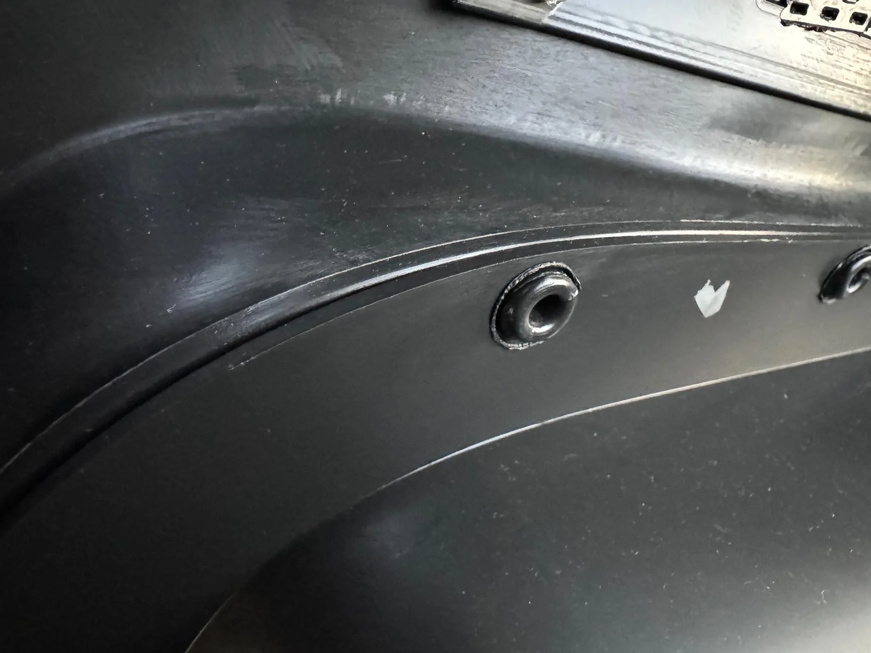

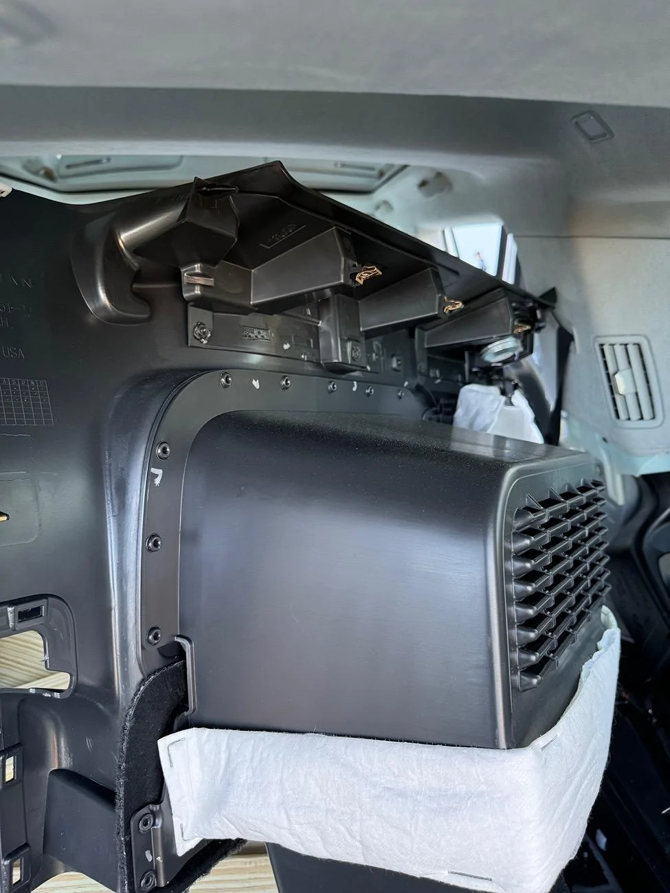

Does the trim piece in the Gen 2 standard audio, that creates the cubby where the sub would be pop out or is it all part of the larger panel?
It’s part of the larger rear quarter panel trim (PT00003451-M). On my Gen2 it looks like it’s riveted with plastic welds. It’s removable but destructive and non-reversible.
Rivian R1T R1S Diving Into Gen2 Standard Audio to Add a Subwoofer IMG_2126
Rivian R1T R1S Diving Into Gen2 Standard Audio to Add a Subwoofer IMG_2107
Rivian R1T R1S Diving Into Gen2 Standard Audio to Add a Subwoofer IMG_2113
It doesn’t look like the part has changed from Gen1, attachment points and other trim details look identical so to keep a stock look we’d have to acquire the Gen 1 part: PT00003451-L.
I may just 3D print a replacement grill and glue in place rather than get a whole salvaged quarter panel.

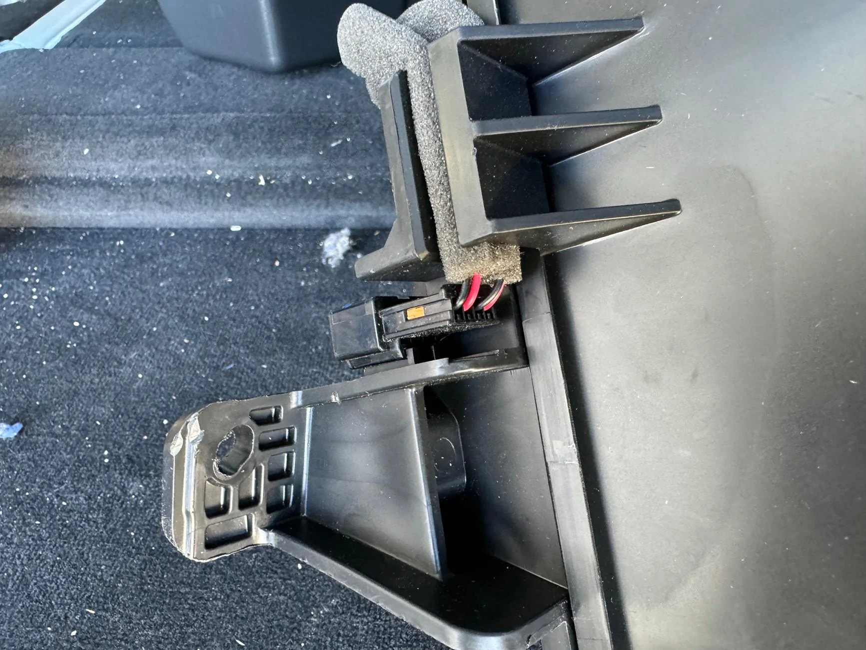

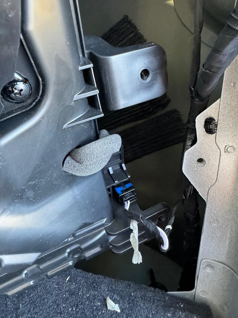

The sub wire back there is software locked at the moment. No audio signal is passed to it. So in order to use it, you'd need to nap a full range door speaker at the amp and physically disconnect it from the amp so as to prevent problems should it ever activate in the future.
I ordered a Gen 1 subwoofer subassembly (PT0002995-D) before seeing this :crying:
Rivian R1T R1S Diving Into Gen2 Standard Audio to Add a Subwoofer IMG_2135
Can confirm, no signal when connected. Even did a full reset to see if it would pick the sub up on rebooting, but no dice.
Rivian R1T R1S Diving Into Gen2 Standard Audio to Add a Subwoofer IMG_2134
I did notice the Meridian subwoofer connector has all four pins populated with wiring, could there be more intelligence behind the software lock? As in, it probes and disconnects if not the right type of speaker?
