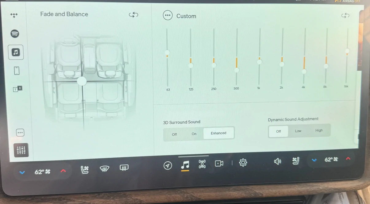

by jove i think you nailed it Z. we have a G1 w Meridian and now a G2 Tri. ive been "forumizing" for months on this and playing with the EQ realizing it was certainly not going to end up w a "convential" curve shape on the levels. I just tried your settings and went from G2 to the Meridian and on most tracks, it is near impossible to tell diff. not exact match yet mostly in the "presence" and separation but i over compensated on the "fade/balance" to be just off the rear of the driver's seat and it is much much much closer. crisp , clear while bass is punchy not muted.

Do you mind expounding on this part? "over compensated on the "fade/balance" to be just off the rear of the driver's seat" do you mind showing a picture of how you have it set? I already adjusted the EQ bands, per zendavian's recommendations, but if this helps also, I'd like to adjust this as well.

Sure here’s pic . I moved the fade balance dot to a spot behind the drivers seat and over right shoulder to help the imaging that was more front dash and right sided
Btw total accident and not practical but I was moving a large item in rear seat yesterday so slid the drivers seat forward . That was interesting as it helped ;).
as others note , the $ of the truck has us all speaking up on the sound quality/experience but I’ll find a way to make lemonade and w Z’s adjustments , I’m not thirsty much more ;). Yes if I replaced the woofer w JL and doors w Focals would it be better ? yes .

It’s so variable! Moving the seats changes so much. Focals would be amazing for sure. I’d love to get your thoughts on the updated settings I just posted, you seem to have a great set of ears and am really enjoying your reference tracks!

im going to play with your latest setting adjustments. was skeptical on the default fade bal but it did change things quite a bit on that brassy harshness for the better even more that you nearly removed on last settings!
to me the 16k at 0 is a good move when the 3D is on. I'm not one for the 3D but hey we paid for those little speakers why not turn em on! :)
