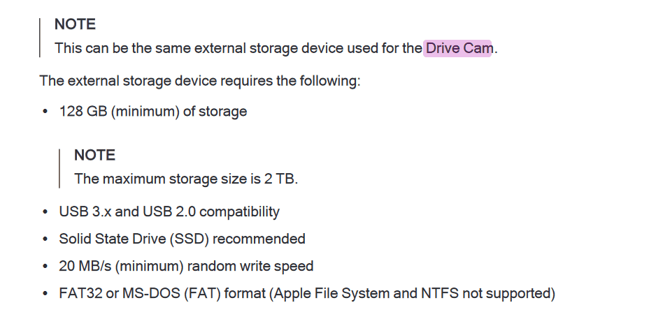

Owner's Guide Gen 2 specs. R1S records 4 cameras in both Gear Guard and Drive Cam modes. Do we know the difference in resolution (edit: and encoding can make a big difference) between Gen1 and Gen2?
A 256GB is fine for my R1T (5 lowish res cameras). I'd probably get at least 1TB for a Gen2 (or go 2TB, which is max) assuming there's no big premium in price.

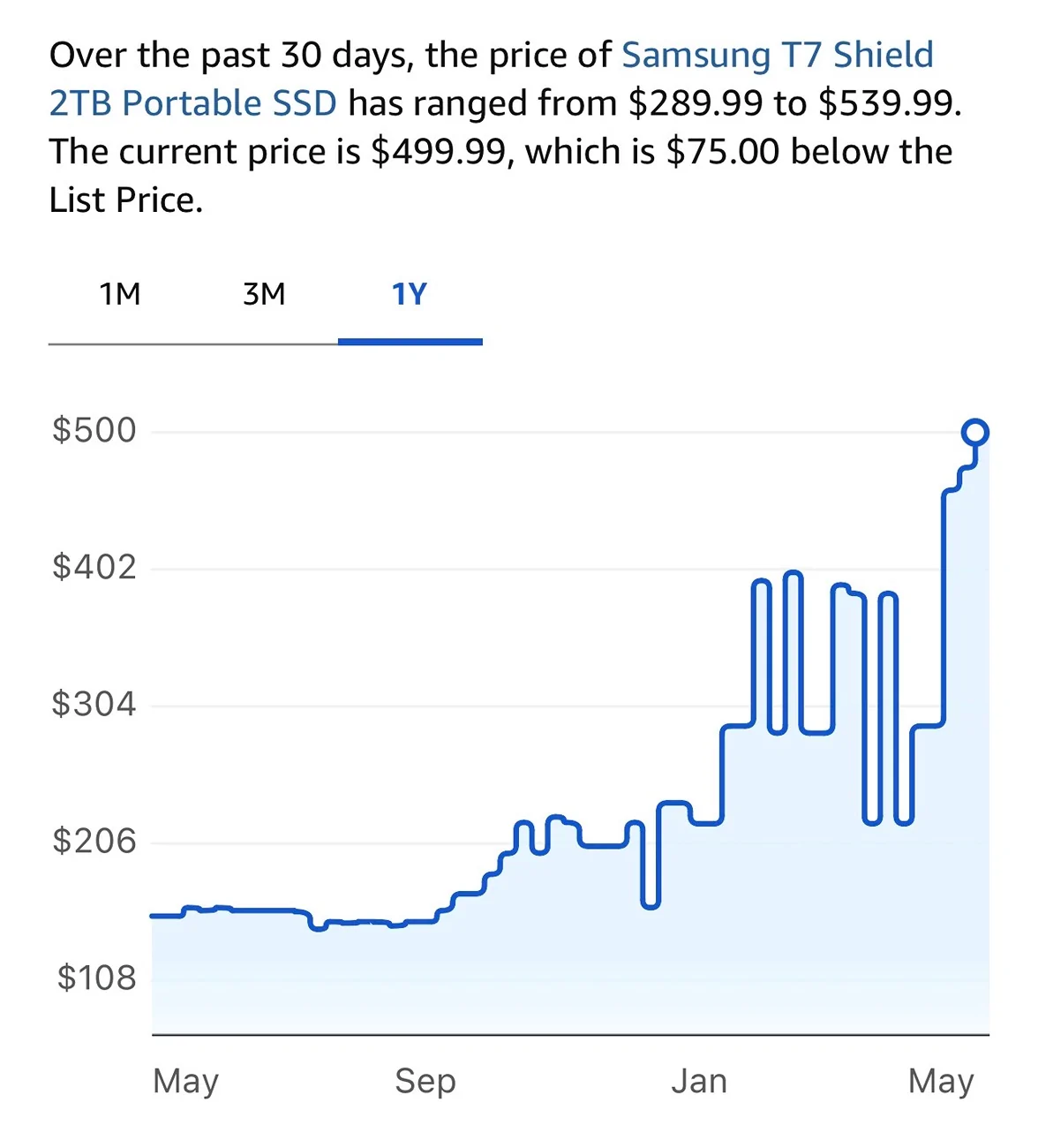

Just for fun - May-2026 and the Samsung T7 is $500 on Amazon :oops:
You can thank all the AI data-centers for driving up the price of ram. I just bought a 1 TB T7 from Amzn resale for $250 for the R1T. I was planning to build a new PC, but I think I will make mine last a little longer.
