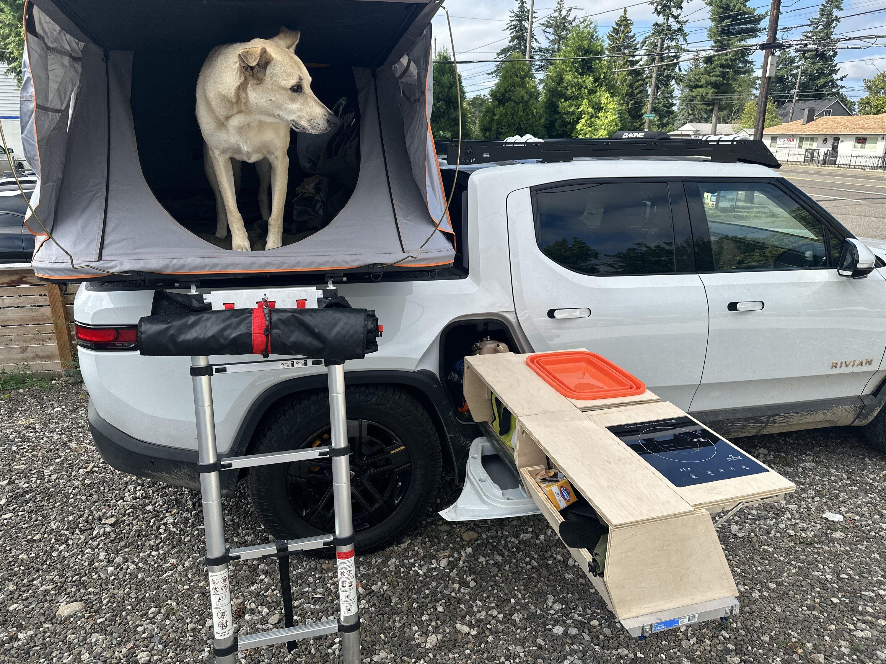

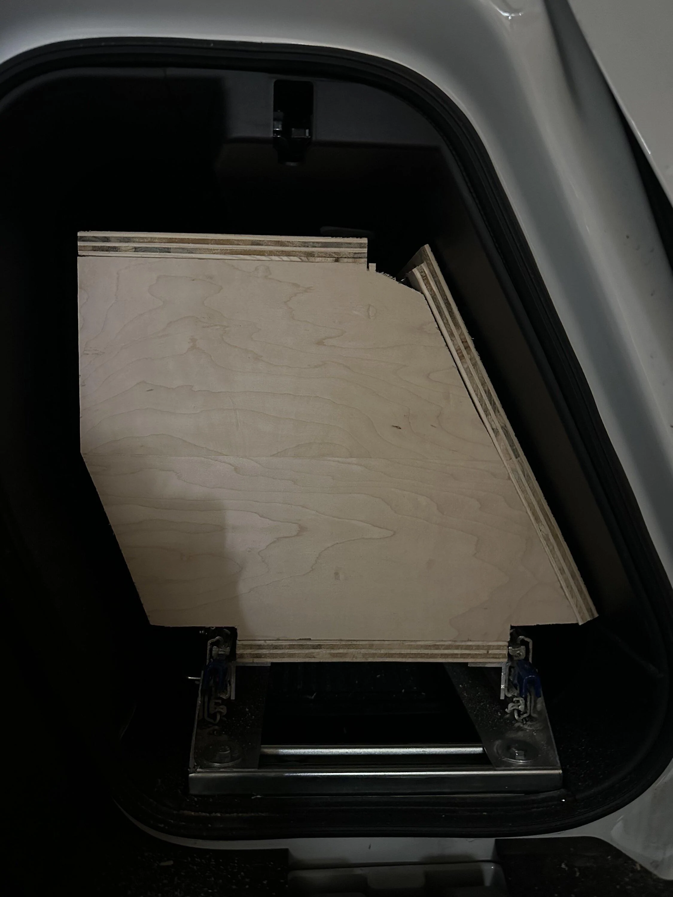

I have so much sawdust in my eyes right now.
have a couple weeks of multistate camping that I didn’t want to cook like a non camp kitchen having peasant, so I’m building a rough set with my v2 slide

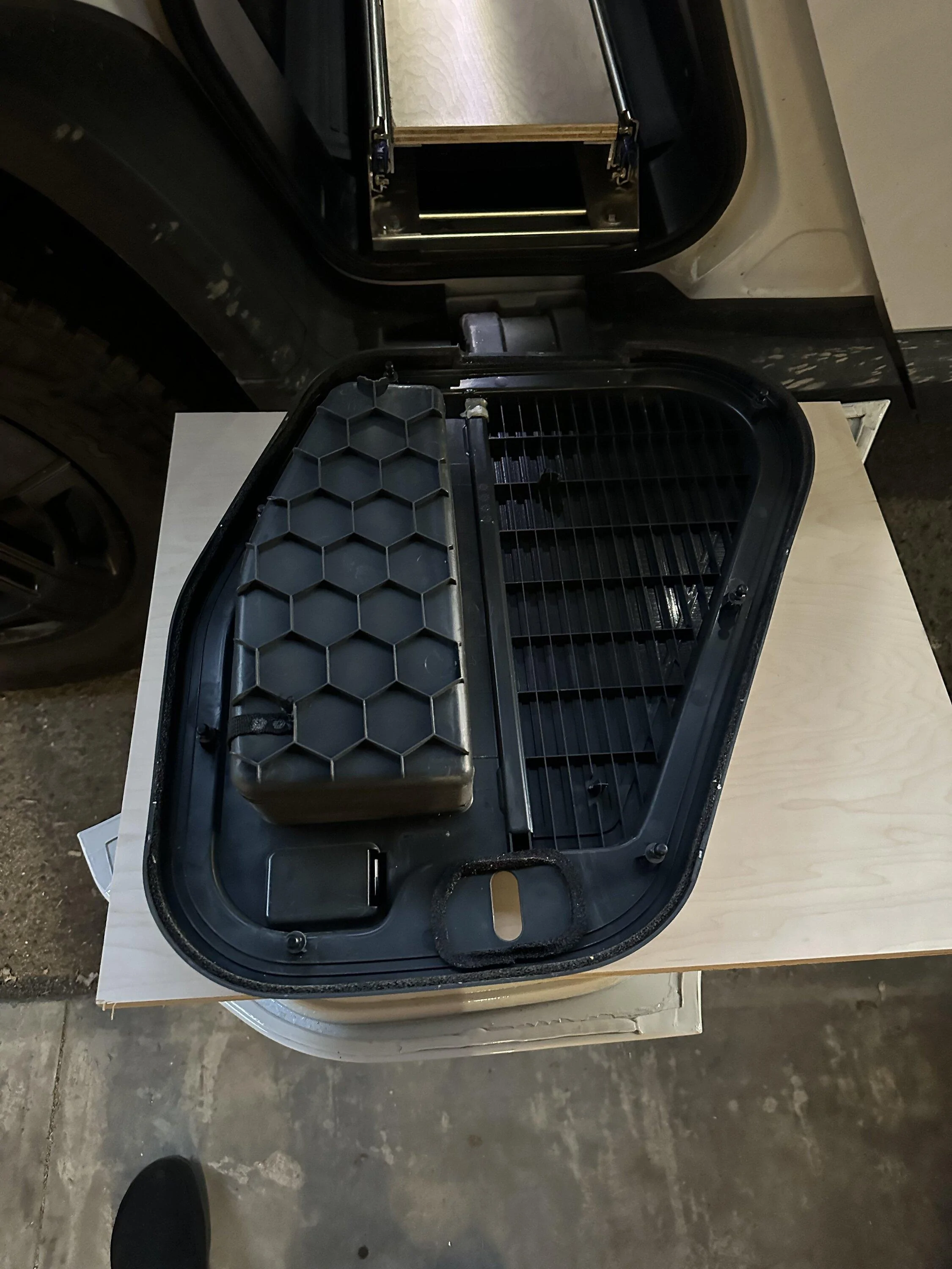

The plastic comes right off of the gear tunnel doors , so making a good template it easy
Rivian R1T R1S DIY Gear Shuttle Build Write-Up Instructions w/ Photos IMG_0975
So far this is where I’m at
Stove box half done, need to add the drawers to the other side still

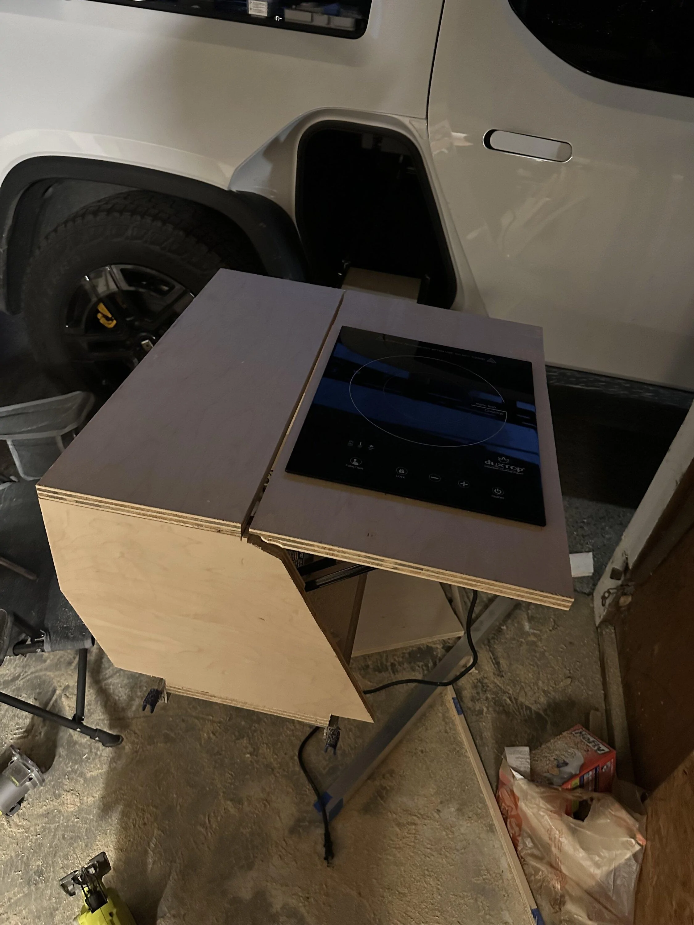

Rivian R1T R1S DIY Gear Shuttle Build Write-Up Instructions w/ Photos IMG_0987
Rivian R1T R1S DIY Gear Shuttle Build Write-Up Instructions w/ Photos IMG_0988
using plywood and pocket hole joinery, not framed with extrusion like the only couple builds I’ve seen so far.
I thought I’d get spicy and play around with some rabbits to make a super smooth transition, but then I didn’t have the right router bit and my tolerances were too tight and I failed to account for the physics of the hinge I have

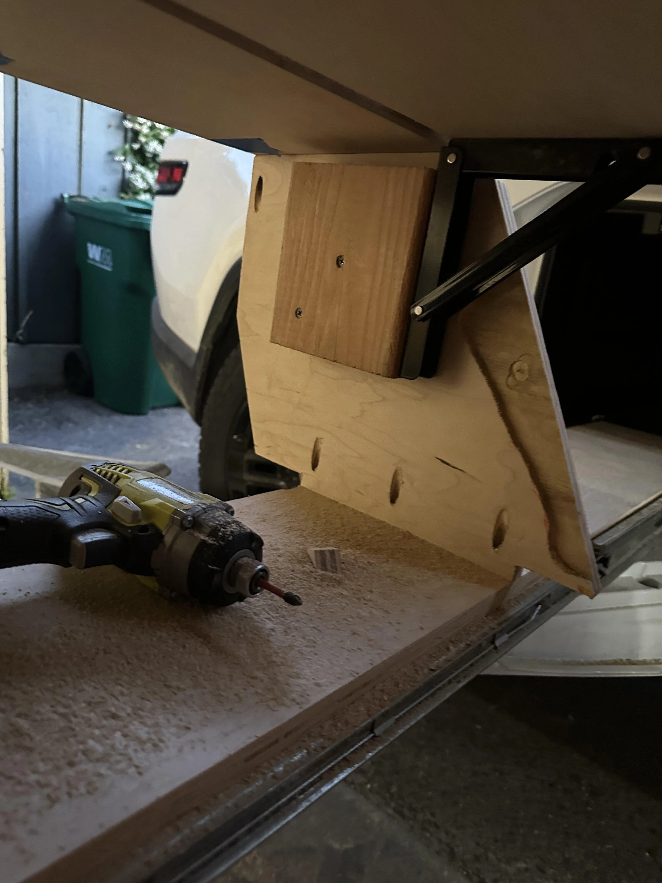

Rivian R1T R1S DIY Gear Shuttle Build Write-Up Instructions w/ Photos IMG_0984
had to make some rough relief cuts so the plywood could connect to the drawer
And the hinges wouldn’t cooperate so I gave the top side a bad haircut as well
Routing the side panel reliefs for hardware clearance is something I’ll keep moving forward, with a straight edge to clamp against instead of freehand/eyeballed like this one
Rivian R1T R1S DIY Gear Shuttle Build Write-Up Instructions w/ Photos IMG_0985
I’m realizing that a framed interior is likely the better option, I figured traditional cabinet making methods would allow me to maximize drawer width in the box, by mounting the hardware directly to the box skin, but I forgot to account for the surface I would need to mount the shelf hinges to for the coon surface and had to add back in some corner brackets (scrap 2x6 in the photos)as even with a proper box built out I had to add spacers and interior frame pieces to mount the hinge hardware to, which means the drawers slides would also have to be mounted on that piece that is used for hinge mounting, which is unfortunate.
I think a frame of 1010 with the side plates mortised out will be the best of both worlds
and allow me to lose the stupid relief angels I had to add.

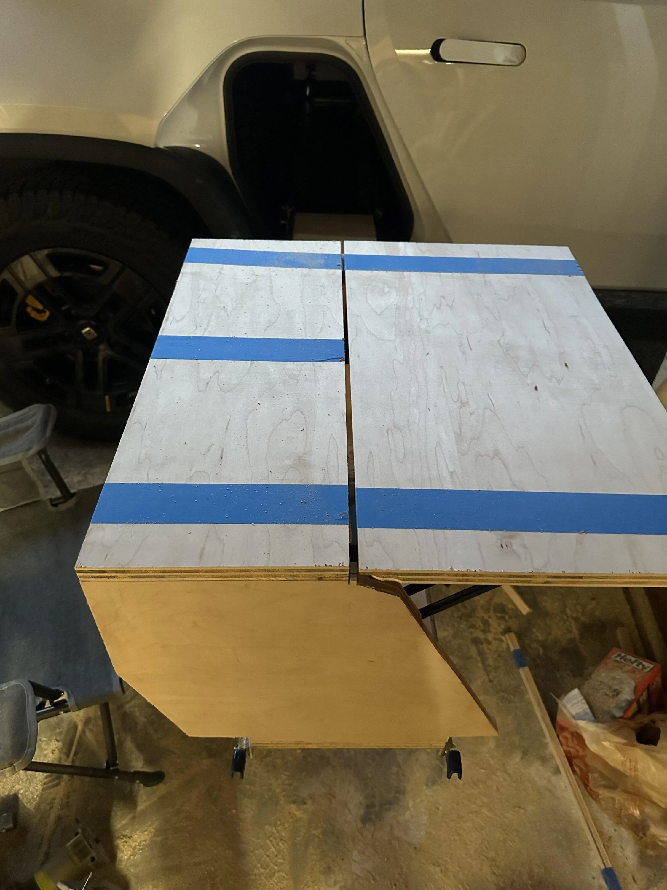

Only in an extra $96 bucks for the wood
(3/4” birch)
But I was able to get it cut in the store and have enough for the drawer platform itself(no more osb)
As well as have cuts for 4 side pieces (the polygons)
two top plates roughly 10x 24
Two countertop plates 14x24ish (one for the stove one for the sink)
4 pieces for drawer faces

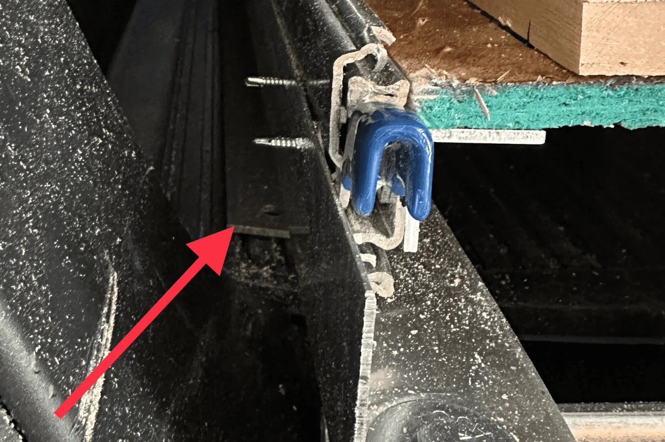

I have seen a lot of cool DIY efforts that reminded me I never really shared some of my experience, which in the process can probably help folks save some money and optimize build dimensions
I have slowly been optimizing my gear tunnel build.
Key points of concern for me when making my DIY solution were:
-Minimally destructive (Rivian gave us 6mm bolts to mount into!, not destructive at all unless you damage a trim clip)
-Less than the Rivian teased shuttle in cost (materials only)
-Easy enough to share plans/ build steps with
-Parts are available for purchase readily
-Maximize usable space
*Have drawer slides oriented in the proper position, not flat or off camber, like the OEM ones that never were released.

Where do the 8" sections of lower profile Unistrut go? I am assuming the 10” fo on the ends.
Do you have any supports that run the length of the shuttle, or is it just the two 2” angle pieces? You have one picture (with the self-tapping screws sticking out to the left) that looks like there may be a support or something.
Thanks again!
I hope it’s helpful!
So the unistrut is two stacked on each side, I’ll get pictures tomorrow showing how/why I did that
There is no additional bracing done mid span, for the thinner angle I accidentally used it was iffy, but ensuring you buy 1/8 instead of 1/16 with eliminate any play in the 64” long parts
Even with the thinner angle once it was fastened to the slide itself it has no movement.
that piece you are pointing to is not connected. it is either An offcut of the angle or my larger aluminum ruler

I decided to not even use a full length of angle for my bed storage slides, the slider itself gives it all the strength it needs in that direction. Good chance I'll do the same thing for the gear tunnel slides since it'll make installing everything easier, just being able to do one side at a time. Those 64" sliders are really heavy.
I couldn't agree more!
Now that I have the extrusion I wanted I'm going to be measuring/cutting the angle aluminum to only need one piece for the whole slide setup, utilizing the slide hardware as a bit of a "stressed member" since like you mentioned, it is so incredibly robust

long winded review or my progress and mini shakedown drive to Portland coming s00n
But here’s a teaser for the visual learners out there
Looks fantastic! Unrelated - is the dog able to get up there on their own? Or do you have to help them? ?
Thanks
Yes, the Beanstermeister can get himself into the tent on his own
the bit rolled up at the top of the ladder is the doggo rtt ramp from Desert Armor.
That unrolls and straps to the ladder to make a walkable ramp.
Here it is deployed
So let me see if I can understand this. You’re planning on only using one 2” angle to mount the sliding rails to the Unistrut? I would imagine you would cut maybe two 1’ sections for each of the slides to mount them to the Unistrut?
I would imagine you could also do the same with the 1” angle to mount the sliding rails to the wood panel.
I’m trying to minimize my shopping list to reduce cost and also weight, but I also want to make it as low of a profile as I can.
HighVoltOverland
HighVoltOverland
Jul 6, 2021
752
1,564
Laguna Beach
GW/OC R1T | Tesla MY
Retired-ish
Correct
But I’d say take it a step further
Don’t buy the 1”angle
Use the same size angle for everything
Only reason I ever used the one inch was I had it laying around
Using the 2” angle would help avoid making the platform too low and having to deal with avoiding the top of the slides as well
So the buy list should be one 2” x 1/8 x96” angle aluminum and one “skinny” unistrut
