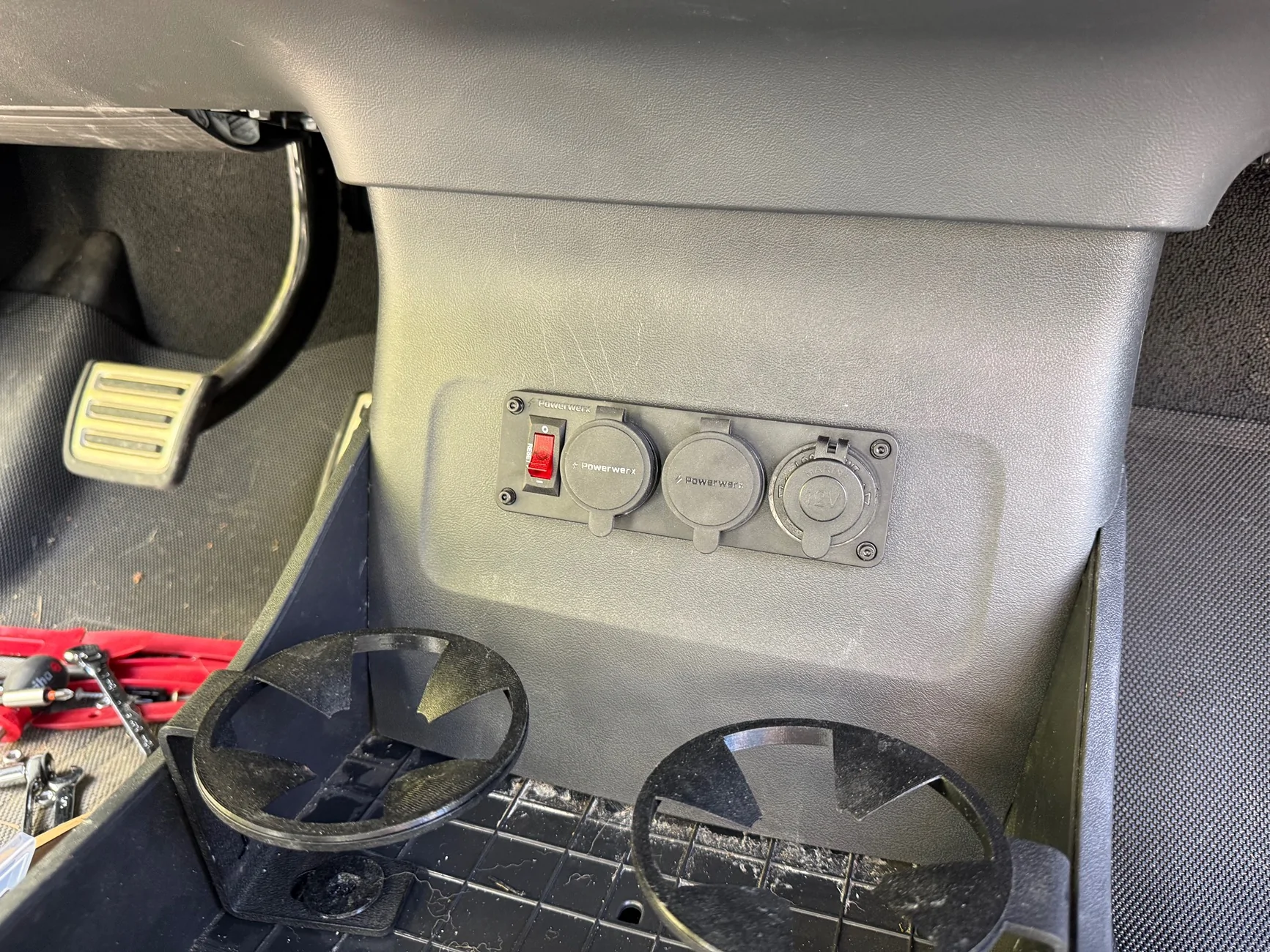

Adding to this thread with a thanks for the great advice. In my late gen1 r1s I was able to get - on the metal frame, but it is not am m6, I have no idea what it is, but I had a bolt that fit that hole and got the the same post up under the passenger side for +. I found it hysterical that the easiest way for me to work under there was to put the window down and put the left foot up there and my right foot on the door handle: it was not that uncomfortable. HAHAHAHA! I went with this setup because that switch is also a circuit breaker. All of this from Powerwerx. Right is a cig, the other 2 are pd usb-c can run my starlink and laptop as well as usb a. I now can easily charge CB and other things, finally!
It was easy, but I am not as clean as you all, so thank goodness for the faceplate covering some sins! Took maybe 90 min total and part of that was the classic, "this is a project that needs not dogs..." and they kept nabbing my screw drivers. Going to scrub some light scratches out and call this one a win!
Again thanks to those who shared helpful notes!
