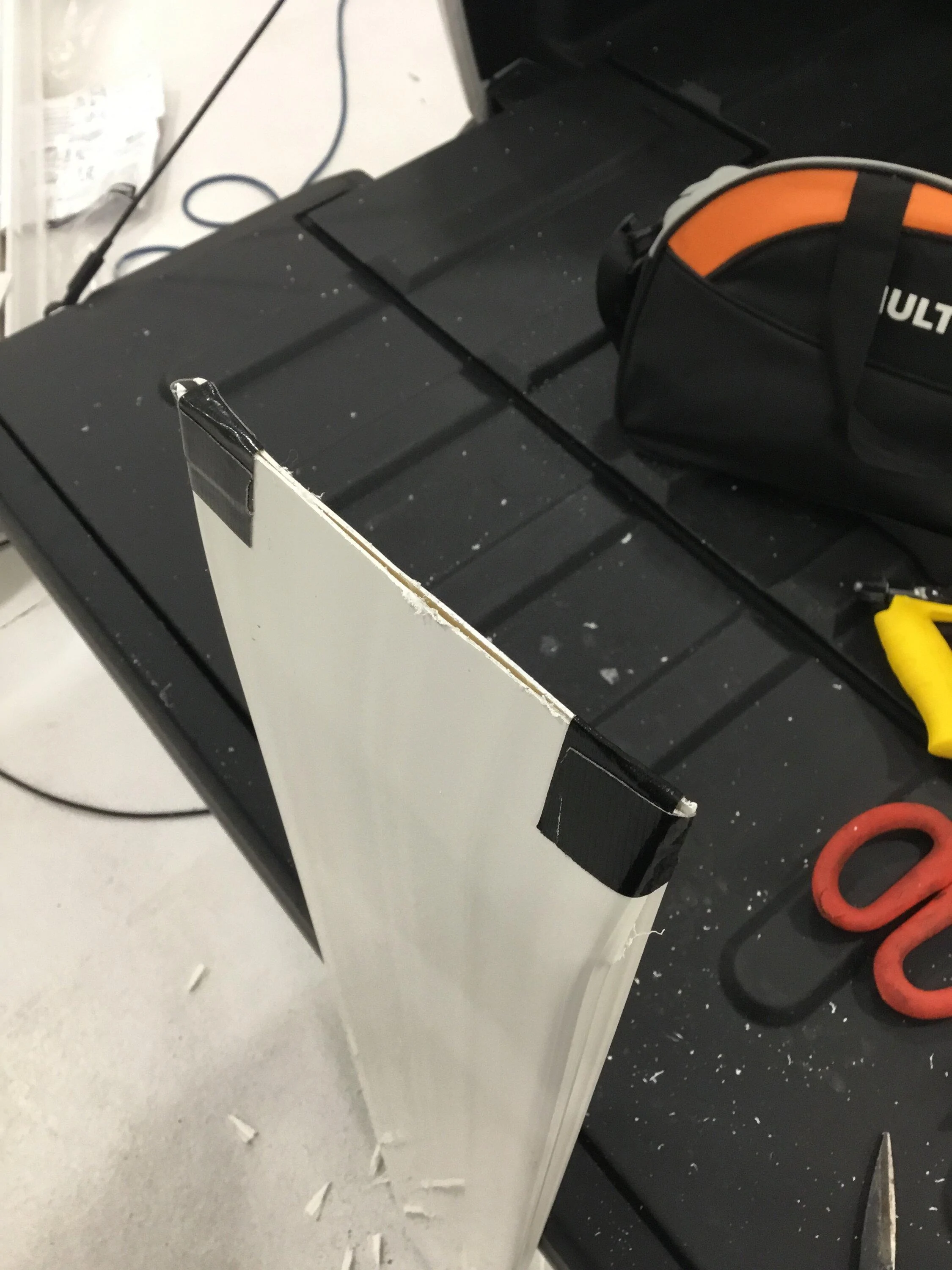

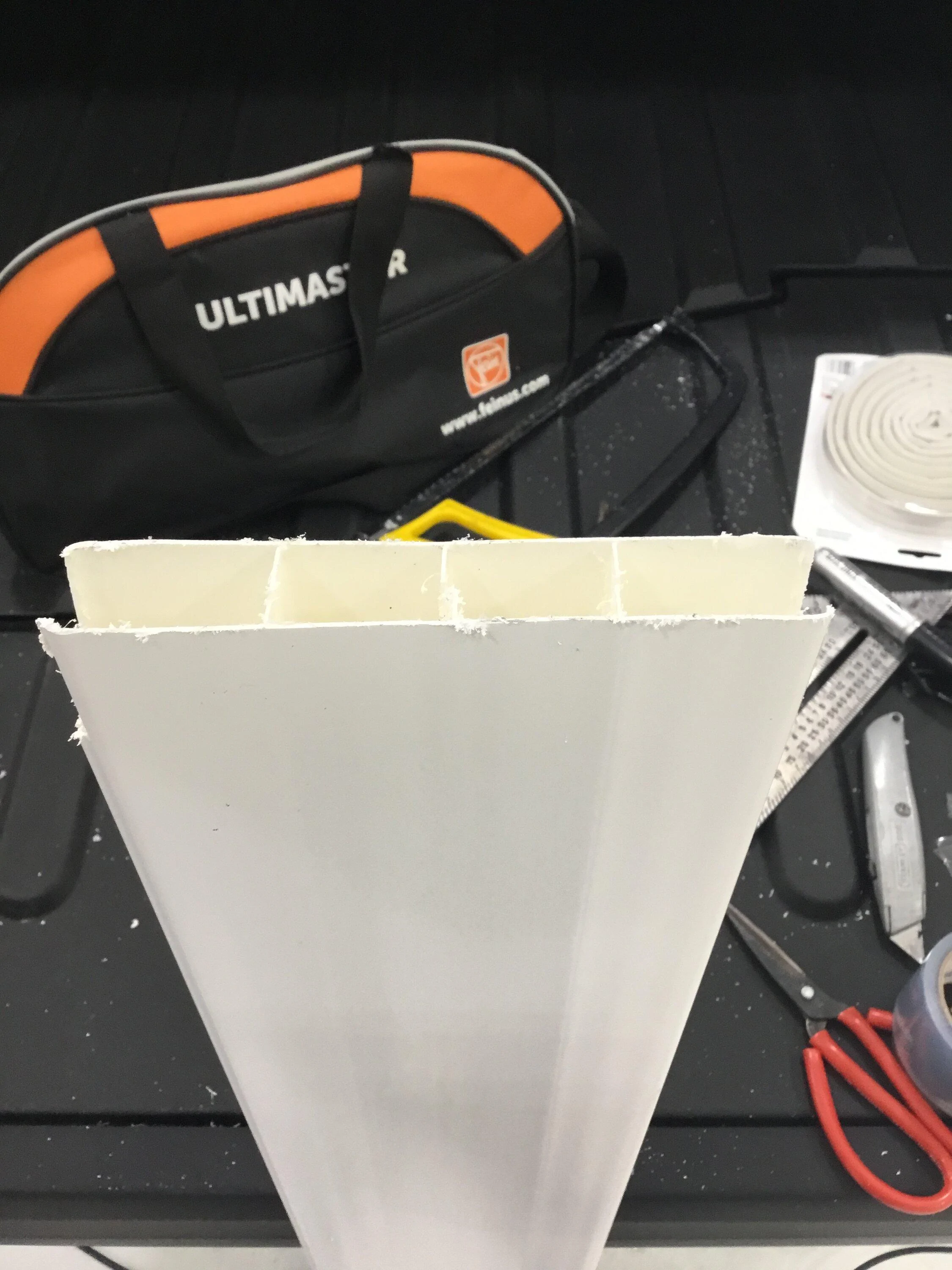

After the third or fourth plank I got a rhythm and technique figured out. First I cut the planks to 54 3/4” (hacksaw or jigsaw). Next I used a multi tool to cut a V notch out of the sides and plunge cut the thin internals and flip down inside the plank

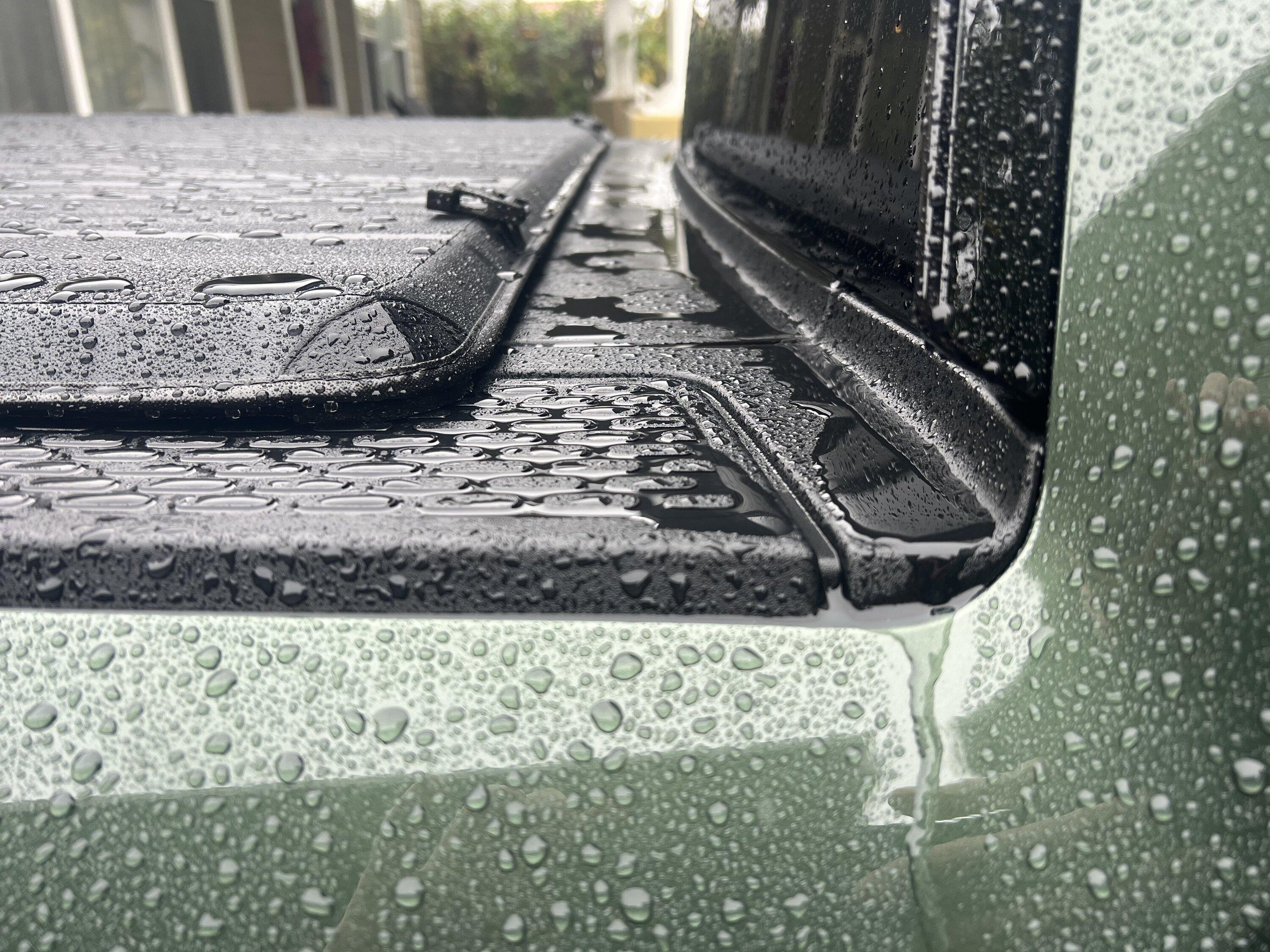

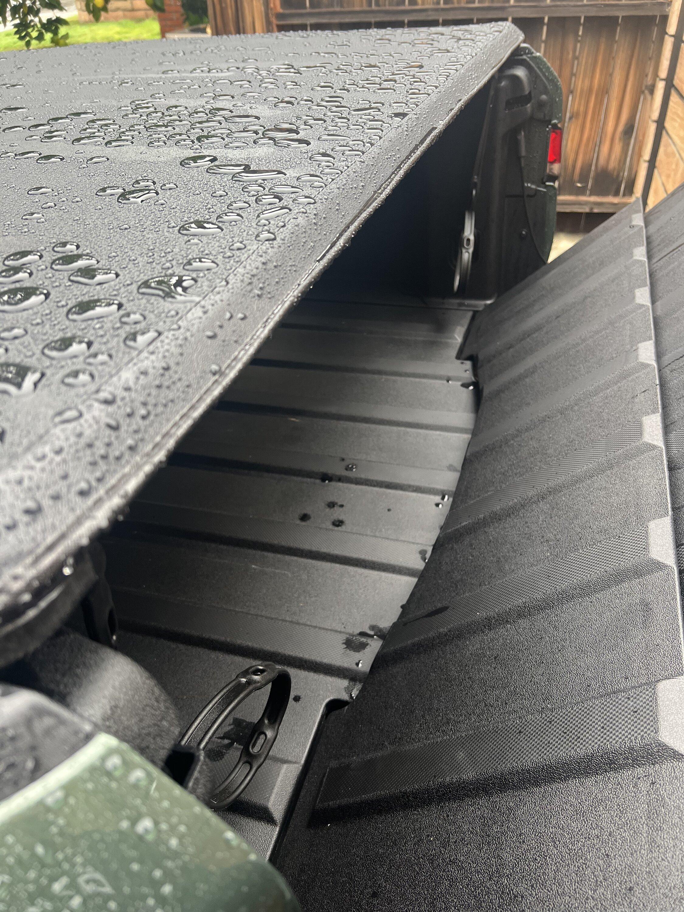

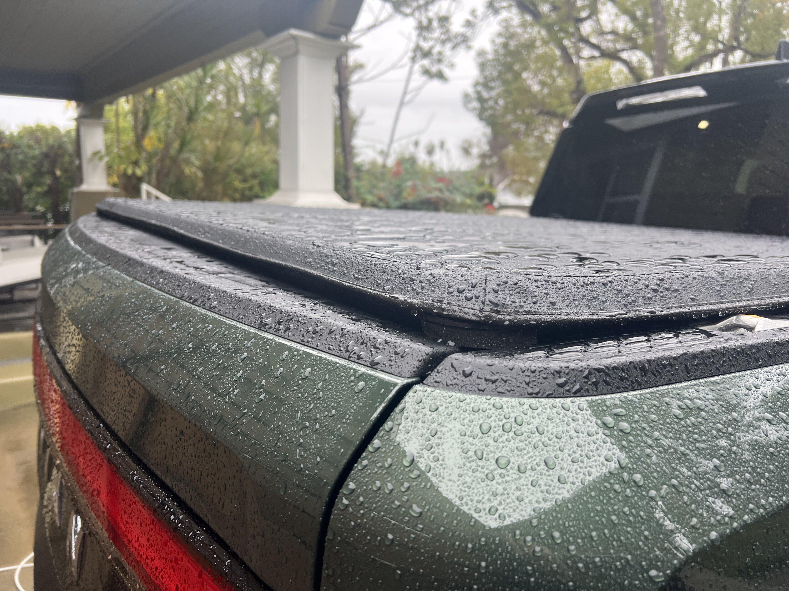

Been raining quite a bit here in sunny SoCal. Happy with the weatherproofing thus far from this tonneau. Water drops in bed resulted from the gate being opened for the photo and was not there prior.
Just what I was hoping to see, thanks.

They went in pretty easy, haven’t had a cause to take them out yet. I cut the V notch in the edges about 2” deep. It collapsed pretty easy. There are some open areas along the tongue and groove edges that could allow moisture into the inside of the planks. But, it’s a temporary cover. Once the manual covers are released, I’ll make a decision on wether to go with Rivians solution or custom build a wooden cover or seaboard.
