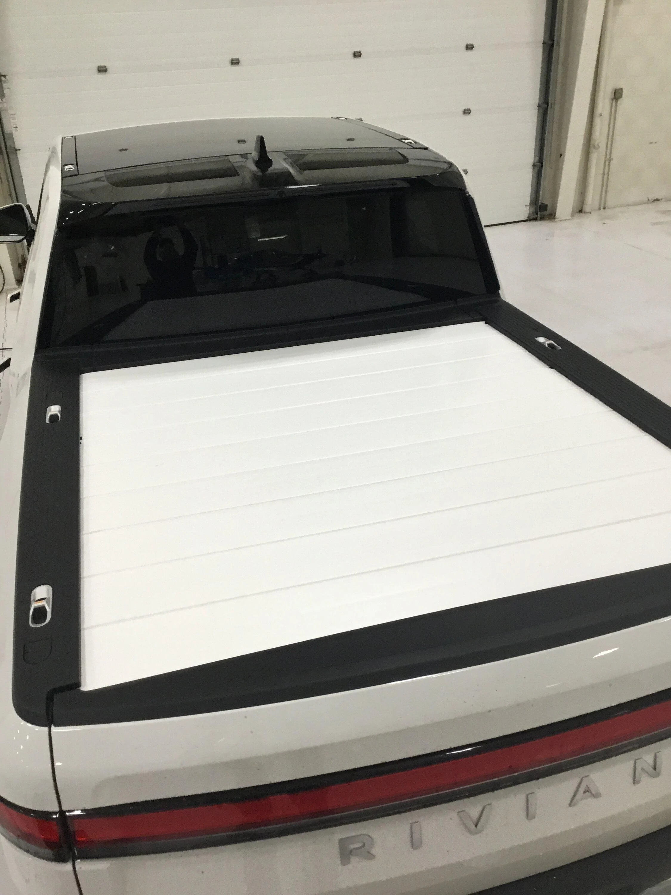

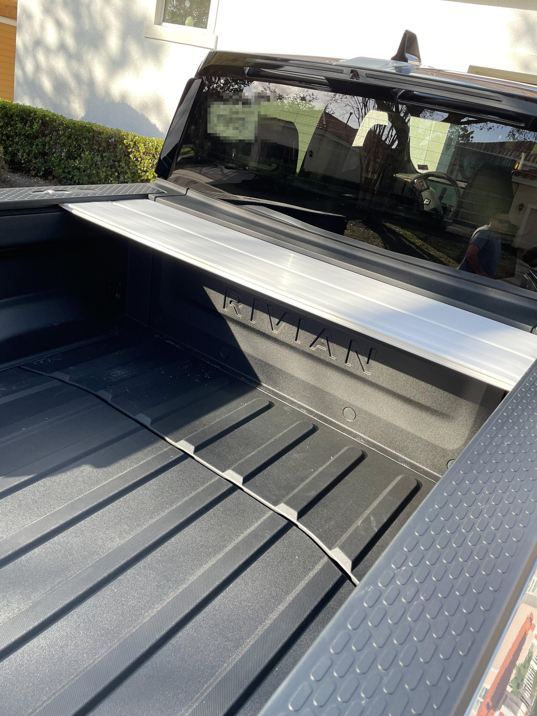

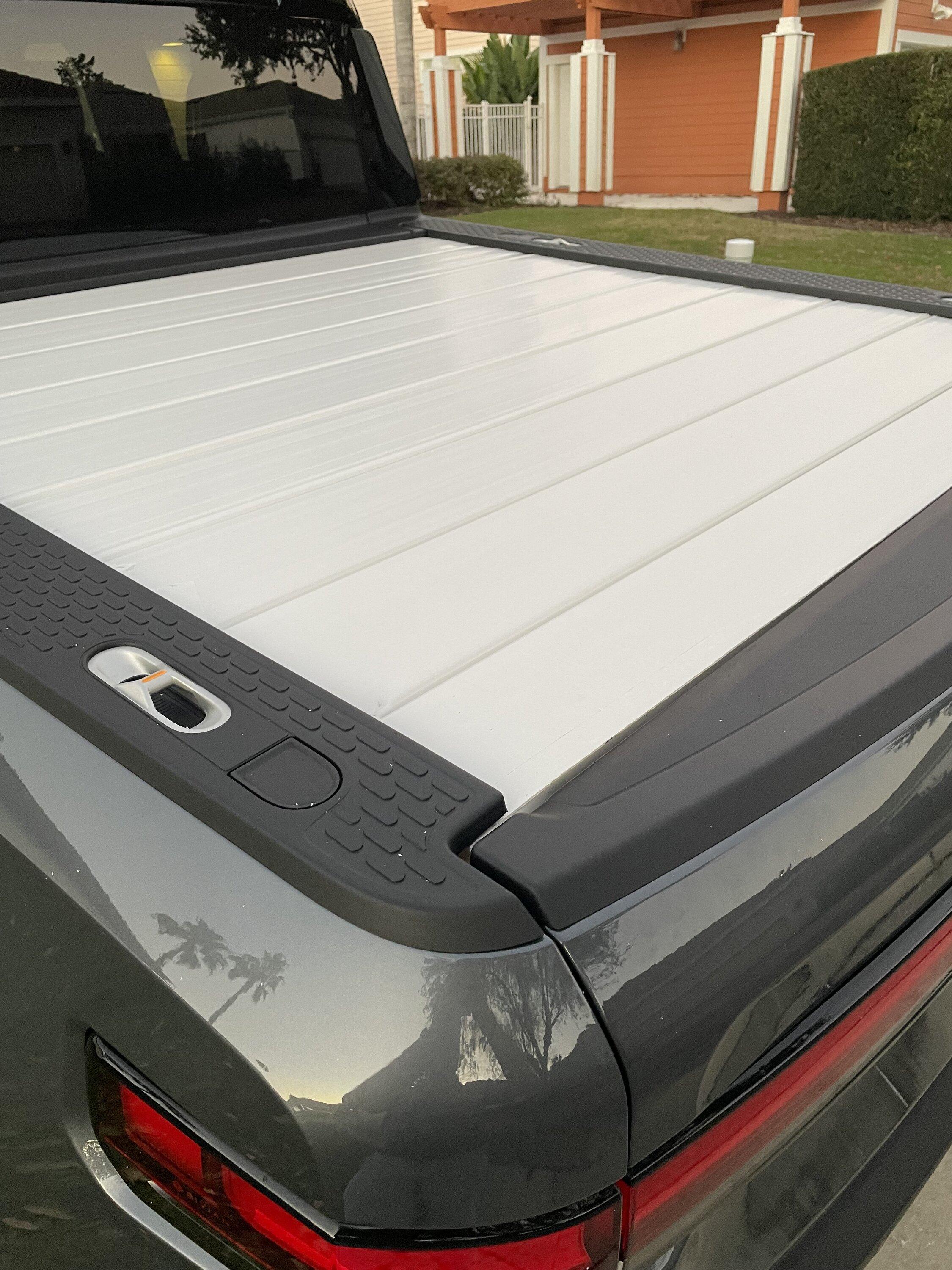

My crack at a tonneau. Pretty happy with how it’s turning out. I’d still rather have a powered cover, but I think this should work. Powder coated aluminum fence panels with hdpe slides.
Holy crap. Those panels are $55/each, that's $550 worth of materials there. crazy for fence boards. Definitely the best looking DIY one at the moment... I think I may go with the plastic fence panels for now and 'bed-liner' them black. Until I decide if there's an aftermarket version that I want more...

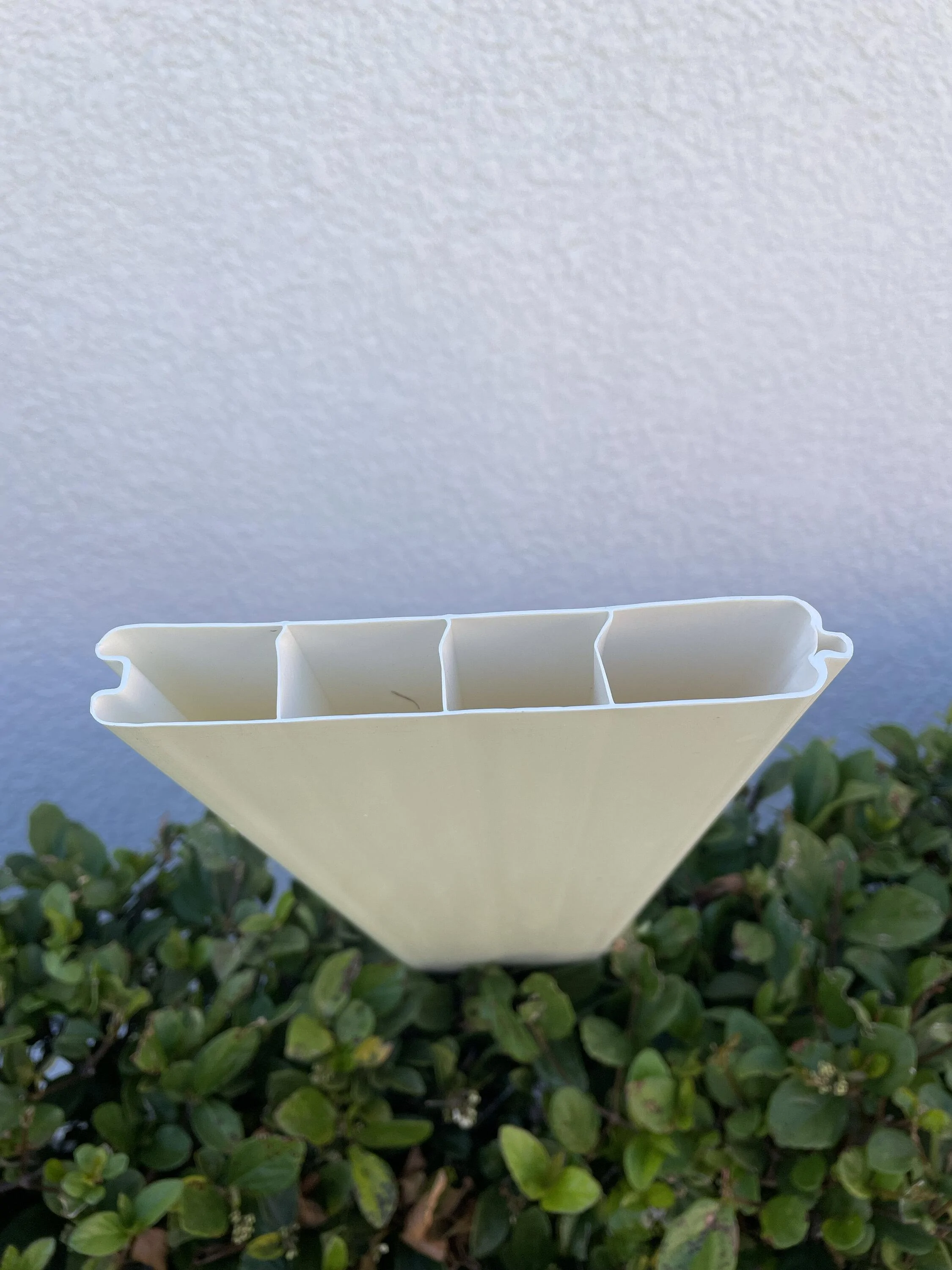

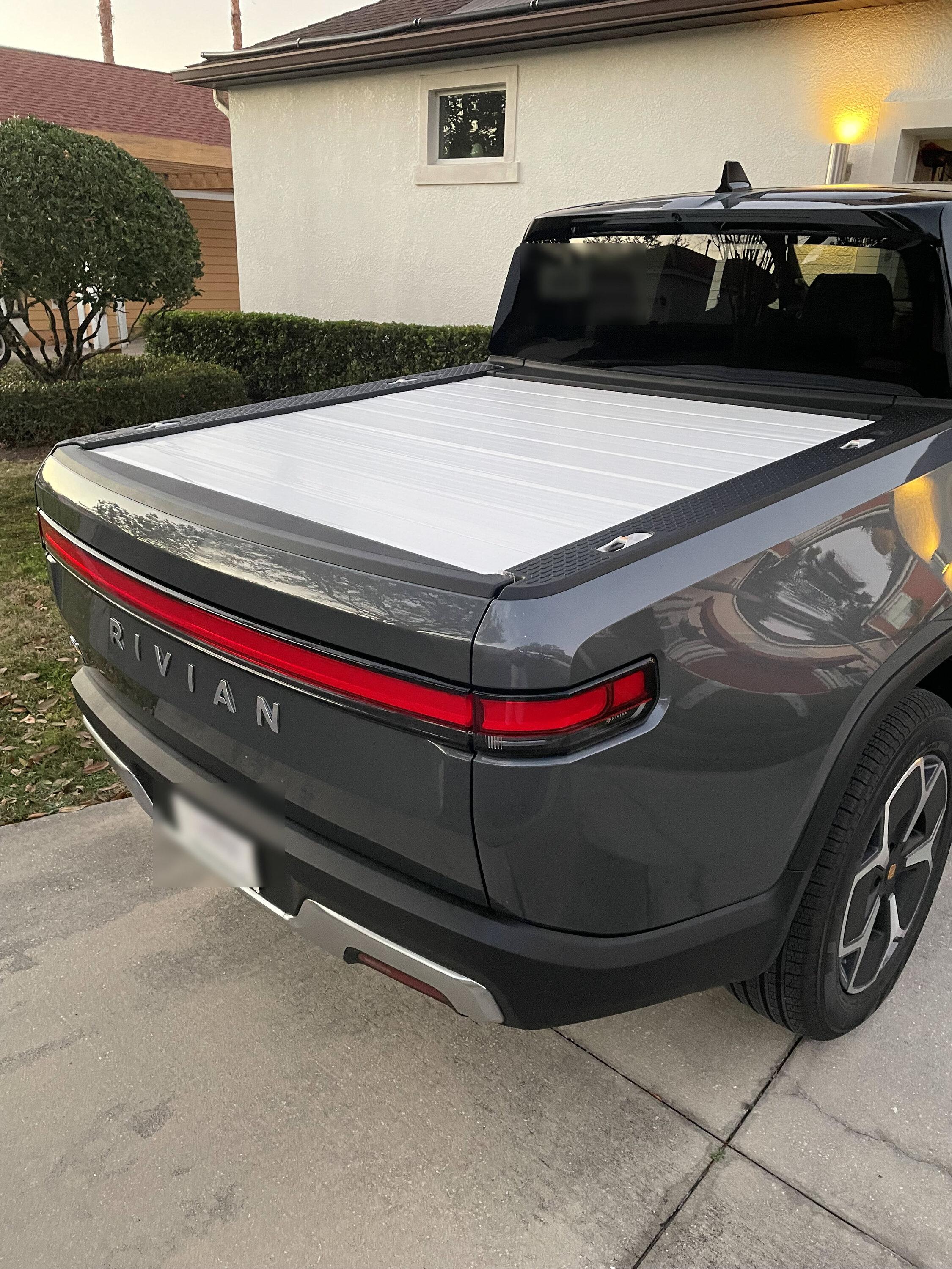

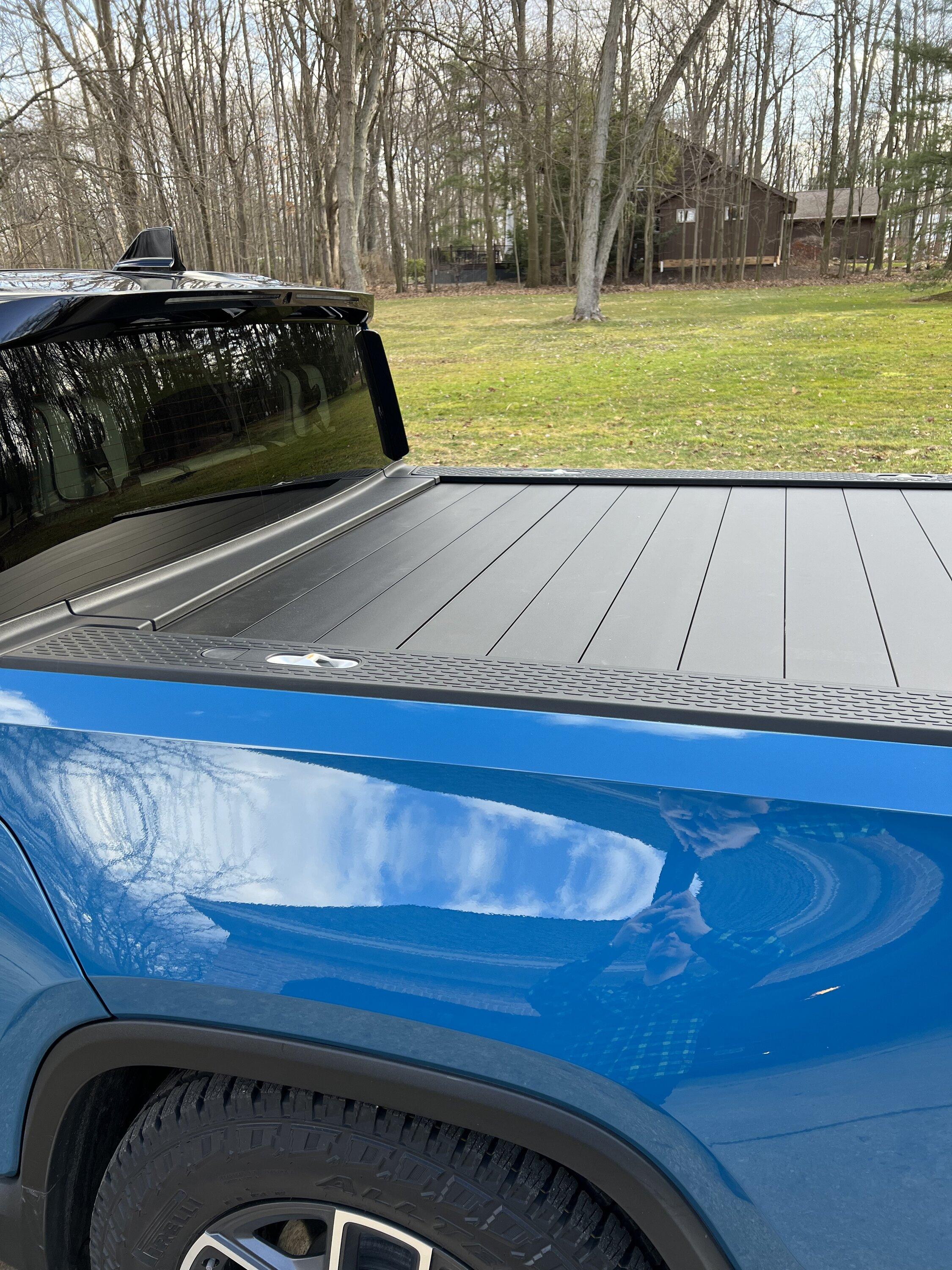

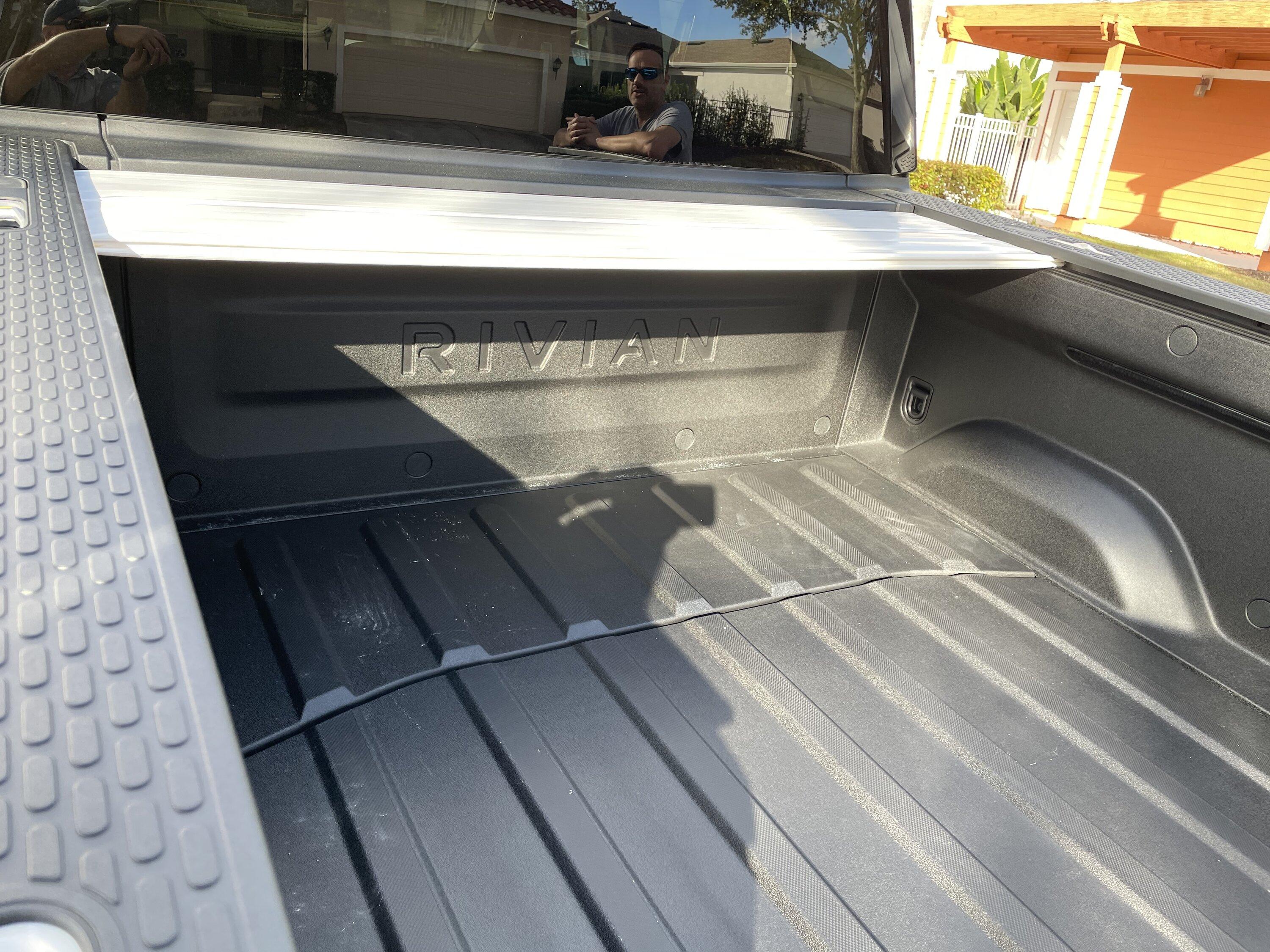

Came up with this idea while reading through this post. Definitely some labor involved but only about $120 total cost. Vinyl fencing pickets, cut to length, then crush and tape both ends to fit in track. I took this route since I knew fencing can already withstand the elements, it's light-weight, wind resistant, and has a tongue and groove. It takes some cutting and finessing but it works! (I kind of like the white contrast but probably can be painted after properly prepped)
Here my attempt with vinyl privacy fence
@Collyay and @Jack Smoke , how easy are those fence boards to pull apart if you want to remove them? Does pulling on the tailgate one bring the whole cover back to you, or do you need to go grab each panel and slide it out?
Is the tongue and groove tight enough that you need to slide them sideways to pull them apart, or do they sorta pop together and apart with some effort? I think this may be a weekend project for me soon, but I don't think the big box store is going to let me take the fence panel apart in the store to play with it...

Yeah, it’s certainly not the cheapest option. It started as a temporary fix, but this will be my permanent cover. All in, it’s ended up well over $800 just in materials and quite a few hours.
The tongue and groove on mine rest against each other they don’t snap together. The finished cover is not water proof, with a direct hose I get drips into the bed. Not a big deal. I remove them one at a time, I can slide mine or put them in sideways then set straight, which is a little easier.

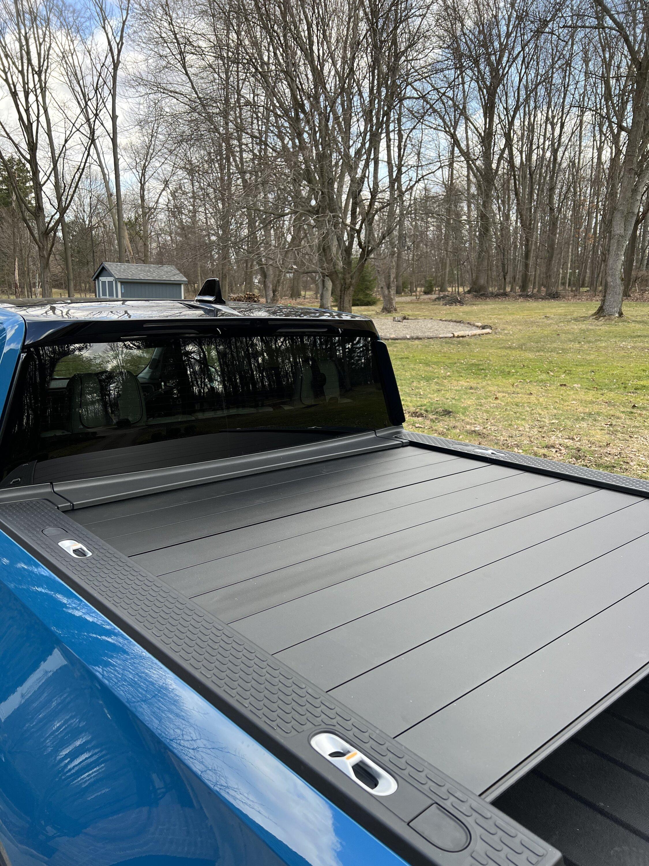

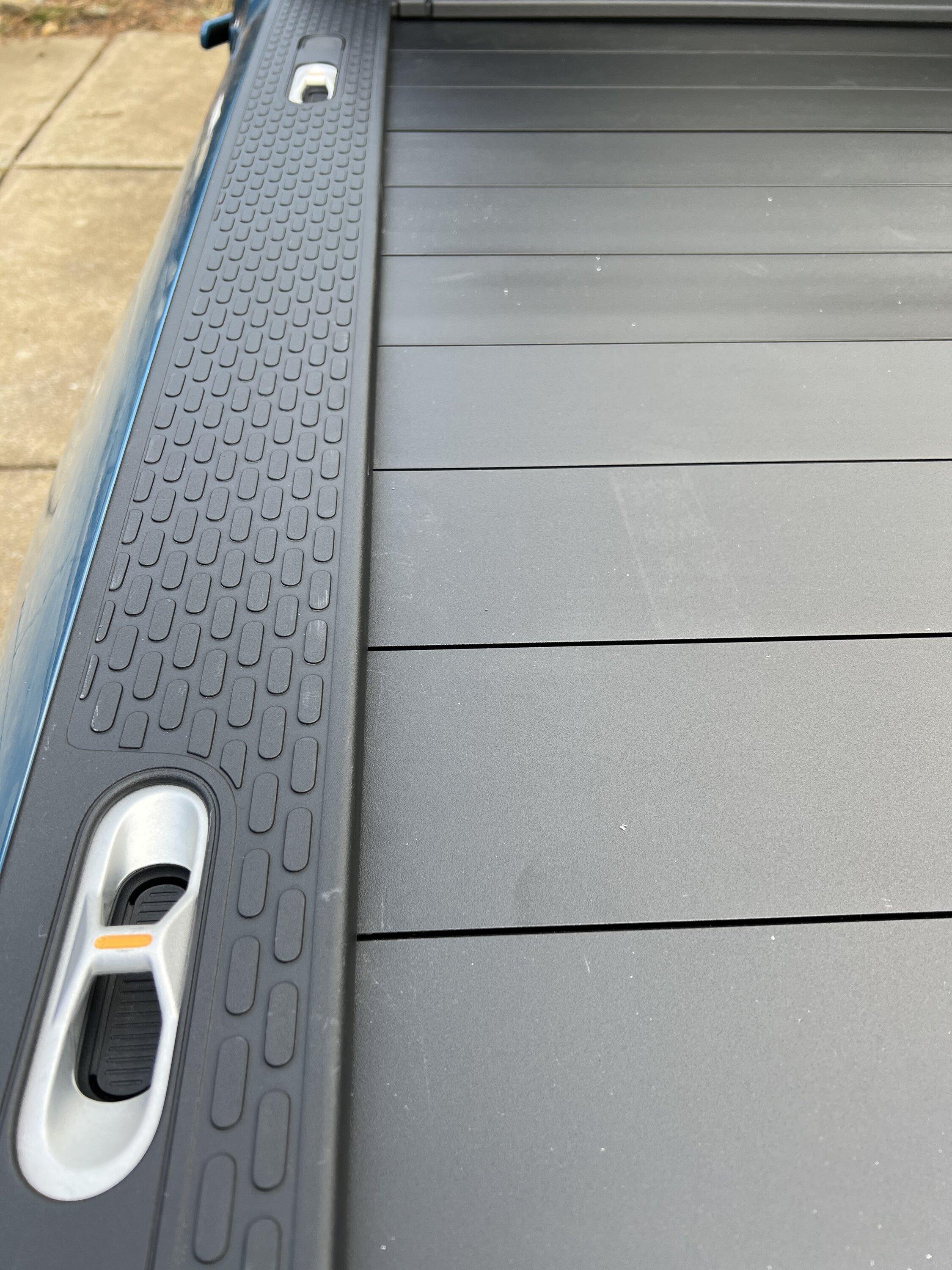

Rivian R1T R1S DIY temporary tonneau / bed cover? B34D035E-EC95-49E0-8C76-0F16250BEB94
Going this route as well, thanks to Bf3. Not cheap, but I think it has the potential to be better than the never seen stock Rivian manual tonneau: I have to some calcs but it may be strong enough to stand on, looks great and is repairable
Repairability is huge for me too. I didn’t do any calculations, but I rolled the dice and found out 2 slats together can support a 180lb guy. I don’t intend to do any tap dancing on top of it, but I’m pretty happy. My kids wouldn’t stay off of it, so I have anecdotal evidence it can support at least 80lbs of wild children too.

Yeah, I really like that look... @Bf3 Can you post a little more about the work you did to make it so clean? (HDPE slides, how'd you cut down the boards, etc...) I'll stick with my plastic ones until I see more from EVSportline and Rivian for their offerings, but even at $800, you're at, or cheaper, than the Rivian one if you bought it before they increased the price by 125%.
