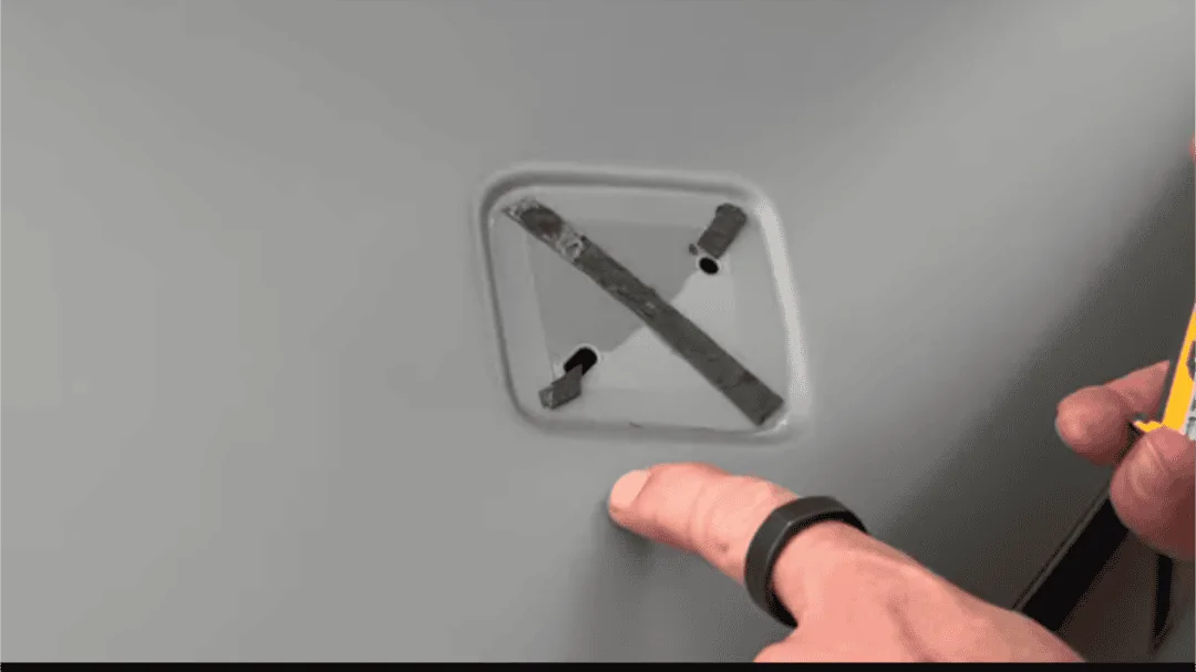

I recommend pulling off the Rivian logo on the front and crafting a base that fits in there. It could even be Rivian logo-esque! There are some good holes already there, just push through the plastic shielding if you want to use bolts, otherwise 3M it on and use the holes for alignment.
Shout out to @AO_Pete for a good video!
Rivian R1T R1S Drilling hole in hood? 1000010342
What a great idea! And very useful photos! Thank you so much!

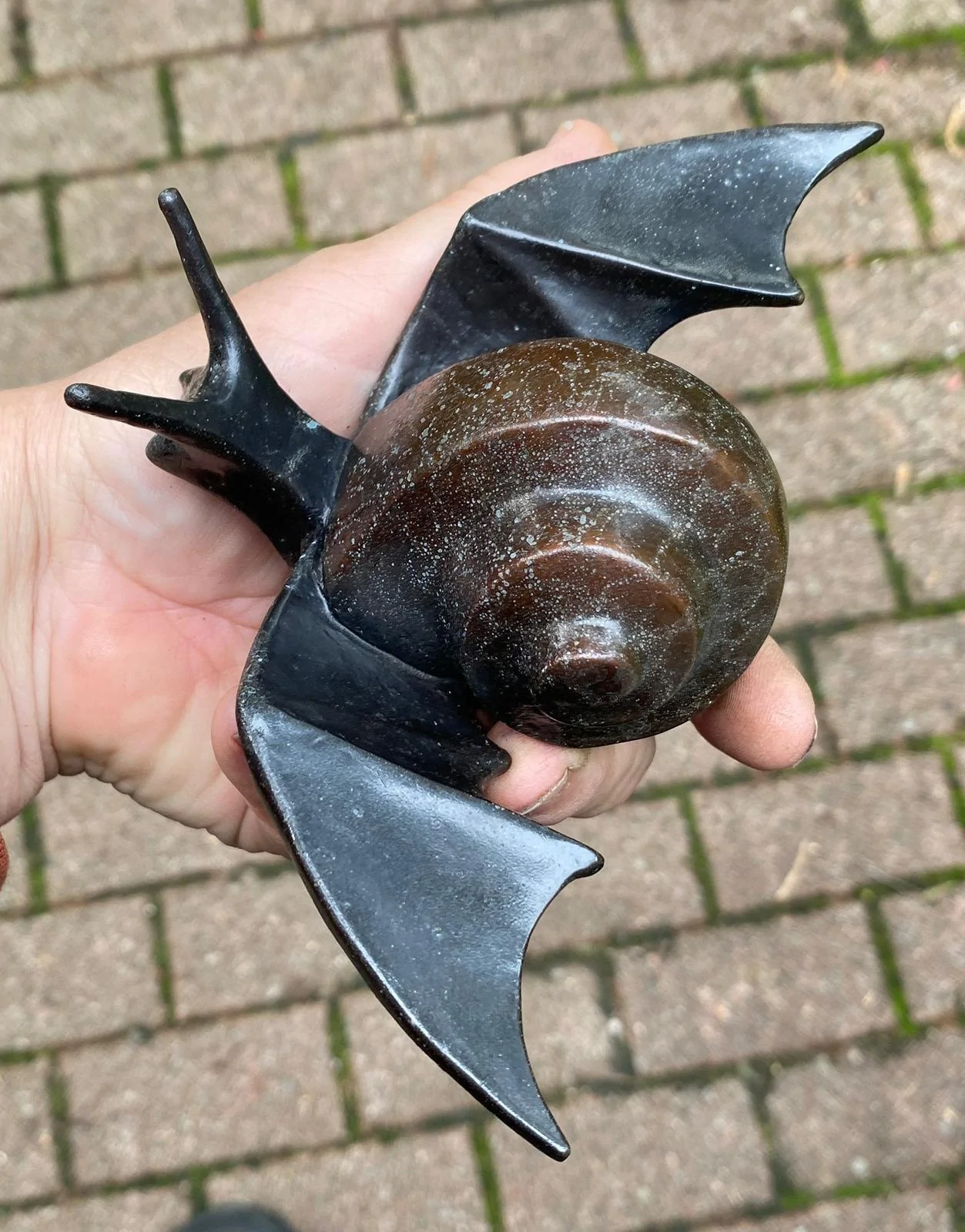

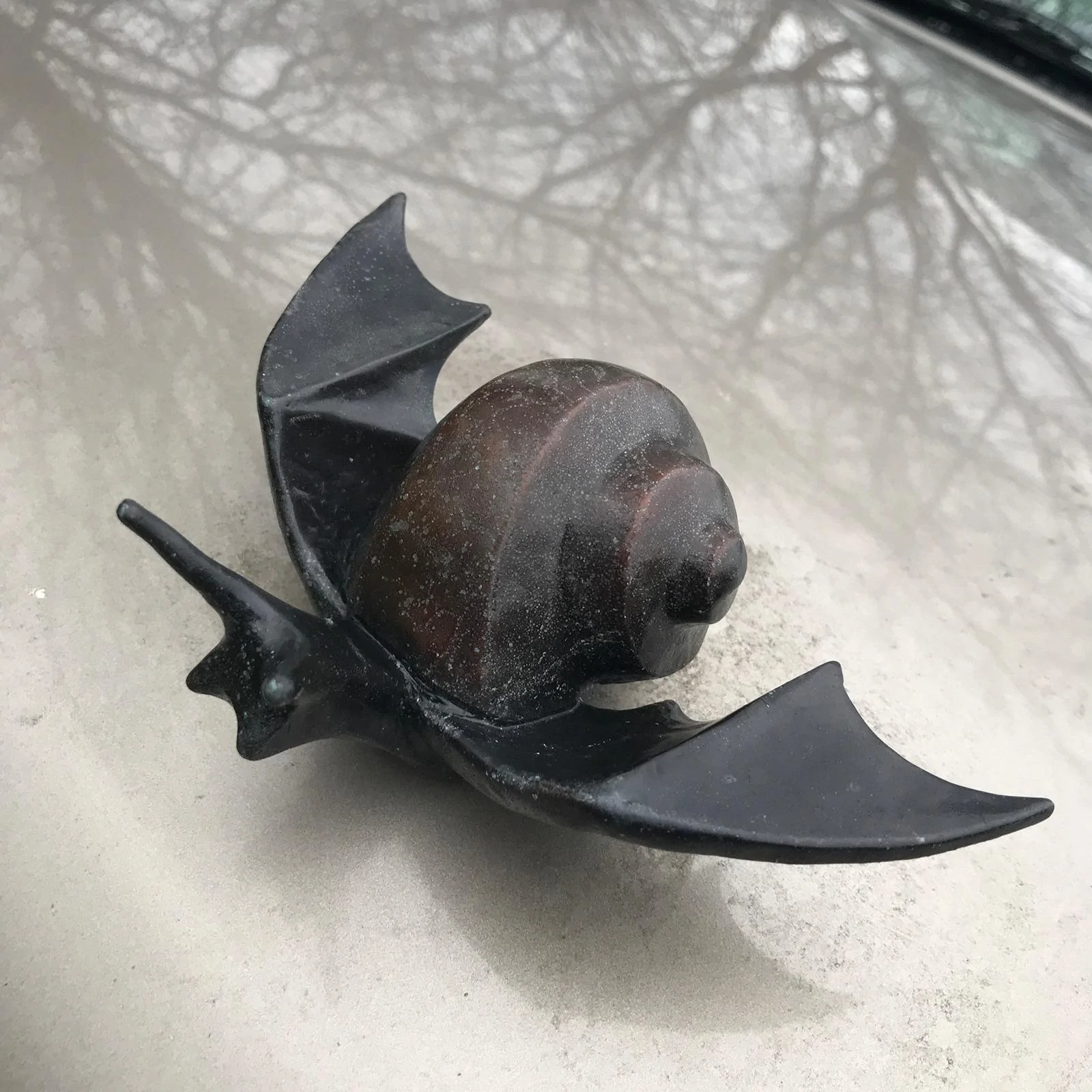

I'll certainly do that! Here's a photo of the ornament on the old truck. And one "in hand" for scale. (My wife's nickname is "Snail"--for old and obscure reasons.)
One watchout because that looks like a hefty snail - the hood opening mechanism will stop opening and close if it senses too much resistance during opening or even after it is open. This has happened to me and others when trying to open the hood with a layer of snow on it. If that snail is solid bronze I suspect it will be heavy enough that the hood will not want to open. You could pull up on it to get it started, but once it is up you will likely have to keep supporting it to prevent the hood from closing automatically. As an alternative solution, you could mount the snail on a roof crossbar spanning the bed. Looking forward to seeing the finished product in whatever form it takes!
That's a useful insight, jdhiker23! Thanks for pointing it out. Seems like experimenting by attaching with putty before any serious commitment would be prudent. I like the idea of a roof mount! We'll definitely explore the option. Of course, first we have to get the darn thing--26 days to go (not that I'm counting...).
