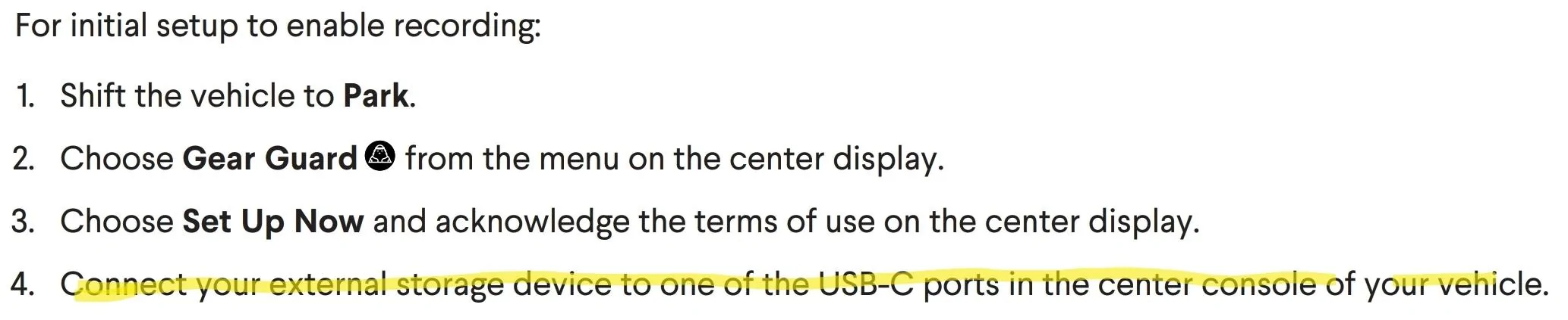

Does the thumb drive live in 1 of the 2 USB-C plugs inside the center console?
