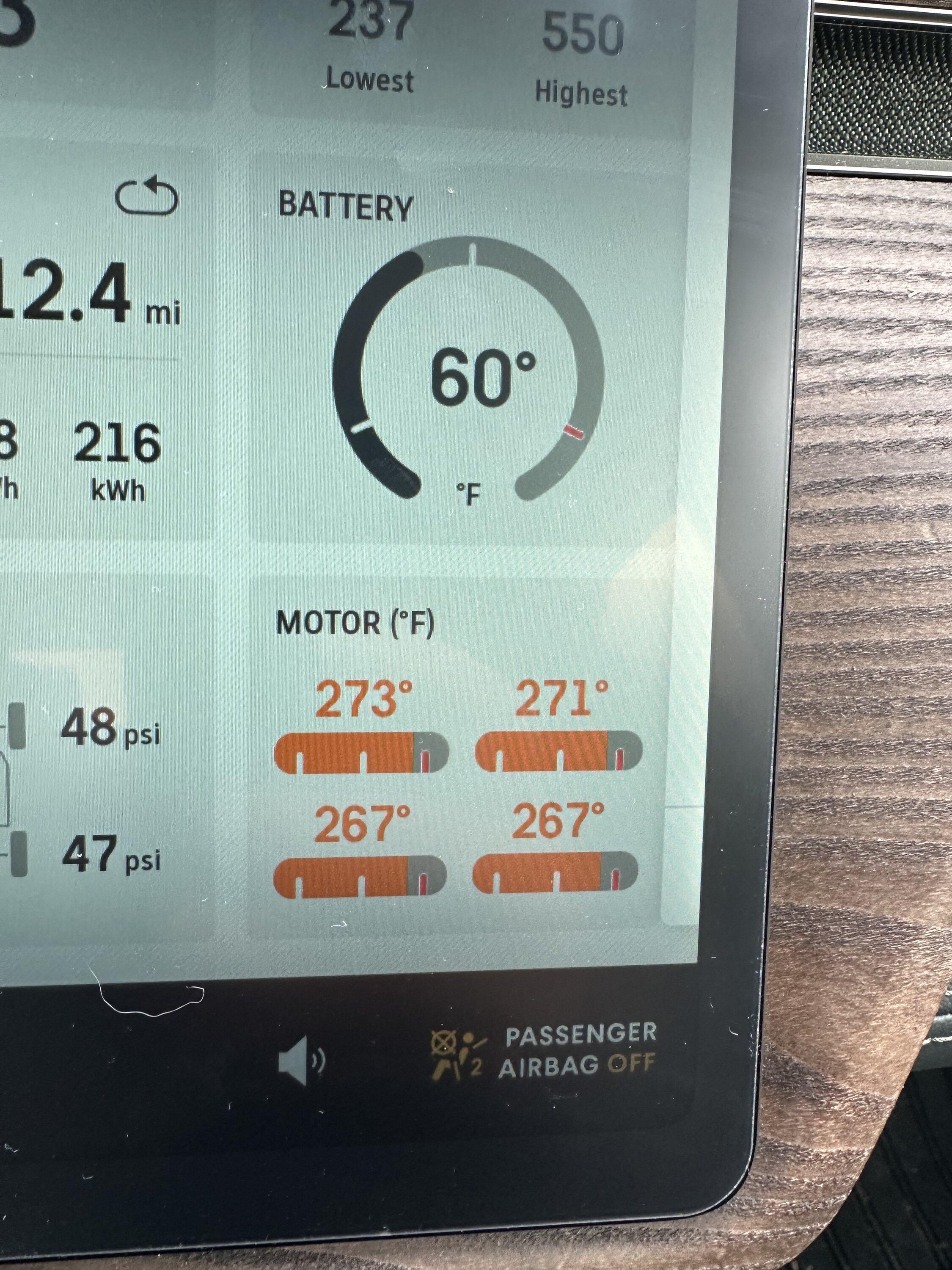

I've observed that when I use adaptive cruise control and Driver+ on long road trips, there will be a stretch where those modes cause the motor temps to consistently climb. They'll climb to 270+ before I disengage them, after which the temp gradually drops back to normal operating temps. Has anyone else experienced this? I opened a service ticket but they told me this was expected behavior, which sounds suspect. I'm going to let the temp climb to completely unsafe operating temperatures next road trip, but I'd prefer not to if anyone else has experienced this.

Rivian really should publish something to keep folks from being concerned over this. Saying its expected without any explanation isn't helpful on Rivian's part.
In colder temps the motors (apparently the front motors) will create waste heat to condition the battery. This is more efficient than using resistive heating. A lot of folks have posted about this. Tesla does this with their vehicles as well. Nobody really knows all the details of this function as Rivian hasn't publicly disclosed it....but basically the coolant is heated in the motors and then sent along to the battery to warm it up. What we see, now that we can see motor temps, is a rapid rise in temps in front motors, then a rapid decline as the heated coolant is moved into the battery.

In my case it's not being used to heat the battery though. It's not during the part of the trip where I am going to a fast charger and the battery is being prepped. Nor does the battery temp increase. The battery stays steady around 70 degrees, while the motors climb close to 300.

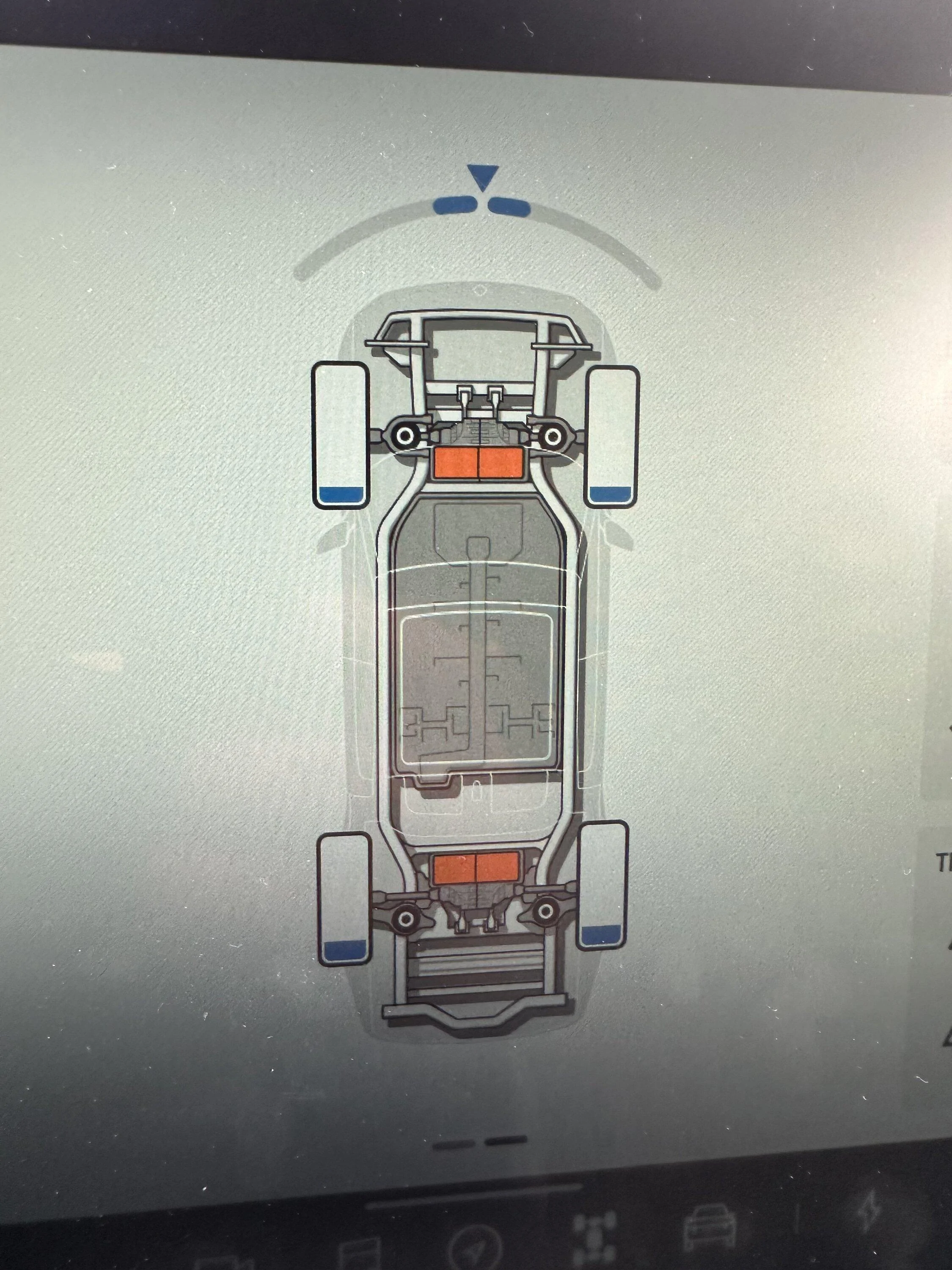

Happened to me today. The only context given was the map told me the truck was preconditioning the battery for DC charging. It raised the battery a full 20 degrees from 56 to 76.
But ORANGE sure does raise some anxiety.

Just because the temperature of the battery isn't increasing doesn't mean the battery isn't being warmed. I think it's reasonable to assume it's just trying keep the battery at a steady temperature.
But if the car isn't given you any errors, you are probably just over thinking it with all the new data available and you (and all of us) not really fully understanding how it all works.

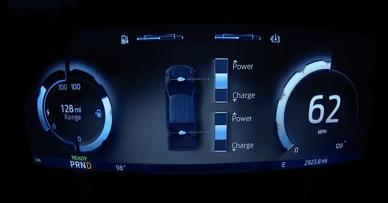

Ford has a non-numerical battery and motor temp gauge and it doesn't really change much unless it's out of spec.
I used to criticize them for not reporting the temperature. After seeing all of these Rivian motor temperature posts I understand why Ford made that decision.
