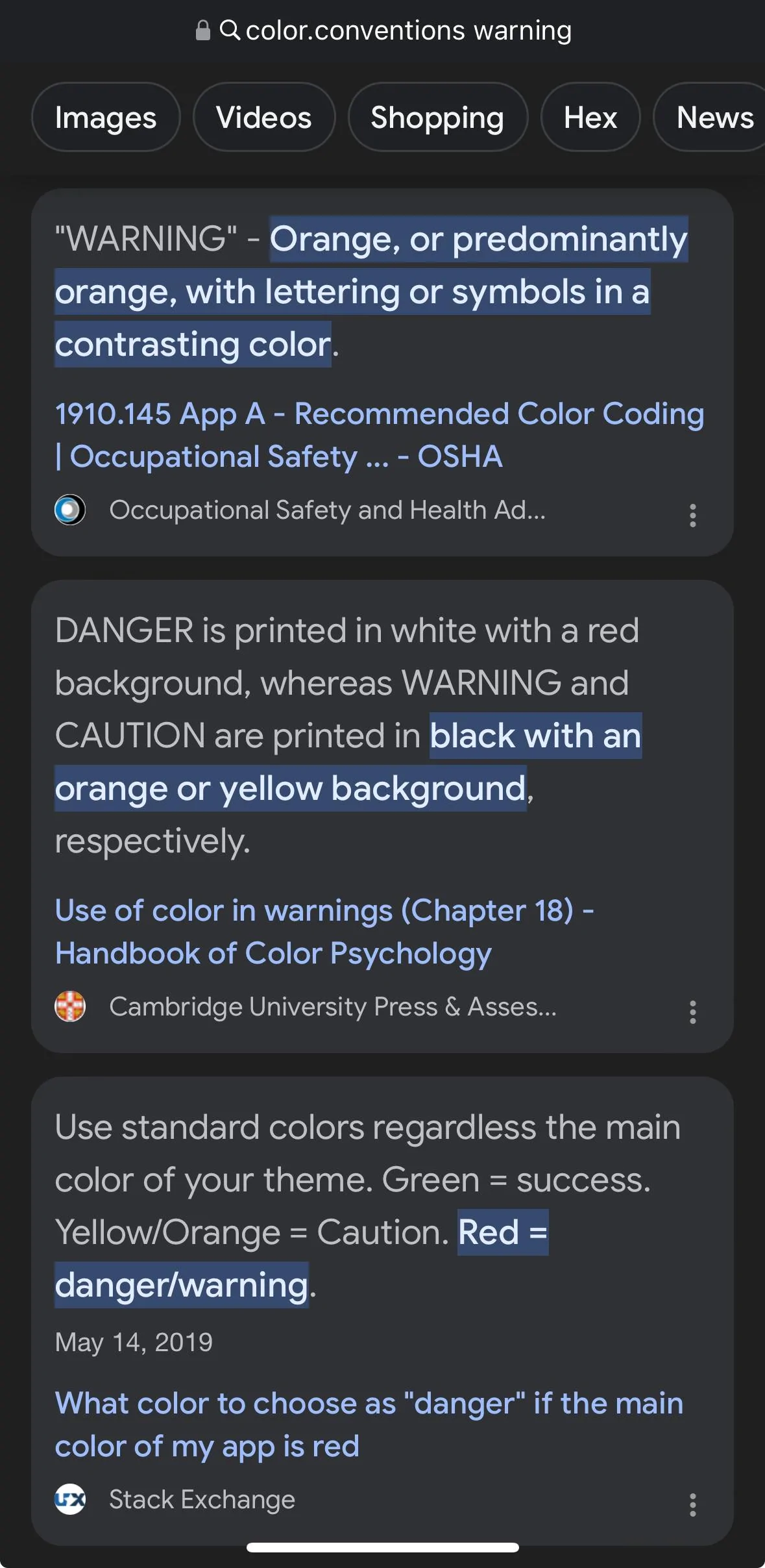

Rivian R1T R1S Driver+ and Cruise Control Unsafe Motor Temps? IMG_0841

I know it's a little hard to tell, but the motor color in OP's photo is orange, not red.

Exactly. It’s hard to tell whether it’s reddish orange or orangish red. In either case, if it’s not supposed to indicate a serious situation, it should not be an ambiguous color that is bound to confuse people. Make it clearly yellow, or no color at all, and call it a day ?
