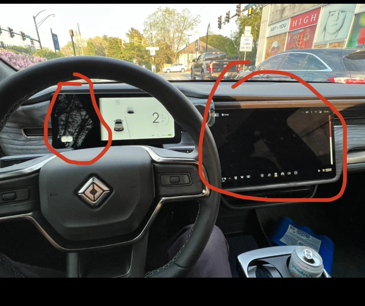

I've had that happen a couple of times on the Tesla and sort of happened yesterday on my Rivian. Not a big deal, the car functions fully without the screen. Just had to reset the screen.
Rivian R1T R1S Driver Says His Tesla Car Computer Froze at 83 MPH on Freeway IMG_DB4BE0551782-1
