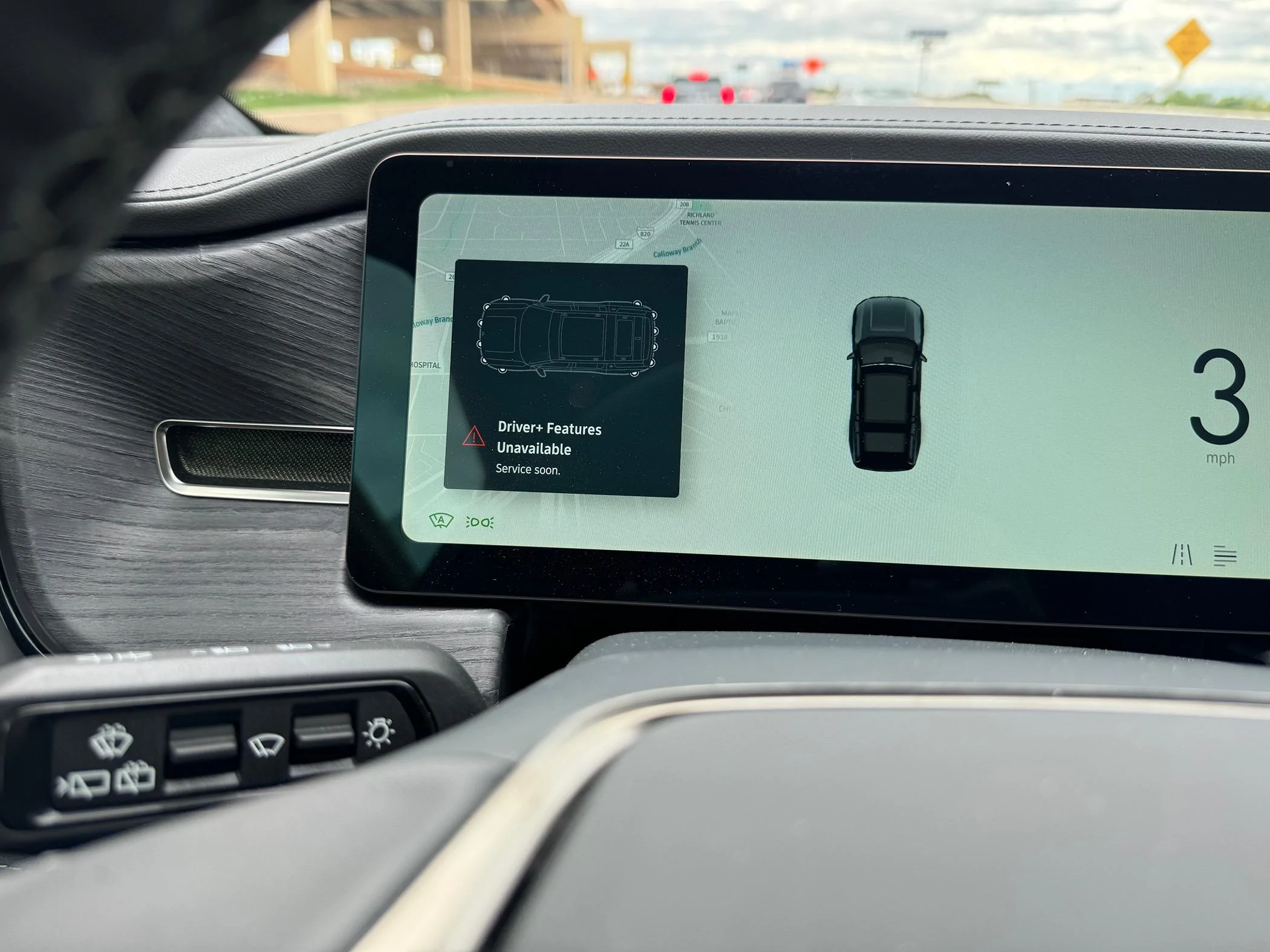

Driver + Unavailable Service Soon
I randomly get this message, there’s no rhyme or reason. A sleep cycle always seems to fix it. My car is at the SC now, they’re just having an issue locating the cause. Anyone had a similar issue?

I had intermittent issues with Driver+ features in my car since delivery. I didn’t get the message about the parking ultrasonic sensors like yours, mine showed up as the front radars and the front camera. They replaced the ADAS computer on my car. That fixed the problems for a while, but now they are slowly starting to reappear as of a week or two ago. :(
I’m beginning to think I have a loose wire or ground somewhere. It’s sometimes seems to happen and go away on mine when I hit a bump in the road.
Yes, it just happened to mine just like your screen is showing. I requested service and got an appointment for next week. It got fixed overnight. I have had my R1S for 5 months now. Over 4k miles.

Update: If you’re having a similar issue, check the camera behind the rearview mirror. When the SC popped off the trim piece on mine, the bottom right corner wasn’t glued to the windshield. I guess it was causing the camera to move and causing the Driver + to fail. I haven‘t had any further problems since they fixed It.
My issue is back, and it is happening now on every drive. Did they figure out what was causing yours to fail? I have another appointed next week.
Any update after your appointment? My issues with driver assist have returned and my appointment is 3 months out. I feel like since the safety systems are disabled that they should have a bit more priority in getting these fixed.
They replaced my AXM module, which fixed the issue for about three weeks. It is back now, so I have another appointment on June 10th. I have read others have had issues with the Ethernet cable causing this problem.
I agree with you. It is also annoying to not be able to use cruise control on roadtrips. I would try calling them and expressing your concern about safety and see if they will squeeze you in.
