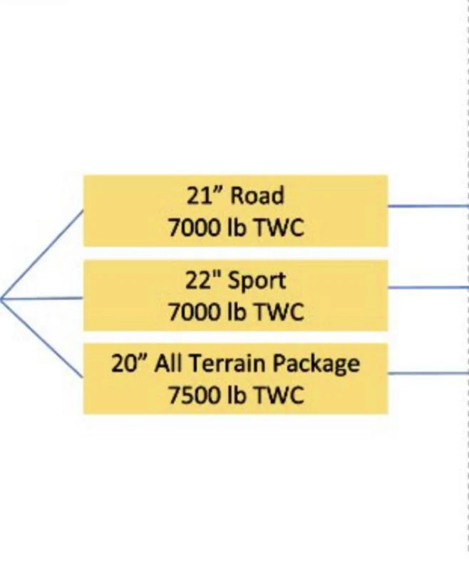

Does this mean the rear underbody shield, spare tire and kit, and whatever additional the 20’s weigh over the 21 and 22’s adds about 500 lbs?

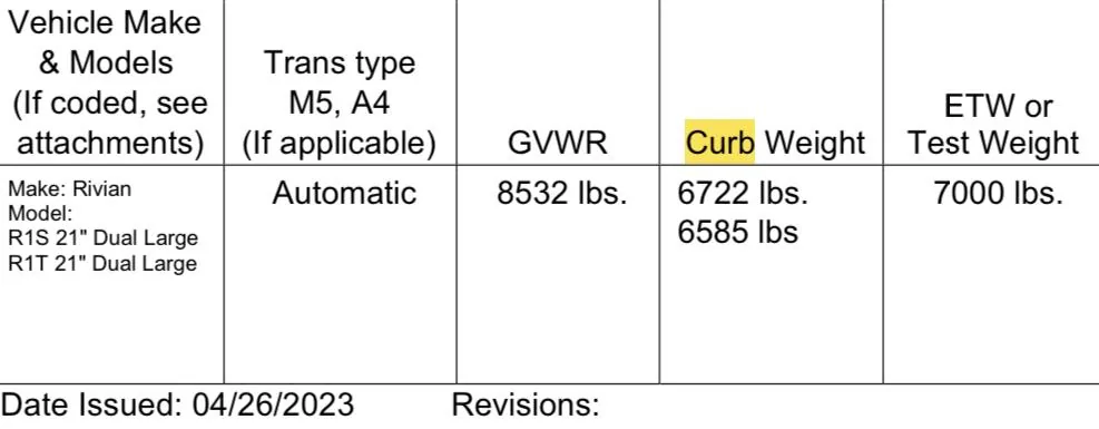

Document states curb weight for the 21" dual motor R1S is 6722 lbs. Quad was 6843 lbs. So about 120 lbs less. GVWR is the same so all that extra weight becomes usable payload.
I wonder if this explains why the EPA rating of the 2023 R1T Large Quad with 20’s is 289 miles while on the Rivian website the estimate is only 274 miles. Maybe the latter reflects testing with the off road package and in all purpose mode rather than the previous mix of Sport and Conserve modes?
Test weight is rounded up to the next 500 lbs after considering added weight of a driver. I'm not familiar with what the driver weight is assumed to be for the tests. Actual curb weights are in the ARB filings at the bottom of the document.

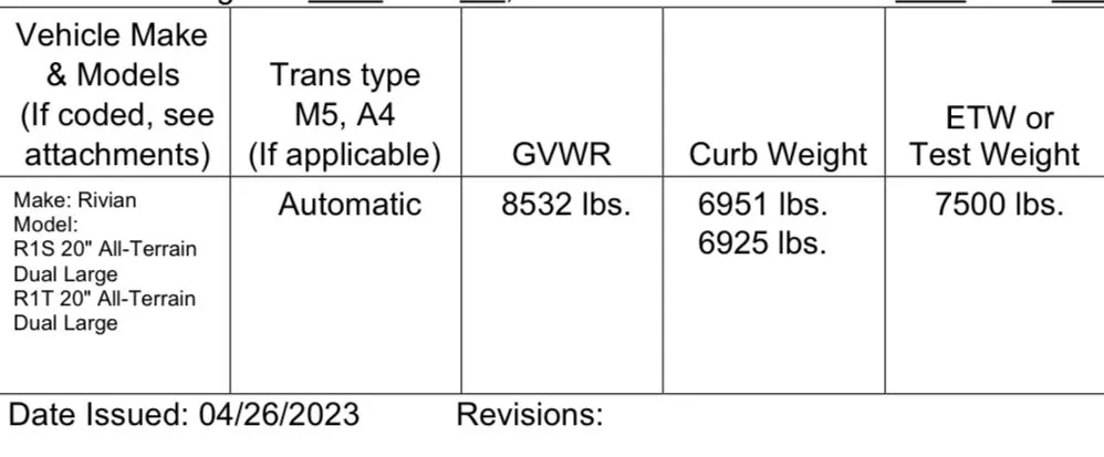

Thanks for explaining and pointing that out. Found the data in case anyone is interested:
Rivian R1T R1S Dual Motor EPA Certification Application (Reveals HP, Efficiency, Range, MPGe Figures) IMG_2210
Rivian R1T R1S Dual Motor EPA Certification Application (Reveals HP, Efficiency, Range, MPGe Figures) IMG_2211
Interesting.. by my calculation my QM R1T has a curb weight of 7208 (UB Shield, Spare, 20s and Tonneau). That is quite a weight reduction and might make an 'upgrade' worthwhile.
