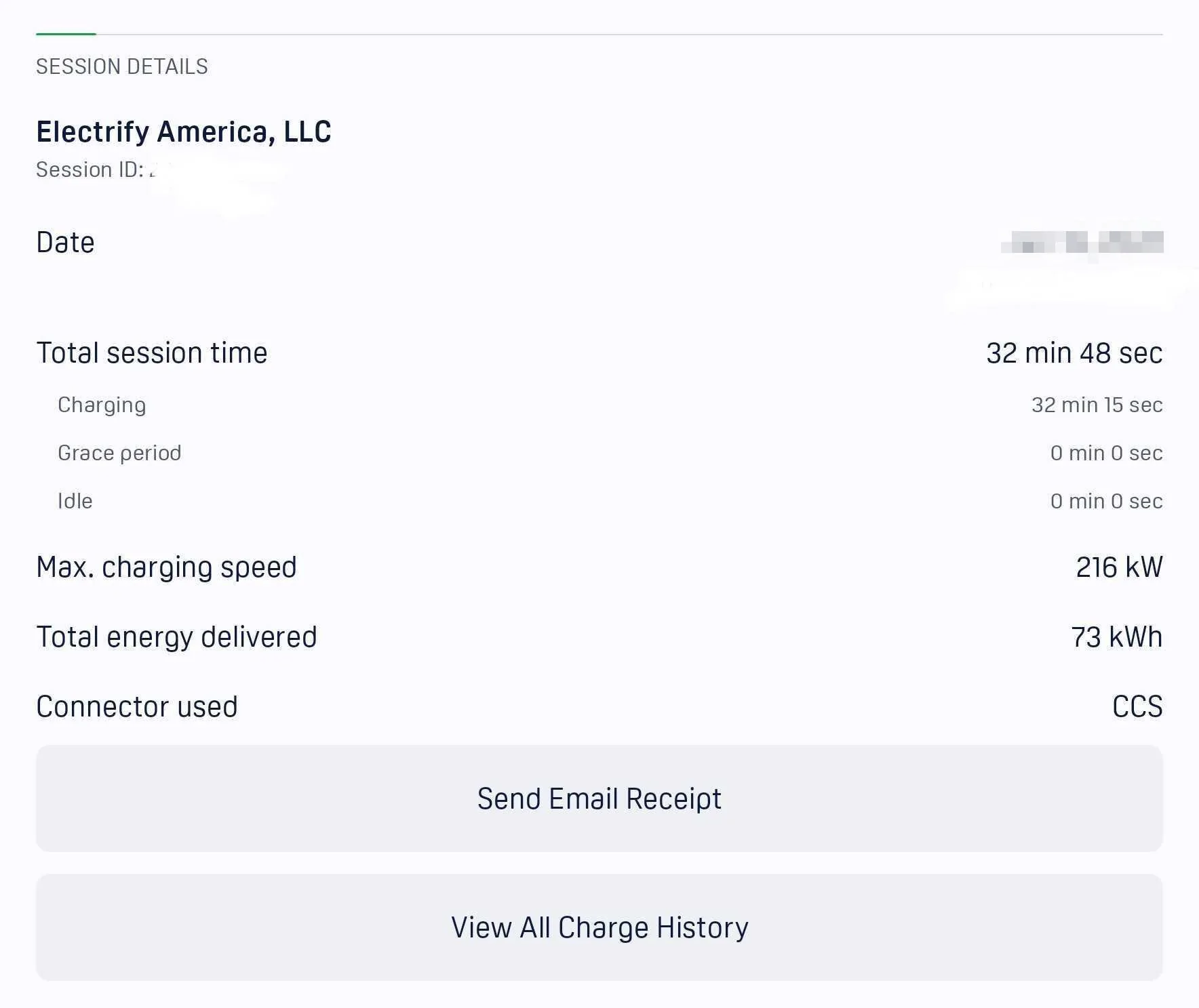

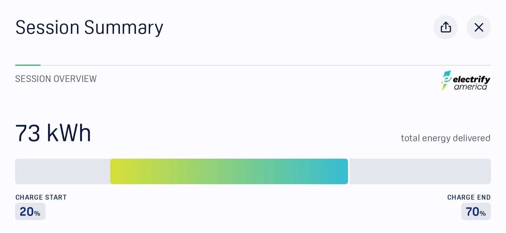

Screenshots from an R1T Charging session in California. Found online
Nice find!
Playing with some math here for the charging curve:
the taper generally occurs pretty hard at 60%. So let's assume 20 to 60% SOC averaged ~190kw. And let's assume charging losses were consistent across the charging session. So 20% to 60% would be 0.8*73kwh = 58 kwh.
58 kwh/190kw = 18 minutes.
60 to 70% would be ~15 kwh in 32 minutes - 18 minutes. So an average of 65kw.
Playing the same game with 65% would be about 30kw on average. If it averaged 175 from 20 to 65%, then you run into about 47kw over that last 5%.
Also, we know that the max speed they said it could handle to the EPA was 210kw. So there should be at least 6kw of charging losses there. It also could be consistent with the max I've seen from someone's truck, which was 196kw. (~10% charging losses).
