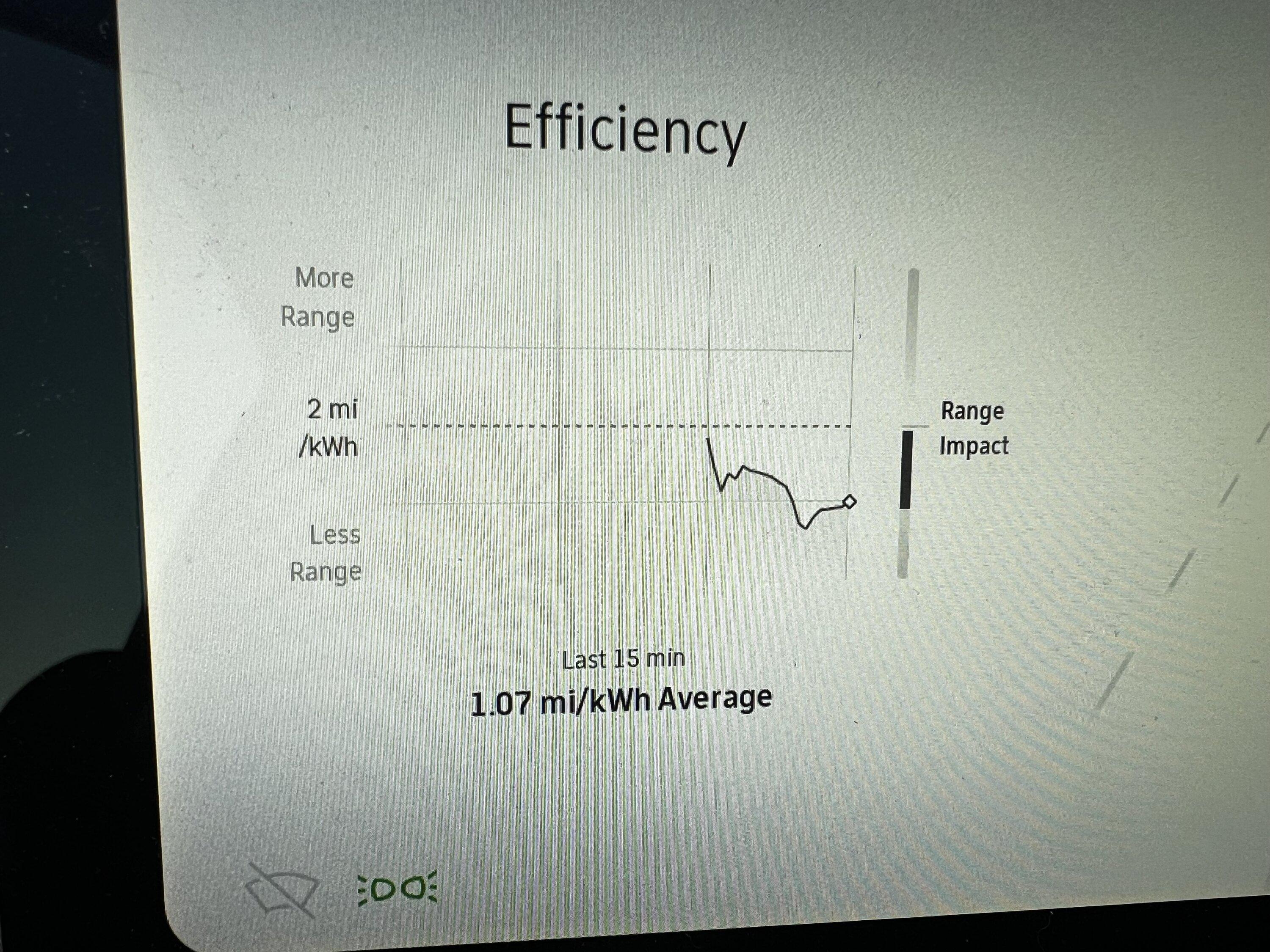

Slight incline, 48 outside, climate set to 72 auto, battery temp is 72 as well. At this point I can’t keep this on the screen anymore looking at it is really depressing.
Rivian R1T R1S Efficiency Has TANKED IMG_3128

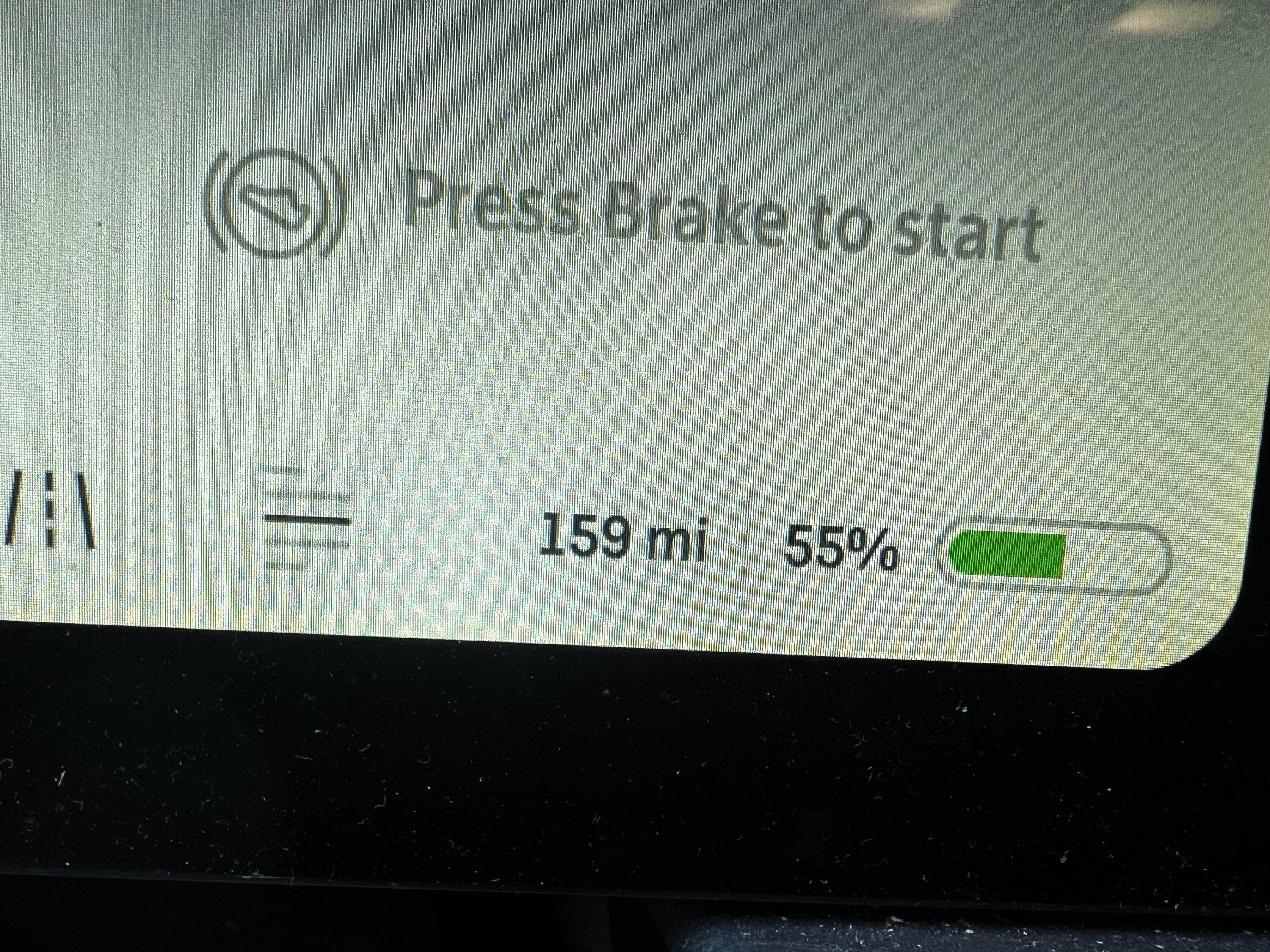

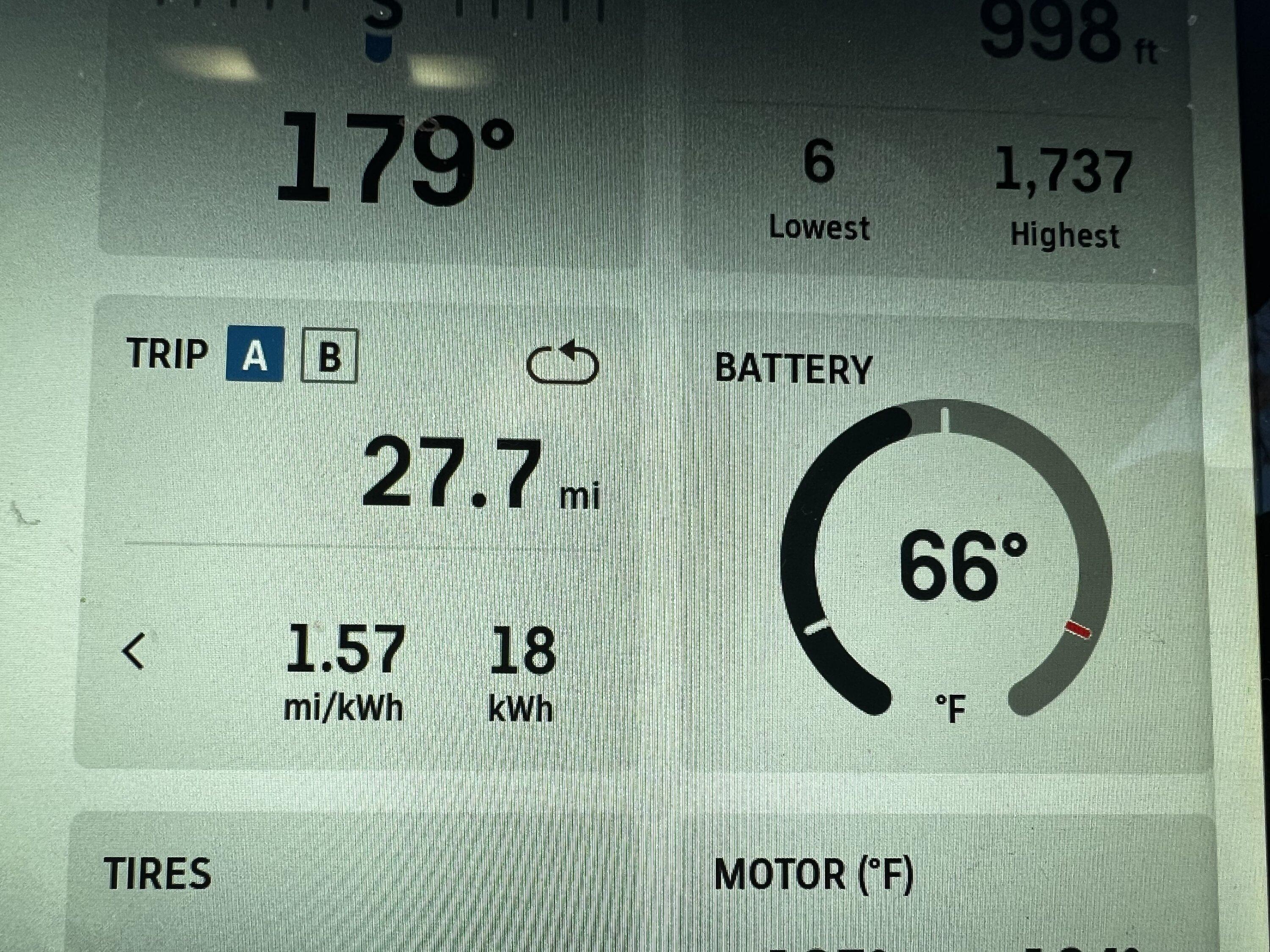

I drove 27.7 miles this morning with the heat on at 73 degrees. My truck started at 203 miles and 70% charge and took up 44 miles and 15%. Wheels are OE 20” darks and 33” Nitto Recon Grapplers.
44 miles to go 27. ?
Rivian R1T R1S Efficiency Has TANKED IMG_4195
Rivian R1T R1S Efficiency Has TANKED IMG_4196
