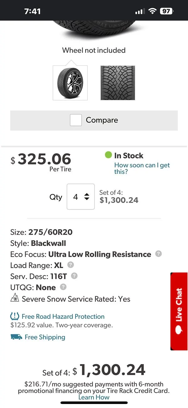

I went with Hankook Winter I Pike X 275/60R20 due to 116 load index (Micheline X-ICE, Nokians R5 in this size only have 115), availability at my local Discount Tire, thread pattern/noise, low weight (42 lbs), and price ($211 per tire).

I bought the Hakka R5. They are 116 rated.

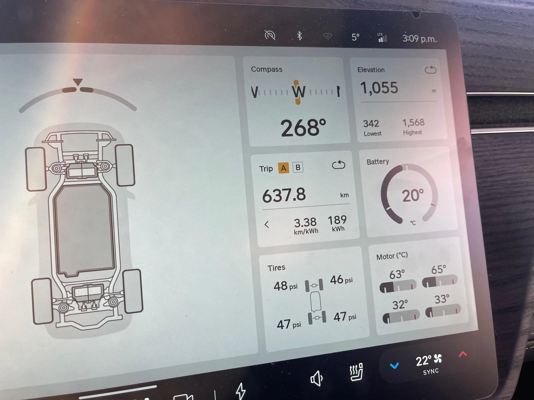

Thought I would contribute another tire option to this thread. Have been running Hankook Winter i*Pike X studded W429A, 275 60r20 on 2024 Gen 1 R1S Quad Large for a couple weeks now. Did a round trip to Edmonton from Calgary.
Total Distance: 638 km
Efficiency: 3.38 km/kwh
95% highway driving using highway assist
Highway Speed was set to 110km/h there and 105km/h return.
Outside temperature was 1C in Calgary and dropped to -9C in Edmonton
Vehicle was preheated before departing and then sat outside for 4 hours before returning.
