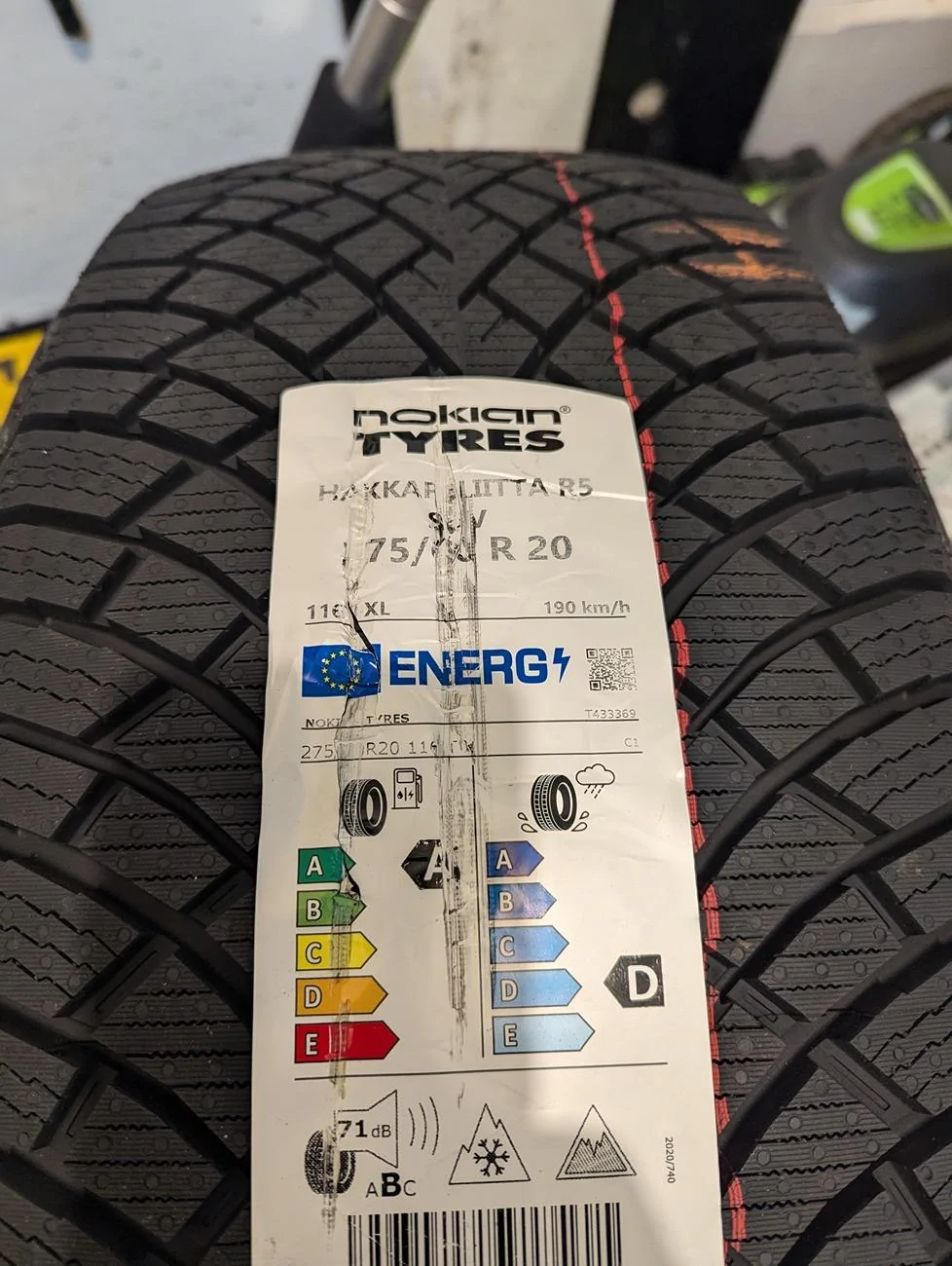

As for snow tires, I considered the Nokian R5 but in September our discount tire could only get the 115 load index. The discount advisors really wanted me to get the higher load index tires because of the weight of the truck and I have never ignored their advice. I am told Nokian R5 now comes in 116 load index. My top choices where the General Grabber and Hankooks.

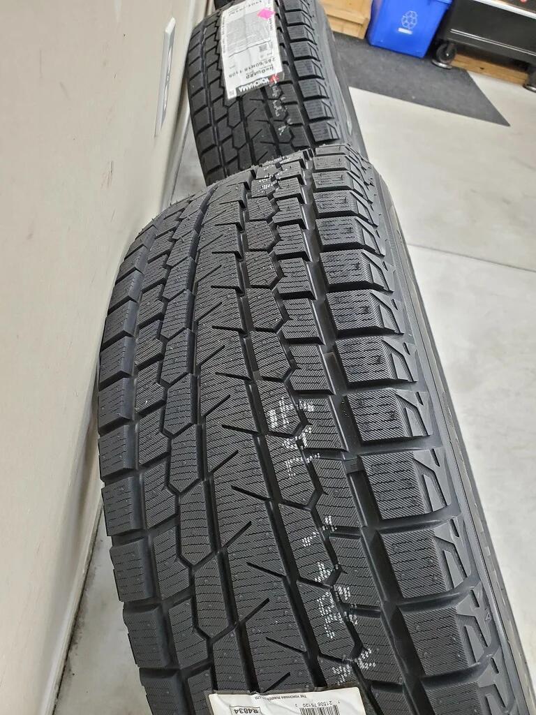

I would go with the ice guards…
https://www.jeepgarage.org/threads/yokohama-iceguard-g075.225954/
Rivian R1T R1S Efficient Winter Tires Compilation List - 275/60R20 IMG_0649

I found a few performance reviews, the Nokia R5 SUV seems to be near the top in ice. Here's one:
https://alltyretests.com/nokian-hakkapeliitta-r5-suv-test-review/
Seems like you can't go wrong with any of these top tires. Leaning towards the Nokia now.
