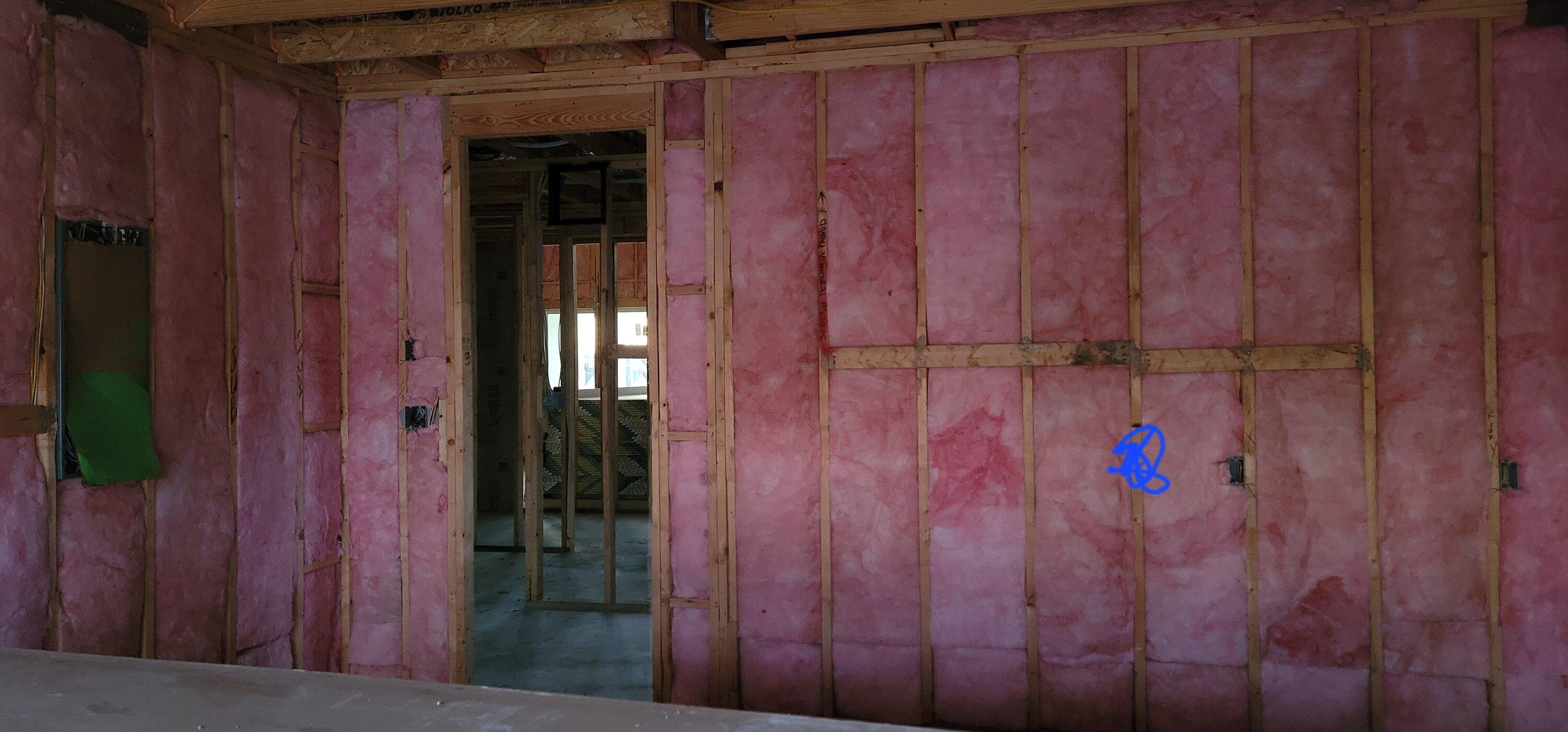

Rivian R1T R1S Electrical wiring for charger 20230427_201315
This is pre drywall. Main panel is on left of the door and I am planning to have Outlet around highlighted blue area so that I can park rivian on right and any future ev can be parked in reverse if needed. Hardly 35ft even from Main panel.
Do you guys advise to get subpanel intalled around the highlighted blue mark and get it taken care afterwards?

If the main panel is in the garage a few feet from where the wall connector will be I would probably have the electrician just run a 1 1/4” empty conduit to a junction box near your blue circle. Then the hard part is done and later basically just need to pull wire and add a breaker in the main panel. This way your costs should be maybe $150-$200 for
Conduit and a junction box.

Ugh! Too bad the builder is behind in asking you about the EV wiring, electricians do not like having to deal with insulation and I don’t blame them.
No, I would not recommend a sub panel, no need.
Running conduit is possible, using 6 gauge THHN wire, but I’m going to stick with my 6/2 MC cable recommendation. Cheaper, easier and quicker. Do NOT let him use 6/2 Romex, or else you’ll be stuck with 50A max, rather than 60A. Explicitly state that.

Do you plan to live here long? If so, I would plan for the future when all of your vehicles are EVs. Even if you don't currently have any. Plan on 60A per parking space.
But looking at how much they plan to charge you (about 10x what it should be), I might just tell them not to bother and hire a more reasonably priced electrician after you move in. With the main panel in the garage, installing an EV charger should be quite easy even after the drywall goes in.
