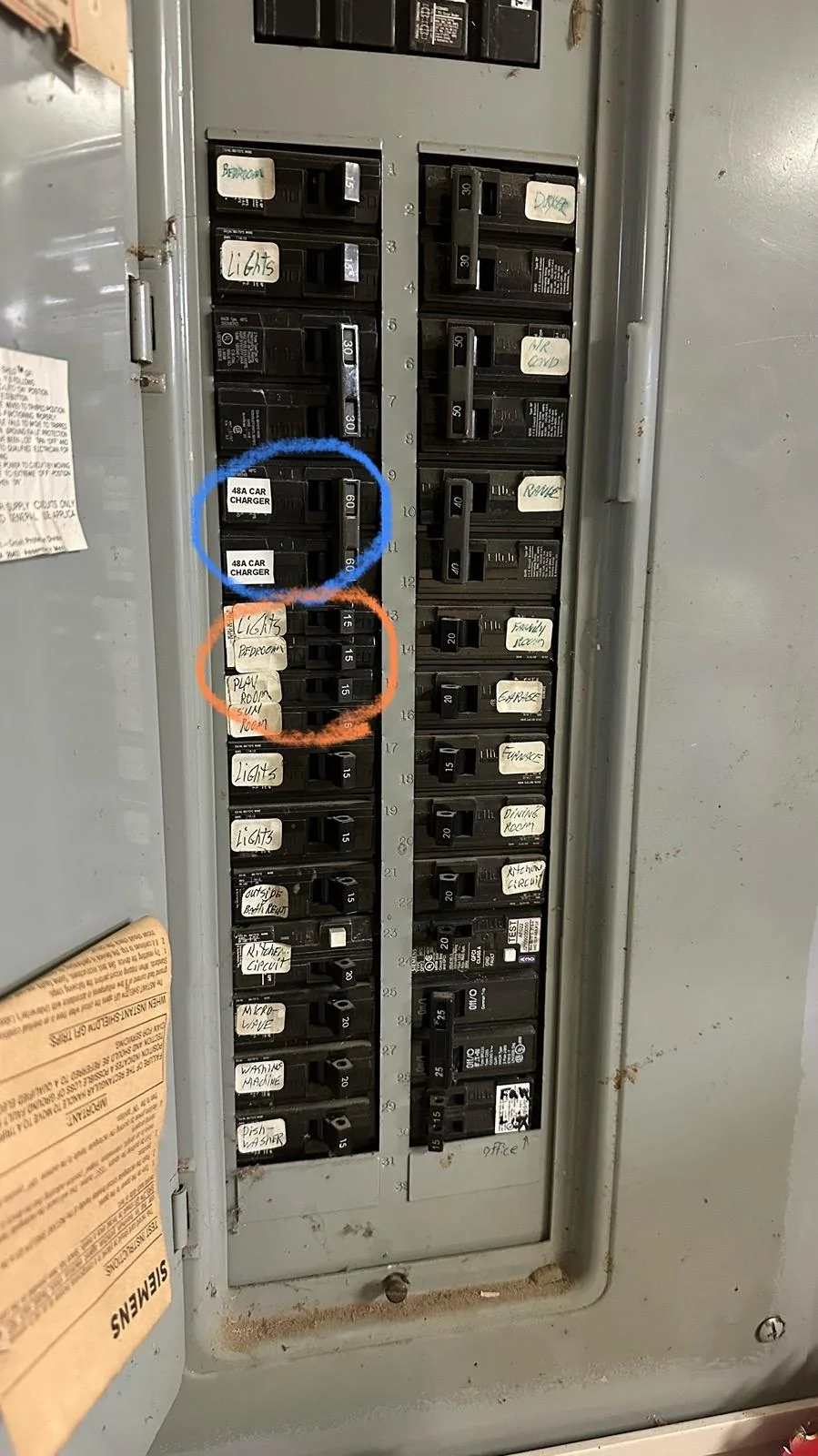

You’re getting a lot of good advice here. Just two points to add. Not all circuit panels allow tandem breakers. If it does allow a tandem breaker, it will say so on the wiring sheet in the door of the circuit panel.

Appreciate the point here. We have one tandem breaker now that was installed When we had a 240v whole-house surge protector installed last year (by the same company) so no worries there.

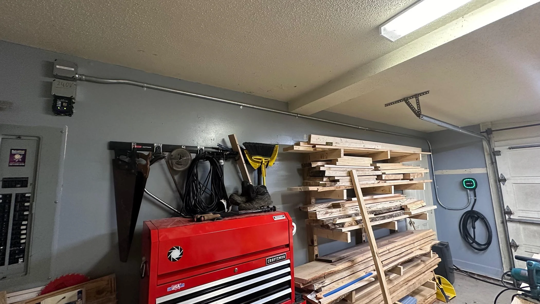

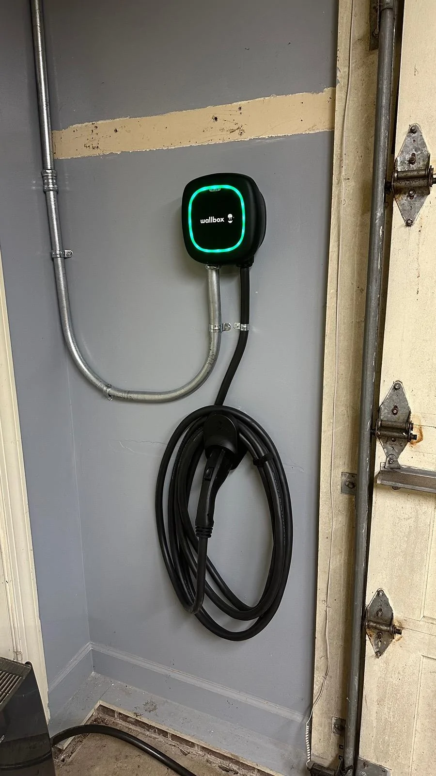

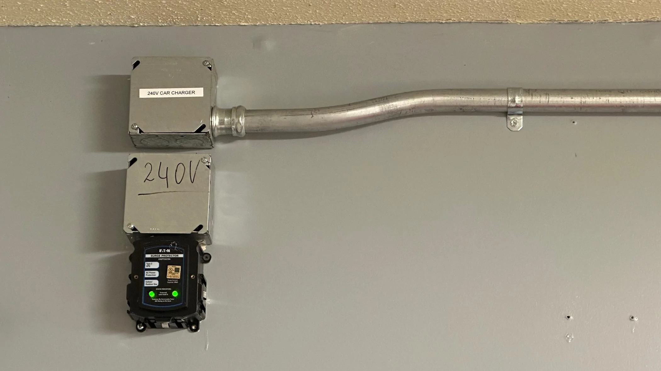

Install went well today. Heres the results. New breaker in blue, and the consolidated breakers in orange (4 into two).
I saw that the breakdown of the $2000 was roughly $1300 materials and $800 labor. Two guys here for 4.5 hours or so. Warranty for 5 years on parts (including charger), lifetime on workmanship.
