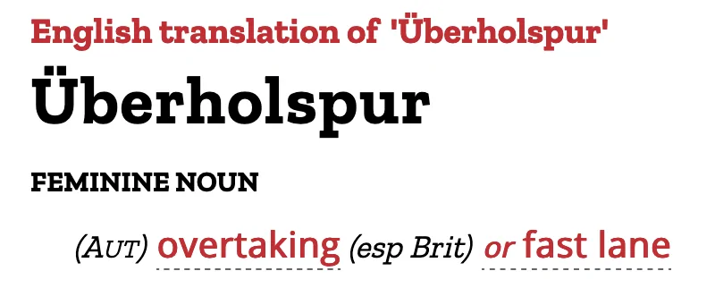

Aside, I have to unfortunately tell you that the left lane of the German Autobahn, called the “Überholspur”, quite literally translates to “passing lane”. There is no fast lane on the autobahn. Just a passing lane where people pass fast. Semantics at this point.
https://www.collinsdictionary.com/us/dictionary/german-english/uberholspur
